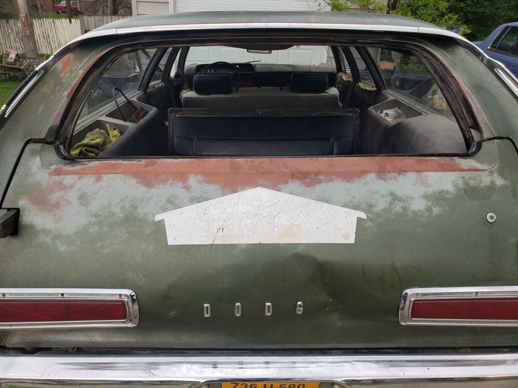

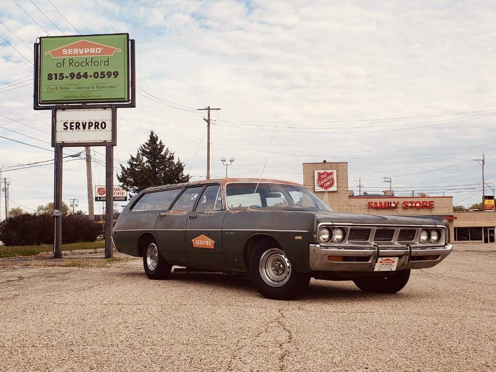

    Love the photo. How about the following for a period look?
    • Like Like x 9
    • Thanks! Thanks! x 1

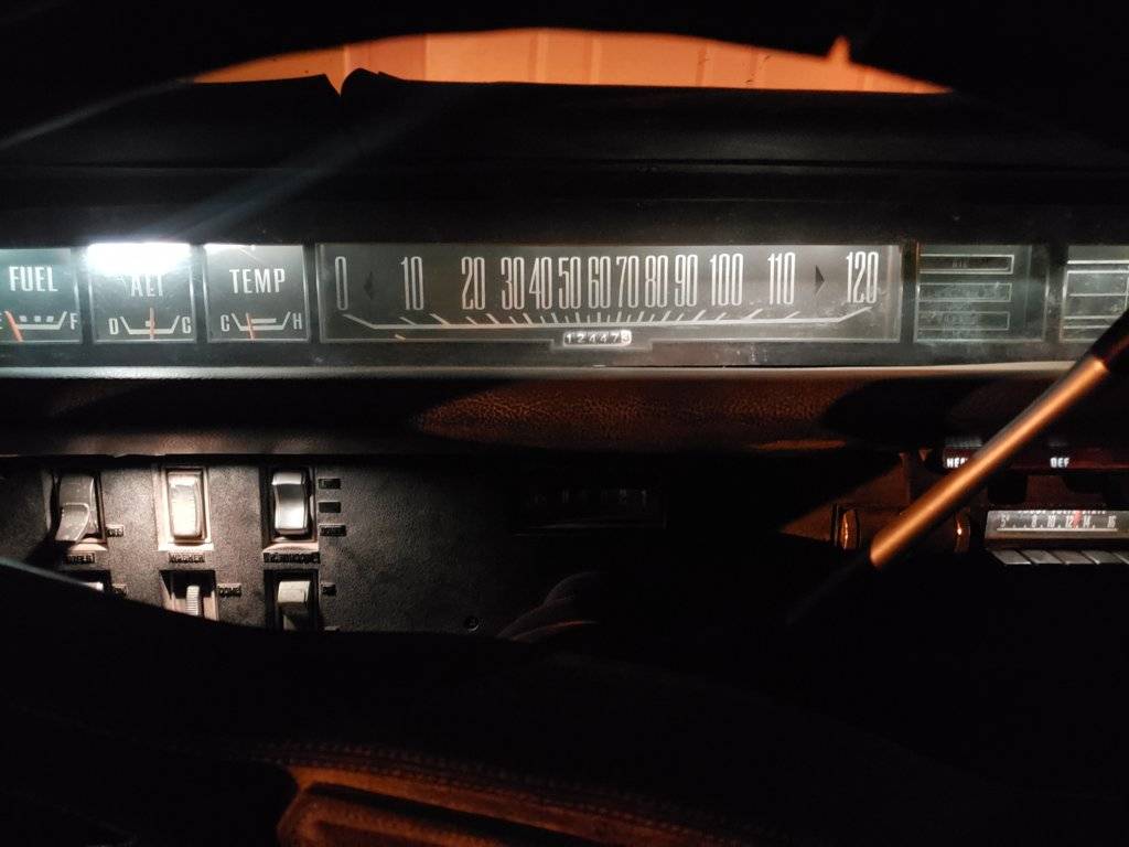

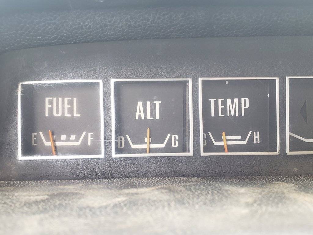

    Swapped the cluster from the donor wagon in and...I have gauges! The fuel gauge was a nice bonus considering I was really wanting the temp gauge. However the speedo needle bounces around like crazy and it'll have to be pulled back out and cleaned up. Been driving it around town quite a bit and even got it on I-39 for about 10 miles. Just cruised right along at 75 mph!

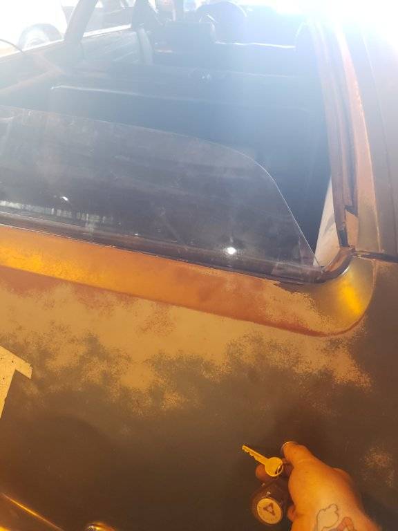

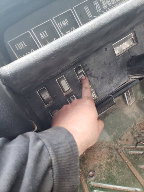

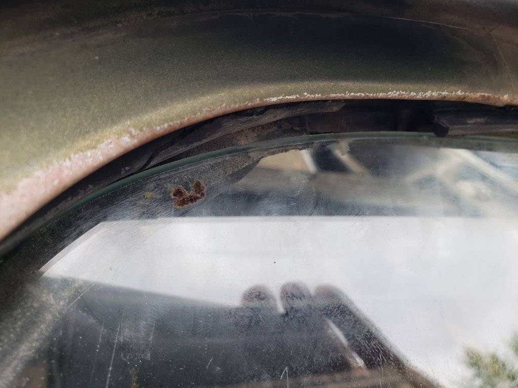

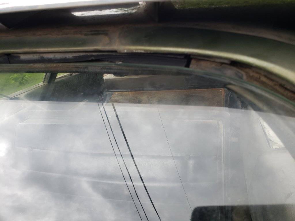

    I got the window motor and regulator back in and attached to the glass. It works from the dash but not the key which is kind of a disappointment. But it works! Also got the latches greased up and dual action tailgate working correctly.
    The rear window doesnt seem to roll all the way up but I imagine that's from the seal being destroyed.

    Those dual action tail gates are pretty complex especially in the latching area. Very minor adjustments make a big difference in how everything works. Great to see the glass working again.

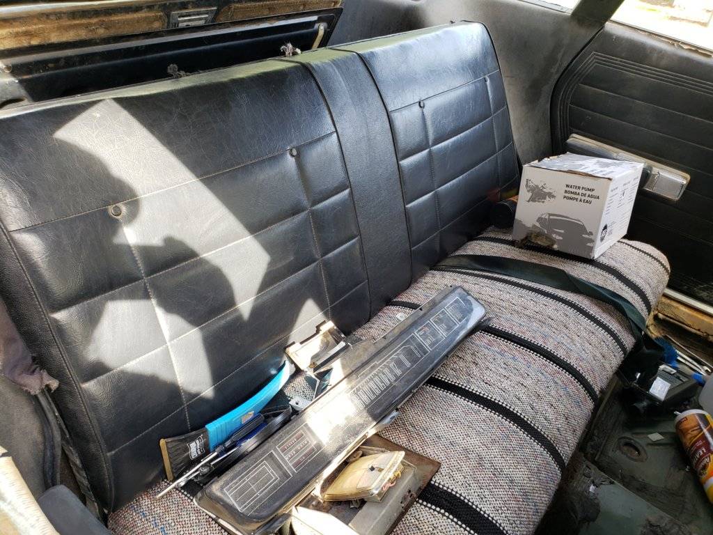

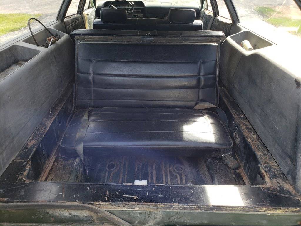

    Spent some time on the wagon yesterday....
    Round 2 of interior cleaning and it's still a mess...but its better.
    Also started to clean up the paint a little. I think it should look good with some more elbow grease.
    Everytime I tried to leave the shop last night it would start dumping rain so...I just kept tinkering I did the following...
    Repack front wheel bearings
    Adjust drums
    Fuel filter
    Distributor cap
    MSD coil
    Changed driver remote mirror
    Changed the flasher
    Changed a tail light
    Bypassed the heater core (shes a leaker)
    Painted the interior panel for tail gate.
    Also I got the dash lights to work better...well actually I didnt do much of anything besides hit a pothole and half of the cluster lit up very bright...so I smacked the top of the dash and the rest promptly lit up! Fixed.

    Geeze that wagon is solid, 3rd row footwell is exceptional...you're very fortunate! The next rainy day that I'm off work I'd like to swing by, check it out, and pick up that big block radiator.

    I really like the gauges!!!

    I'm back to just half.:lol:

    Well I just diagnosed that you have some grounds deep in the dash frame to find, clean and tighten... do I get half the diag labor?:lol:

    They came back :lol:
    The dash will be coming back out at some point this summer to swap in a better pad @LocuMob picked up for me. That's when I'll make it all better.

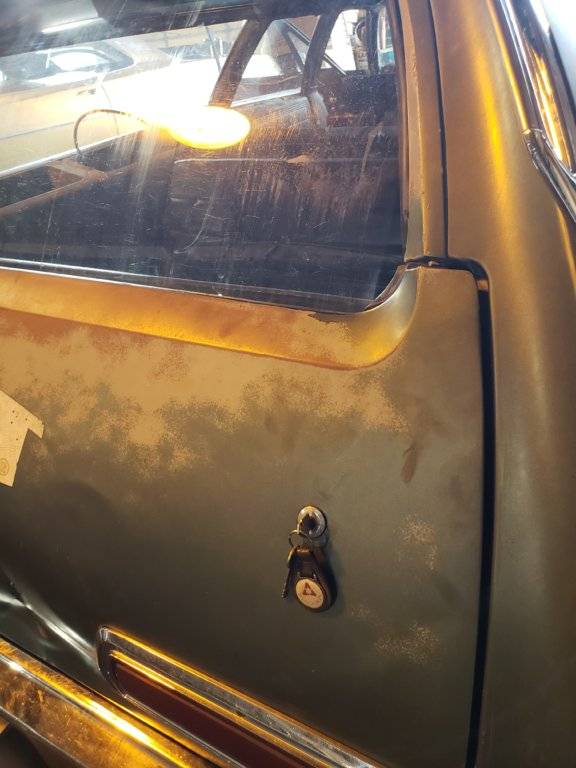

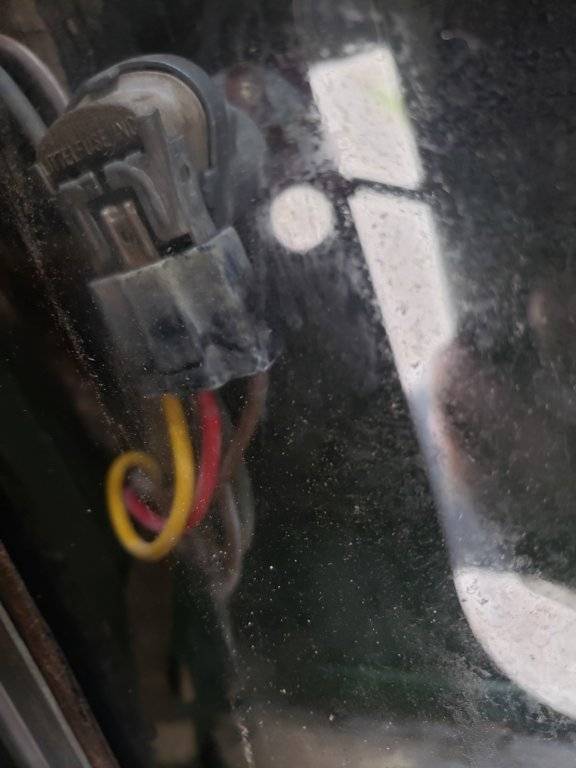

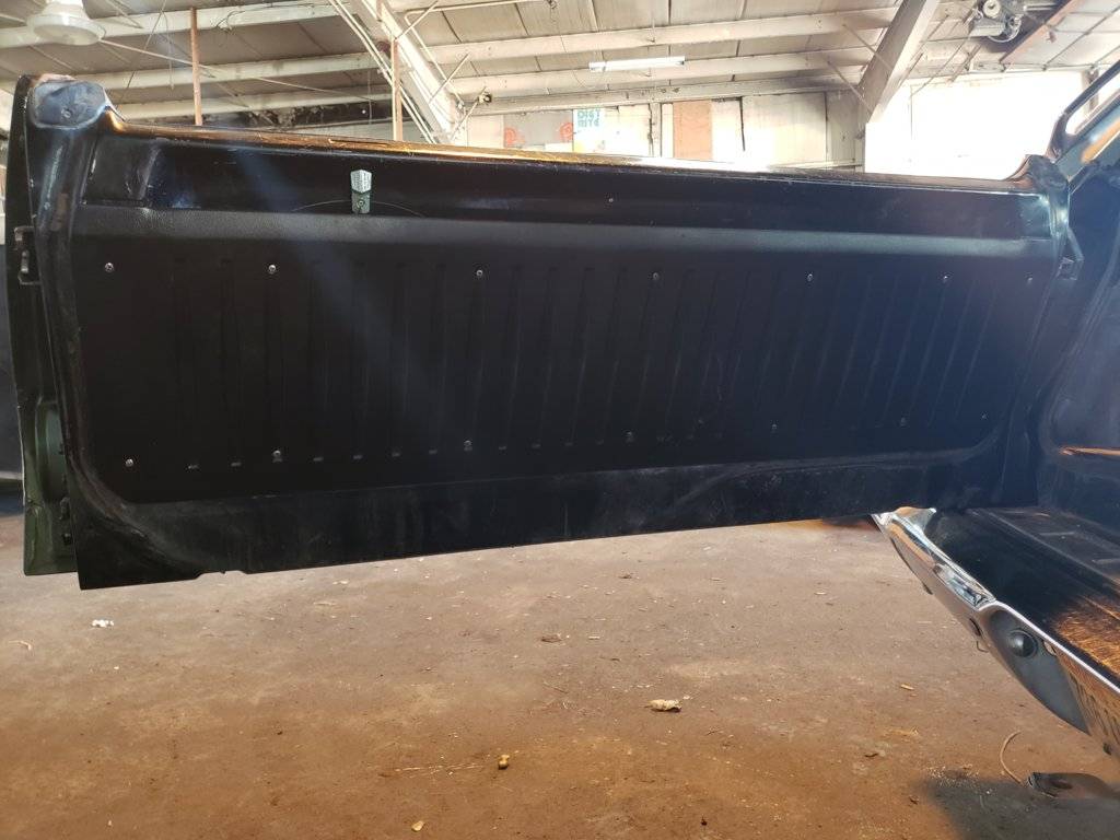

    Fixed the lock cylinder window switch! The hot lead was corroded in the pig tail so a couple pieces of heat shrink and some slide connectors and its functioning! I knew I didnt need the NOS switch...always be a good spare!
    Now that the inside of the tailgate is done I was able to close up the rear panel for good!

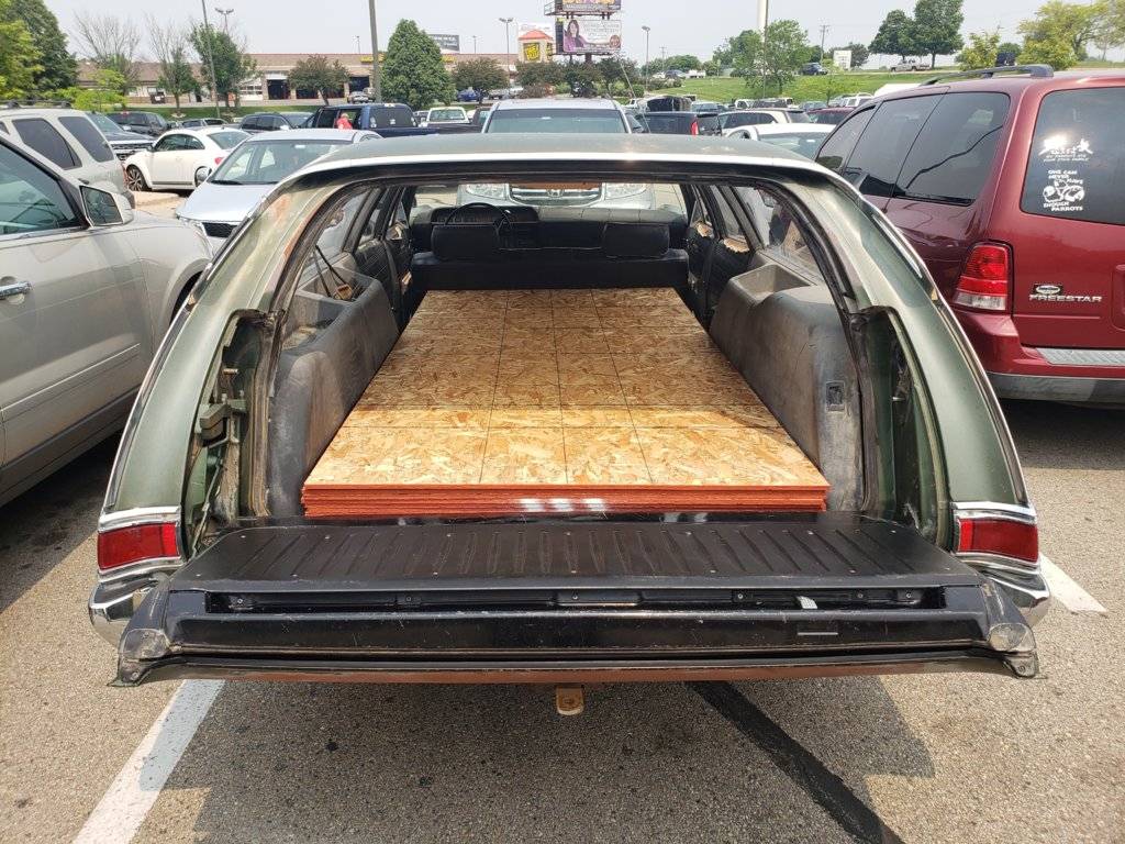

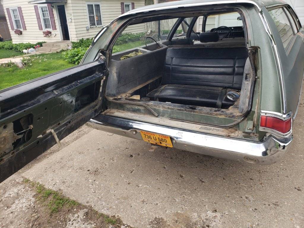

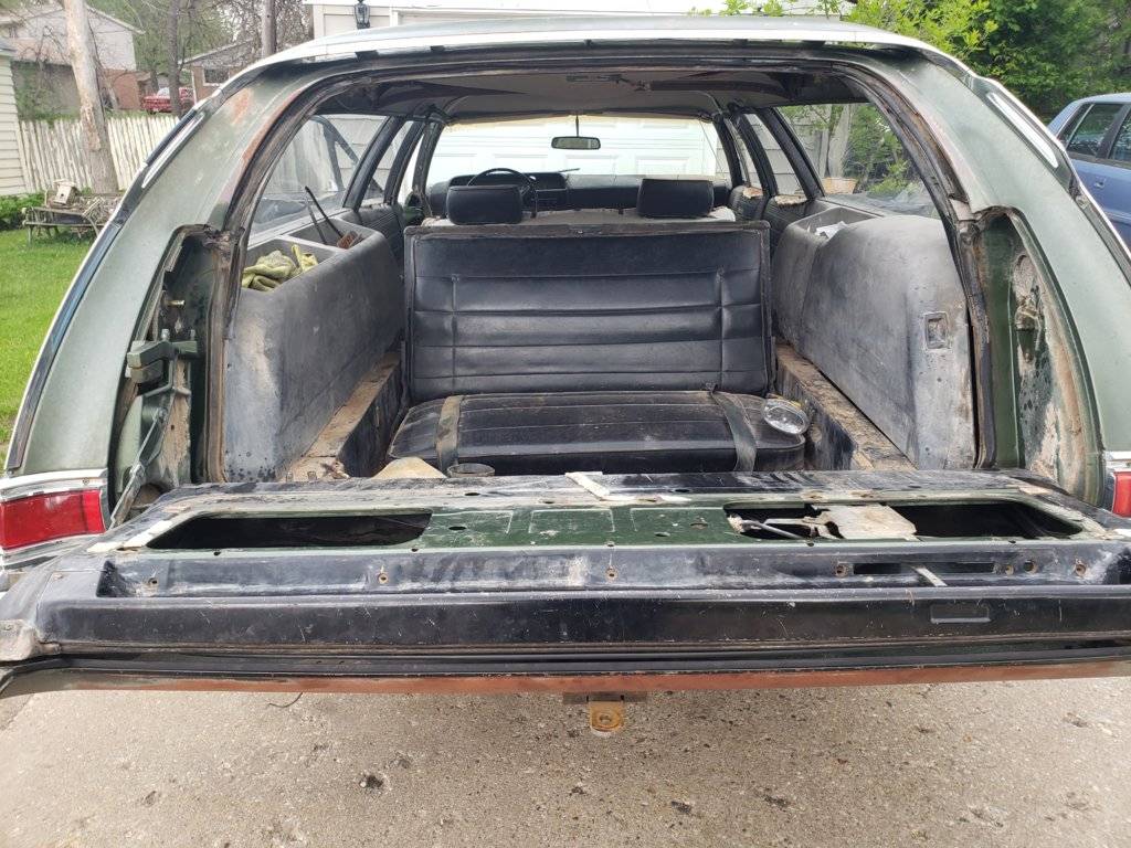

    Who needs a ram?

    You ought to be ashamed of yourself. That there is why none exist .

    No. Derbies and rust is the reason.
