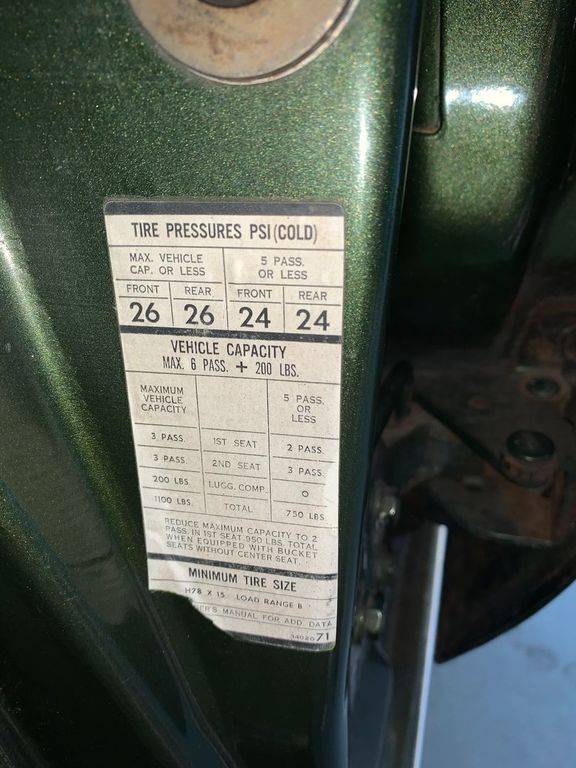

I hate to bug you, but do you think you could take a nice clear straight on photo of the tire pressure sticker in the door pillar?
When my 73 was repainted last they painted over it.
Thank you.
