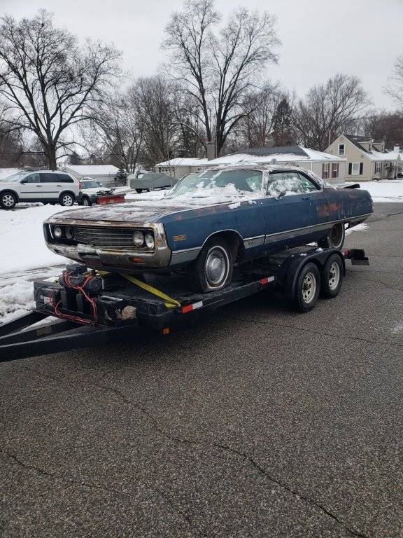

I read the thread about Tux’s problem and it sure sounds like a booster problem, as does this ‘69 Fury. I’d try another booster (I know that sounds easier than it is) Also, are you sure that the primary and secondary shoes aren’t swapped, in the rear? I love the color combo on Tux! One last solution would be to just sell me Tux…
