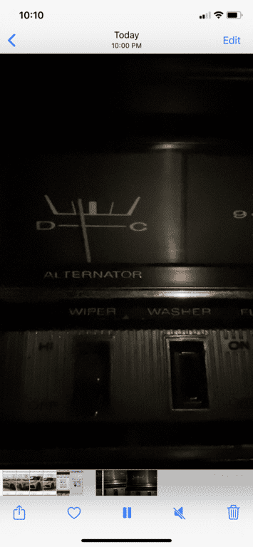

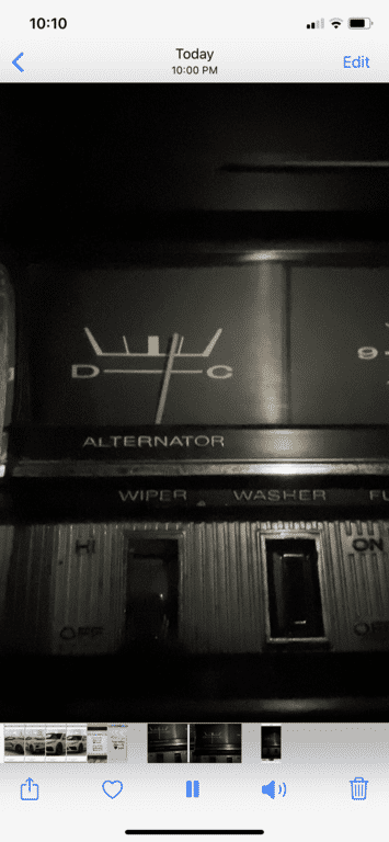

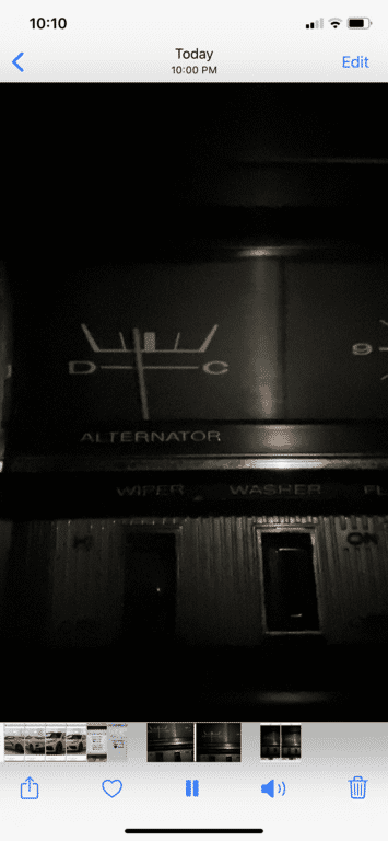

Is this a voltage regulator problem?
These pics in sequence.
Elapse time 3 seconds.
The drop is under acceleration.
The jump is letting off and the light come up brighter.
Thoughts?

Electronic regulator. Those are done by a member here? I believe it is Bill.
Thanks for the help! Will let you know.
@FURYGT is your guy.
The electronic regulator is a very good mod, and I do recommend it, but that's probably not your problem. My bet is on a slipping belt.
As always, try to figure out the problem with the existing bits and pieces in place before adding new parts or mods to the mix. I would take a voltage reading at the battery and while trying to duplicate the problem. Check for loose or corroded battery cables at both the battery, block, and starter, and make sure the wires to the alternator and regulator are tight.
