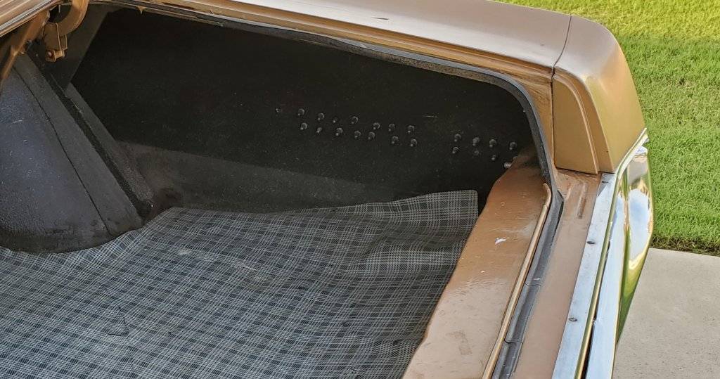

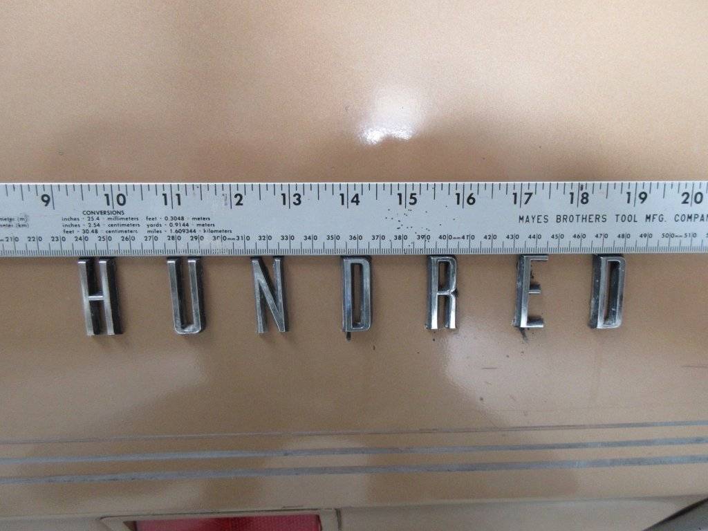

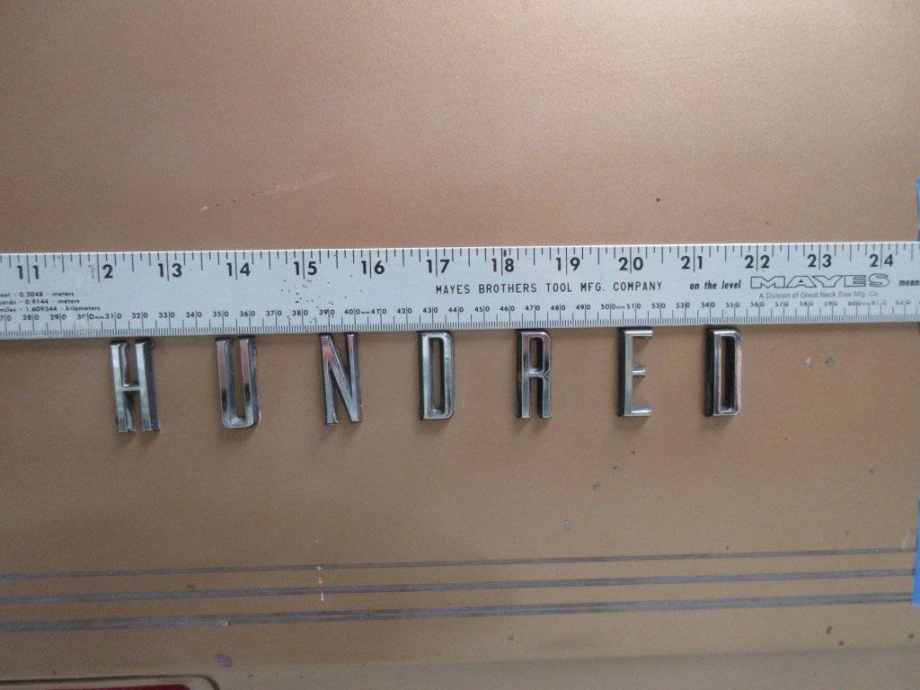

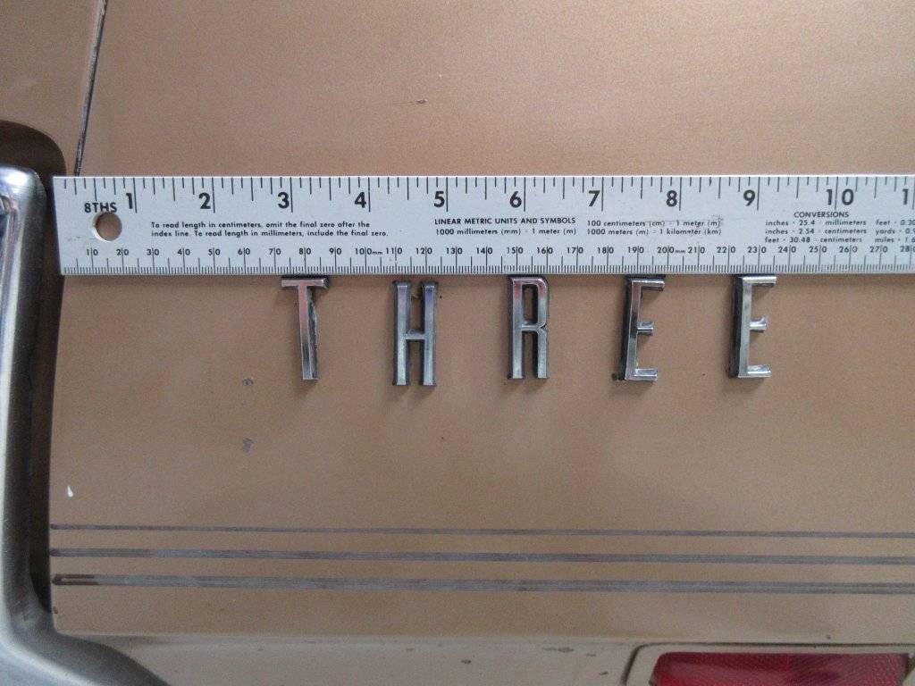

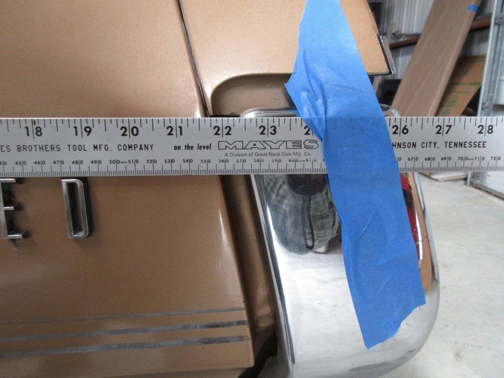

Shouldn't there already be holes in the quarter panel? I can take some measurements and photos tomorrow.

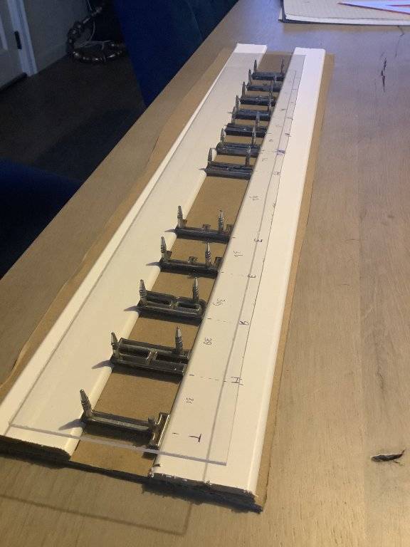

Off course you may! Thanks for your idea. I was thinking of laying the letters upside down in the correct distances and straight. Then lay a piece of see through plexiglass on the letter (pins). And mark the exact point of the pins. Drill those through, and test fit the letters on this template. If good, use the template on the quarterpanel. Temporarely taped to the car. That way I hope to be able to drill the holes in the panel and the drill will not wonder around…
Some kind of template..
Mark pins and then drill Plexiglass. Testfit. Later this week.

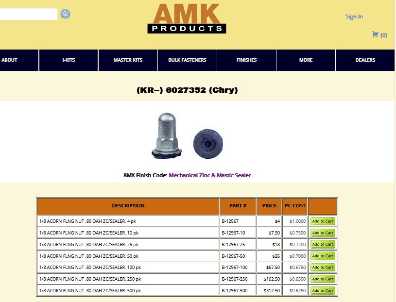

Btw. who sells the correct fasteners for these letters?

I thought you would come by to make a simple template from the holes in my car :).
