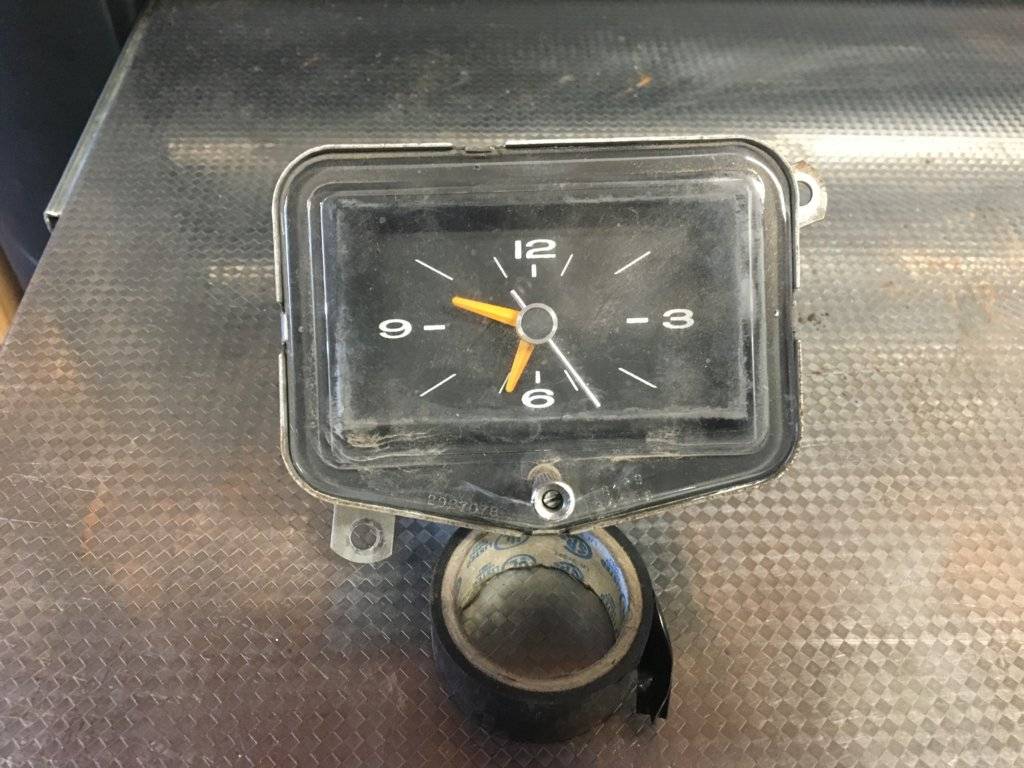

That's ok, I just want the frames and faces so that I can play with upgrading the guts to something that works.
I happen to have one removed all ready

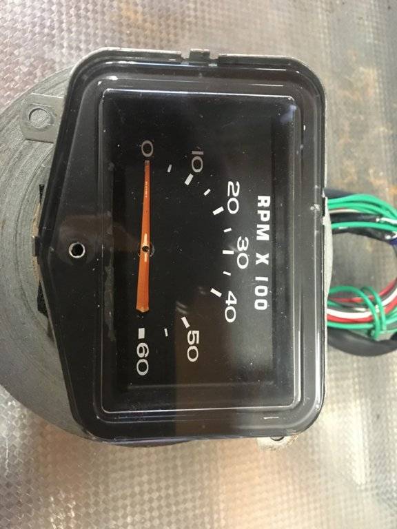

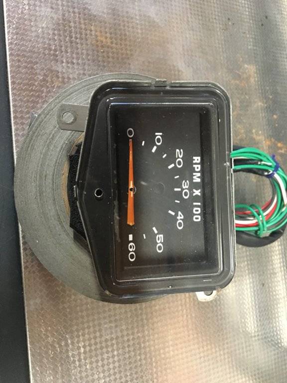

I’m in process of making a dash tach I used a clock face , I made a tach decal , Centered and mounted the tach to the back and now I’m searching for a look alike needle. It all takes time

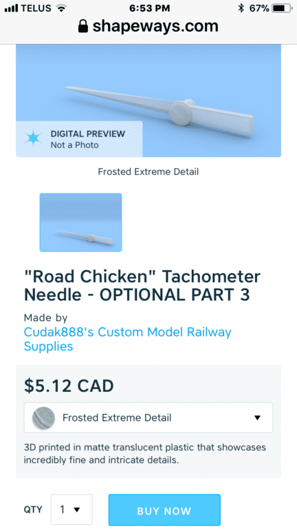

I found a guy that 3D prints the needle so all I have to do is paint it and chrome the centre button and I have stuff for that
I absolutely refuse to pay $1000 US for a tach that I can build for under 50 bucks Canadian. It may not be NOS but so far I’m happy with the way it’s turning out

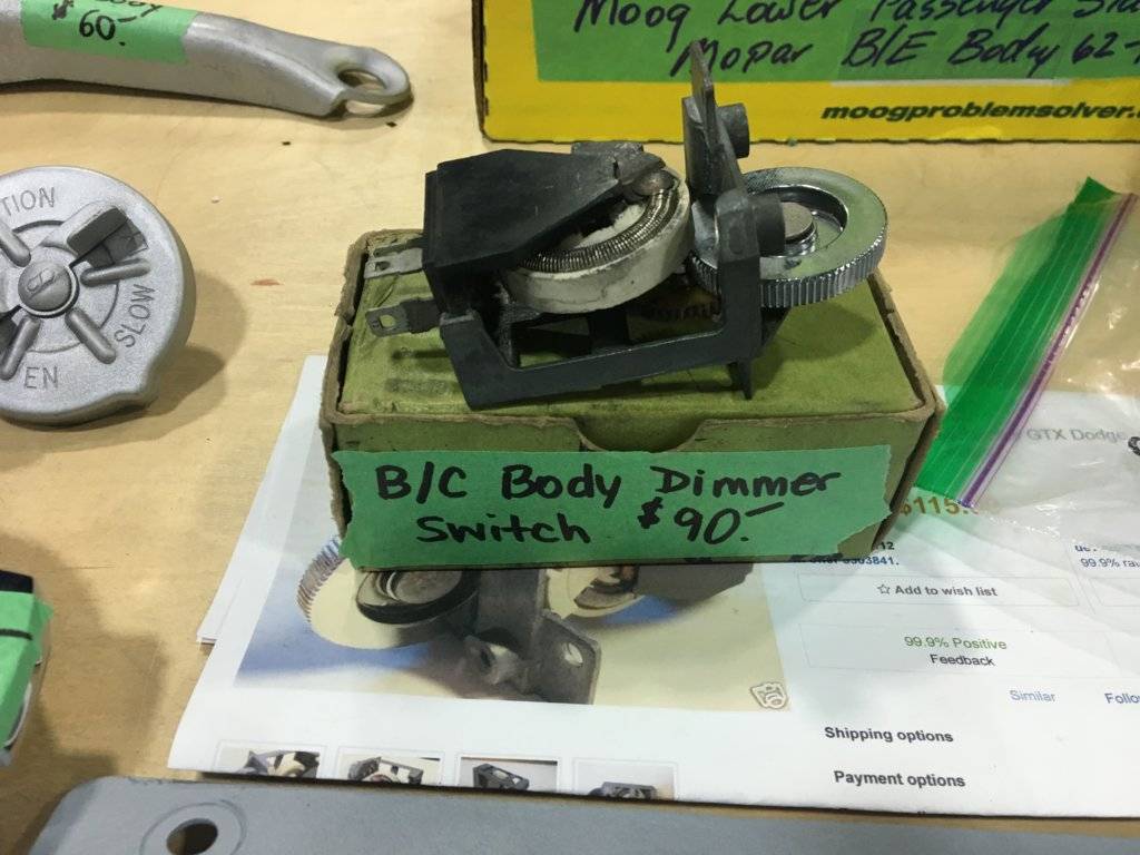

Look at what there asking for a switch at the Red deer swap meet today. That’s nuts
How did you do that ?
I took some very close pictures of the tach , then I took the clock to a friend of mine that professionally makes decals for Automobiles , pinstripes and such . Then he scanned it to his Computer that runs his decal maker and bingo out comes the decal , it fit perfectly. Now he can make as many as I want.

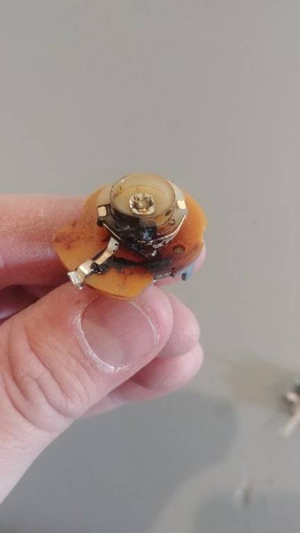

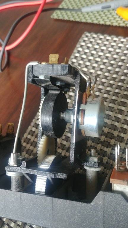

My thumb wheel dimmer looks different than all the ones you guys posted. Maybe this one is a reproduction? Either way, I have no resistance between any of the pins in any way. I'm guessing the rheostat is screwed!
looks like you can hit up your electronics parts/surplus store and get a replacement potentiometer and solder the new one on
That's going to be plan number 1, it's just a 25 ohm pot. Should hopefully be doable!
Marlow that is some cool **** you're doing with this tach! Really like!
It’s been a 24 month process so far I had Englot Auto Trim make the Tach graphics for me. It took a while to mount the tach about 1” lower than where the clock hands were. 24 months : 24 beer in a case coincidence I think not . LOL I work on it when I have time. My vinyl fix guy is fixing the small hole in the dash bezel where the clock knob was. He’s amazing at vinyl,plastic,upholstery work. I’ll take a few pictures when it’s all done.

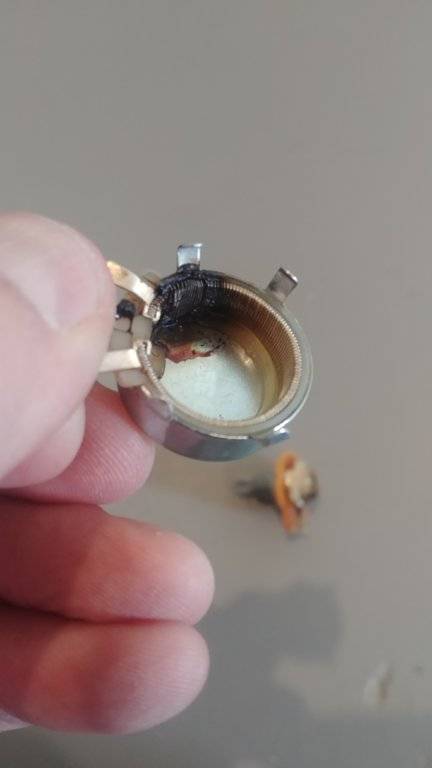

For anyone following along here's why the lights weren't working anymore! I have an electronics shop trying to source out a 25 ohm potentiometer like this one. Crossing my fingers.
