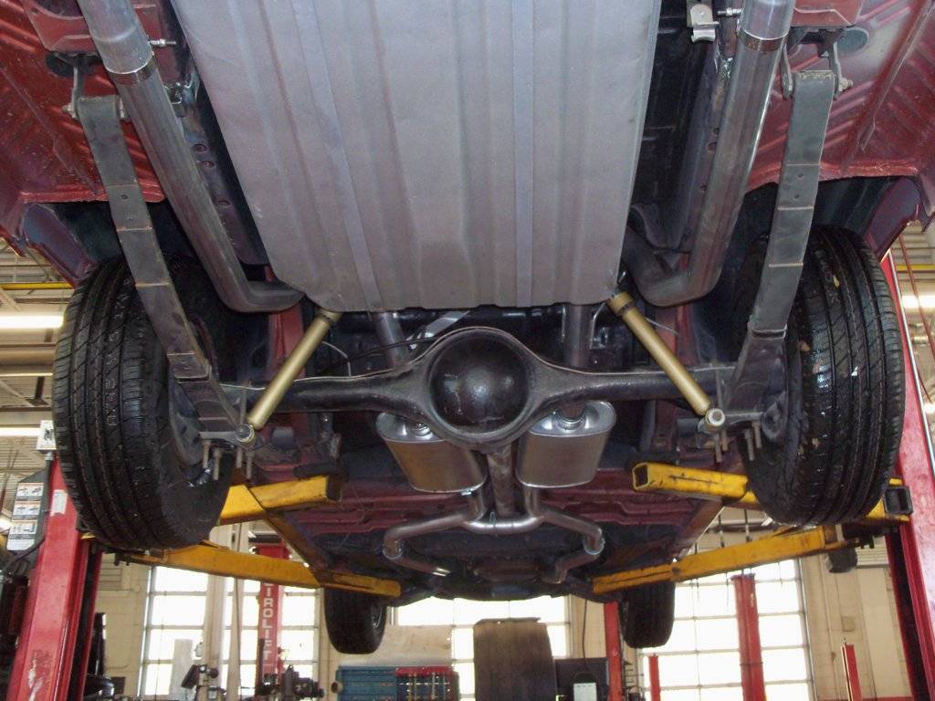

Its a garage queen and never sees bad weather or rain. Just wondered how it came stock from factory. She is nowhete near show perfect just looking to do the correct way.
Agree, get the new pad for good measure. As for originality, Chrysler never did paint the fuel tanks, BUT on some years, the tanks did get a coat of undercoat on them, by observation.

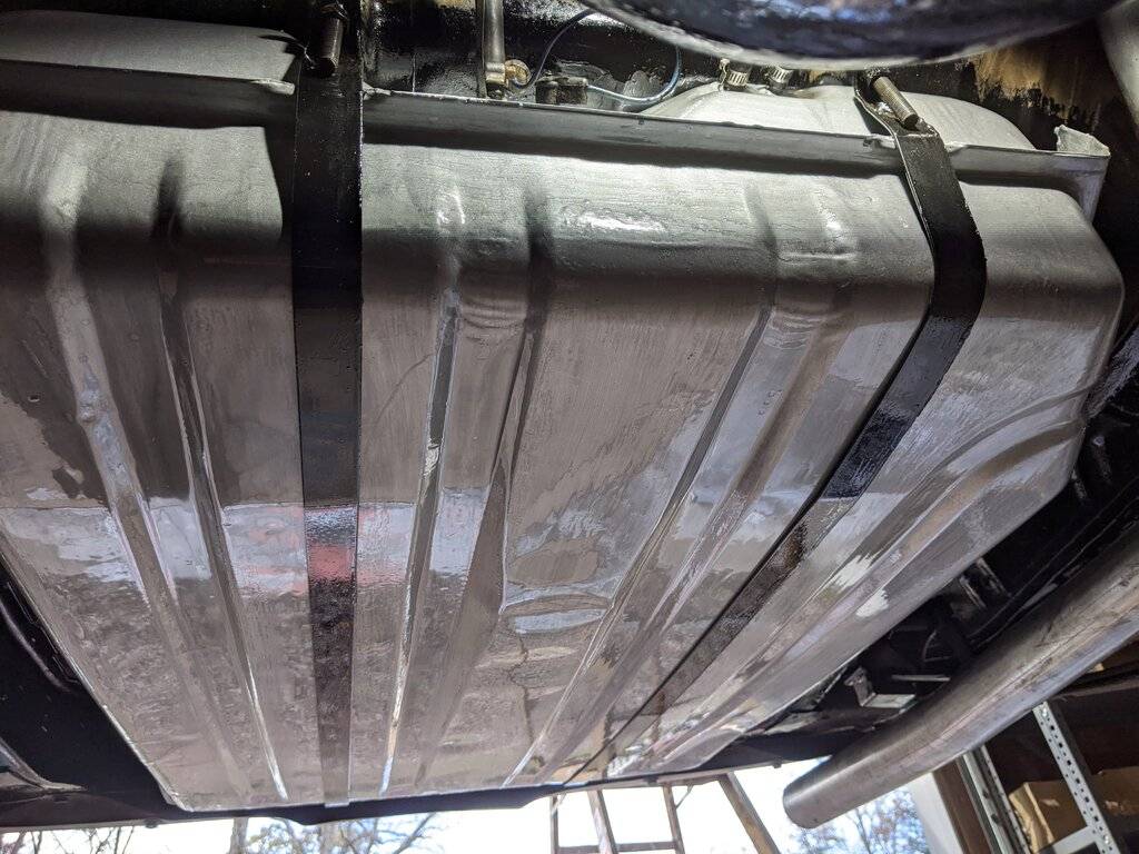

But I did paint mine...

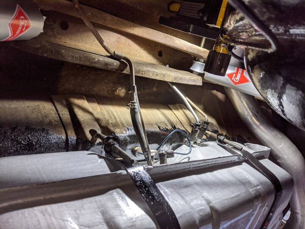

I painted my new tank with some stainless paint. Pretty much looks like the galvanized coating.
That's similar to what I did on my 65 Belvedere wagon. The only issue was I had to ground the sending unit to get it to work.
The steel ground strap extends from the sending unit fuel exit port to the fuel line at the body. Paint on the tank shouldn't affect ground. See Below. In the past, when the strap rusted beyond use, I used a wire and an aircraft clamp at the same location on the sending unit, then ran the wire into the trunk thru the sending unit's trunk grommet and grounded with a ring connector in the trunk.
Ah yes. When I replaced the fuel lines also my ground strap was rotted away. I attached a ground wire from the tank to a bolt on the tank shield.

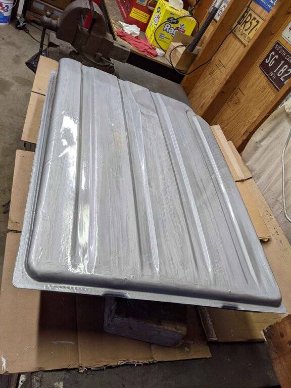

For me to keep the original work on a new tank I would paint it with matte clear with hardener in it. Also paint the straps and Hardware with matte silver. Should give it a more original OEM look.
