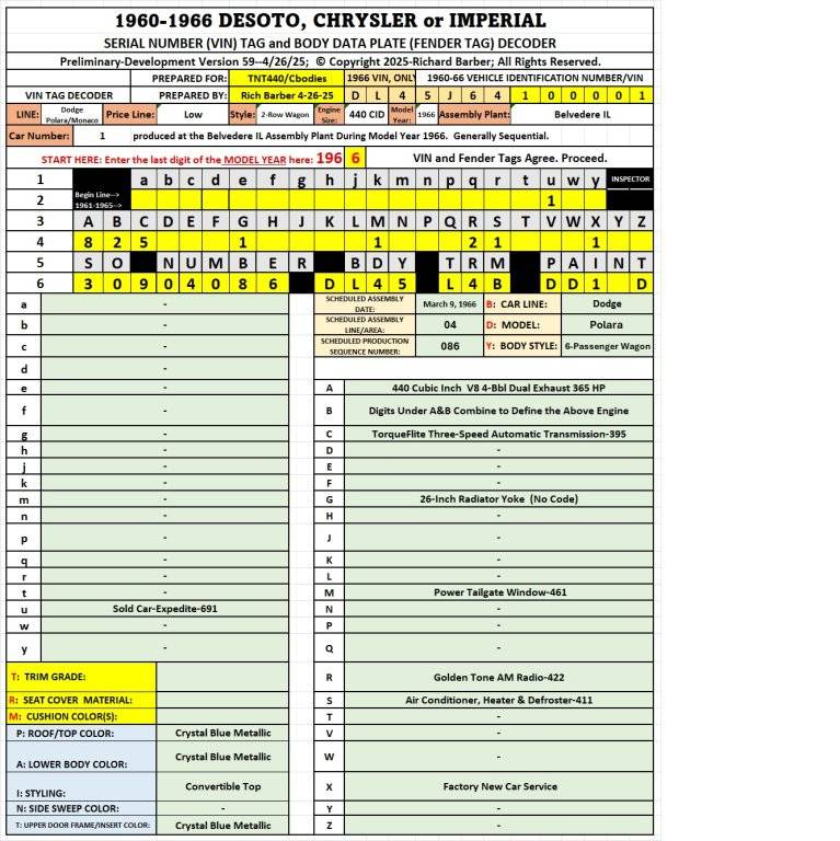

Did the Body Data Plate ever get posted & decoded?

I hope you and the big wagon are still around. It would be very helpful for the development and testing of my decoder for me to have a picture of the car's fender tag/body data plate. VIN would help, also--but not critical. Should look something like that attached. Your car has more stuff on it and should be interesting.

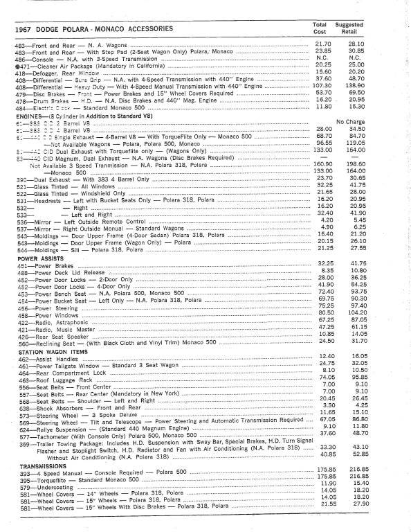

Here is the 1967 Dodge Polara/Monaco Option Sheet 2nd page. Trailer tow package (and included equipment) is listed near the bottom of the page.
