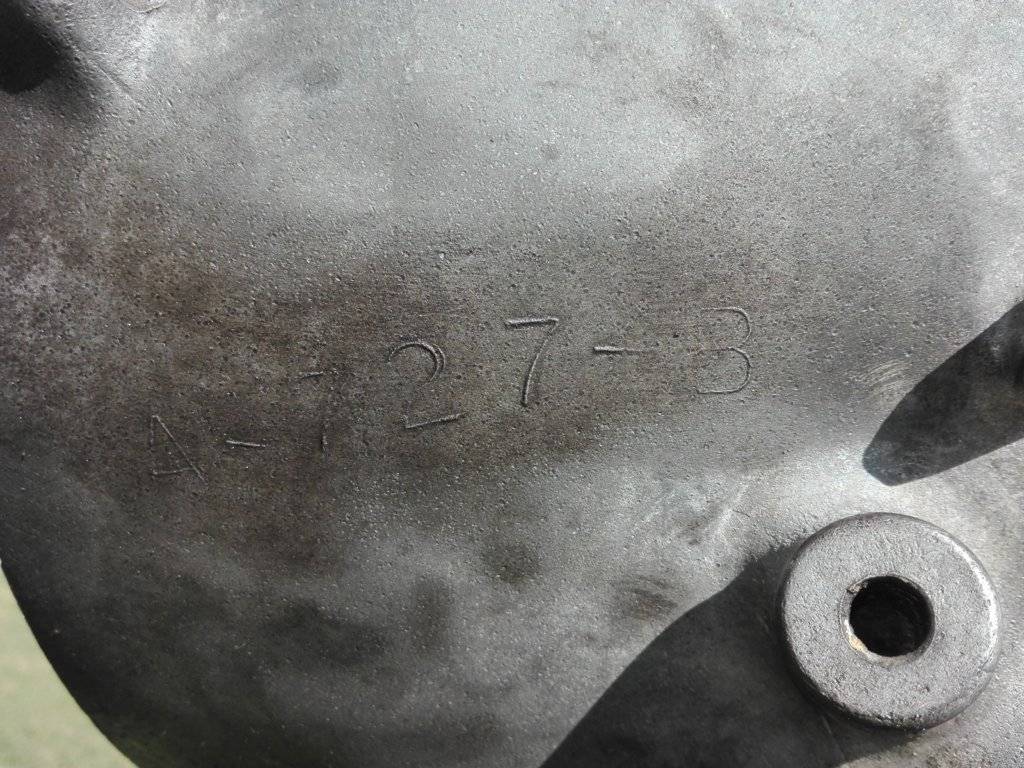

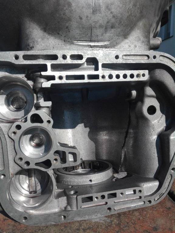

Hi.
I'm looking for a transmission cover for my 70 Chrysler with a 383 big block. Only around Los Angeles, CA.
Thanks
I'm just guessing from your picture, but do you mean you need the oil pan? If so, any 727 pan will work.
I'm too far from there to help you but it should be very easy to find.
You will most likely have to obtain an intact 727 core if you just want the case.
Maybe Steve has one? He's just east of LA.....
@saforwardlook

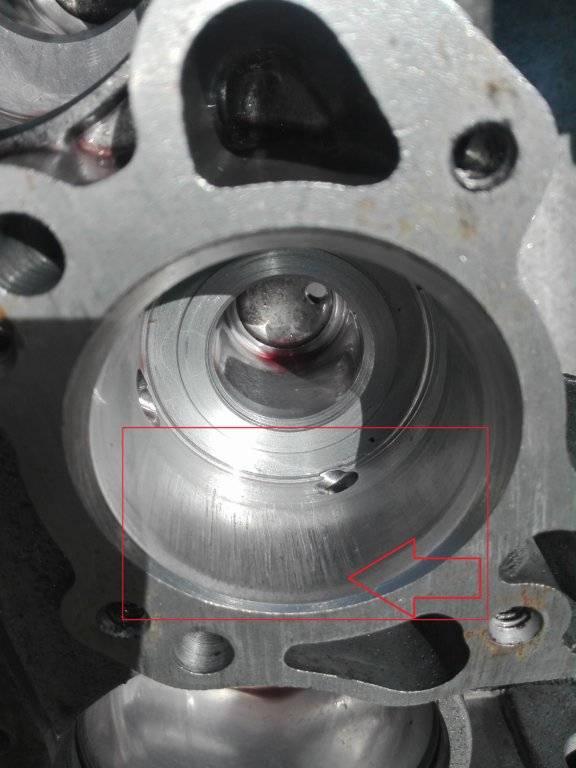

That's the accumulator it helps soften the shift. You block them or pull the spring and let it ride on the bottom will firm up you shift. I would just blend out the scratches with some very fine sandpaper and leave it. If it were to bleed by a tiny bit it would cause no harm.
I agree its still very much usable. But if it makes you feel better to replace, its your car and money.
Those "scratches" are not unusual to find on these transmission cases, but as Dave said, they really don't affect much even if the seal rings leak slightly. I would just go ahead and reuse it and save yourself a lot of hassle and expense. Most 727 transmissions I have rebuilt have some scratches in that area with no effect - I just use some crocus cloth and smooth them out and move on. And I am usually very fussy about doing things right, but this issue is not a significant one IMO. Dress the scratches up a little and move forward................ this is not like a cylinder bore in an engine where such stuff would need to be addressed.
