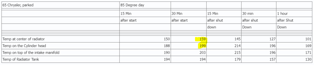

So yesterday, I went to Harbor Freight and got my IR Laser thermometer. Boy, do I like this thing. My wife said if she knew this would have entertained me for so long, she would have bought it for me a long time ago. Below are some of my recordings. My two "goto" guys told me that I have nothing to worry about, but I have been in parades with my 1963 Studebaker Avanti and have seen too many guys pulling out to have their cars cool down. One of the guys told me that his 65 GTO and Buick Grand National have factory ATM coolers in them.
I don't want to be sitting in line at Carlisle and embarrass the old Mopar. So, will the ATM Oil cooler help?

Your numbers look good to me depending on what thermostat you have.
If you want it to run cooler try putting a lower temp thermostat in it. If you put a lower one in it and your numbers go down then you know nothing is wrong with your cooling system.

Those temps look good. I wouldn't fret over it.
Putting a lower temperature thermostat in won't cause the engine to run at a lower temperature, it will slow the warm up process down. Going by your temperature at the intake (only cause it is closest to the thermostat) if the car likes to run at 203° the thermostat will affect the time it takes get to 203 degrees. A 180 would take slightly longer than a 195 to reach 203 degrees simply because it opens sooner and will drop the engine temp momentarily after it opens the first time.

I agree with all of this - except the intake temperature vs closest to the T-stat. it's a bigblock, so has a dry/airgap intake and temperature data from it is relevant only for exhaust crossover and thermal choke diagnosis.
If a car is overheating, diagnose/correct the cooling system, don't add a band-aid of a trans cooler (as others have said).
Of the given temperatures/locations, the highlighted temps are the only ones that matter. Doesn't matter what the temps are after shutdown.
Temperature of water housing where lower radiator hose connects would be more useful.
Also important - what are these temps when driving - does the car get hot at highway speed, when stopped in traffic? Are these temps at idle/park? If so, those temperatures are lower than what would occur in a driving/traffic situation.
