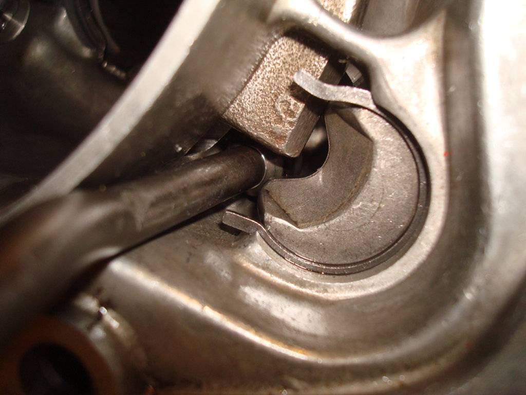

I installed a A&A 6200 RPM governor in my 727 in the car and am having a bear of a time getting the parking rod back in correctly. Anyone have a trick for lining it up as you slide the tailshaft back on?

Rotate the output shaft slightly and try again.
The snap ring will sometimes get hung up trying to go back over the bearing. Sometimes you have to expand on the way back on.

I'm going from half assed memory of changing my BIL governor.

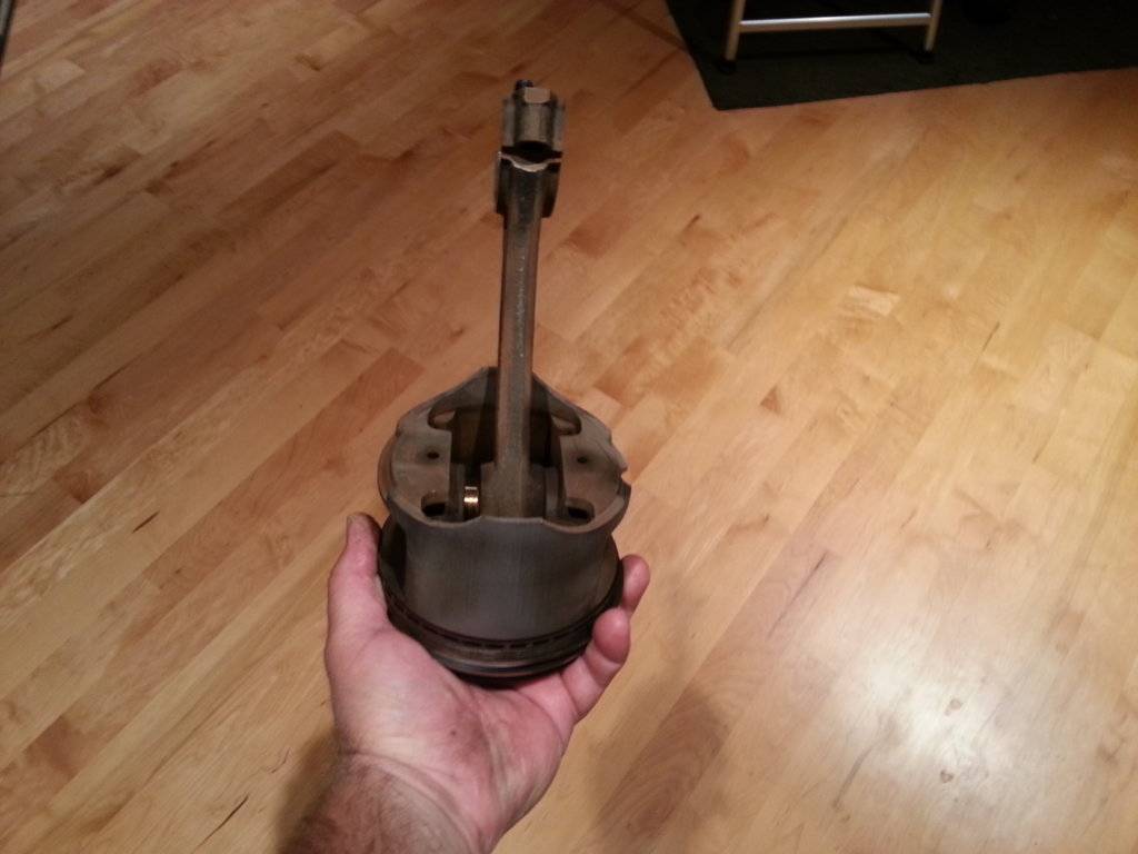

That doesn't look good. What happened?
That is how the rod looked when i rebuilt the original motor, it ran perfect and never made a peep, and had great compression prior to the rebuild and stroker install.
