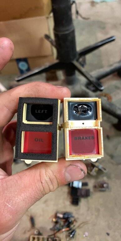

Not 100% sure if this is the right place for this question but I’m doing a lot of under the dash work on my 69 fury 3 and I would like to replace the plastic housings for the turn signal indicators and idiot lights. they’re red and green plastic with “left”, “right”, “oil”, and “brake” written on them and they sit in a white plastic housing behind the speedometer (I’ll get some pictures tomorrow). I haven’t been able to find any for sale and had a thought to use the same plastic they use on stage lights since it’s colored, transparent and made to withstand heat. A buddy of mine said they can also be run through a laser printer so I could put the words I need onto them then just cut out squares and glue them in. Has anyone done this before or should I just stick with finding NOS stuff?
