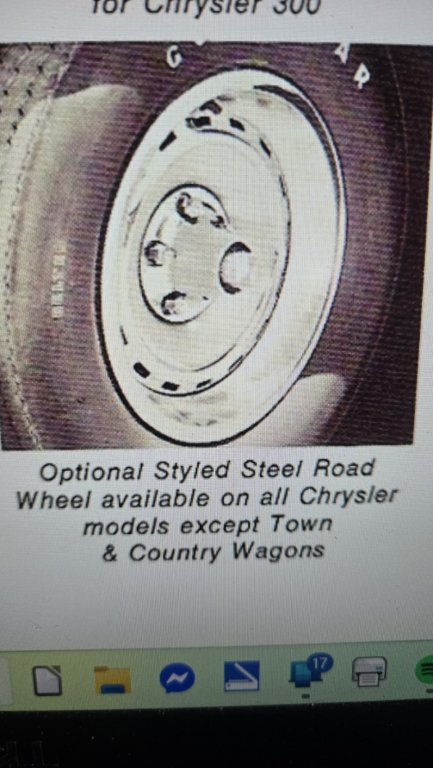

I'll just toss this out there. For 1965 Chryslers and upcoming 1966 Chryslers. Sorry... Best copy of this I've seen and I don't know much more about it.
This is probably the first time that "Magnum 500" style "chrome wheels" were offered on C-body Chryslers. "Magnum 500" was the model name for the then-new chrome spoke wheels sold by Motor Wheel Corporation. Chrysler termed it "Chrome", from what I found in the parts and sales books today. Usually in 14x5.5" wheel size, although 14x6.0" wheel size was allegedly C-body only.
