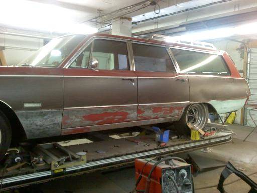

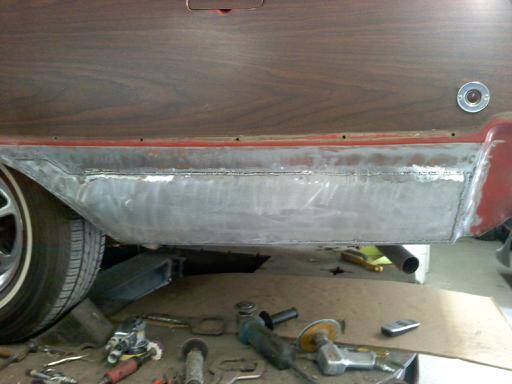

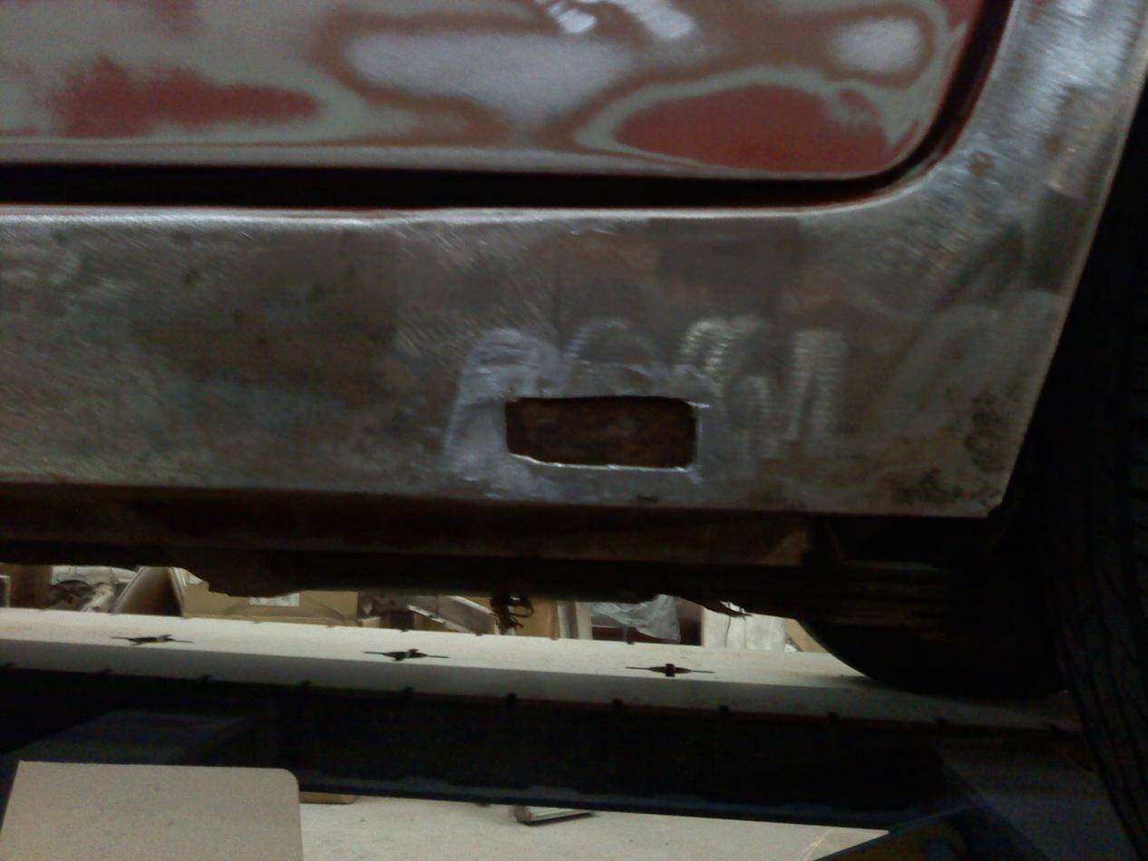

well the wagon got dropped off at the body shop two weeks ago for rust repair on the quarters and spare tire well. having bottom of both sides from woodgrain down repainted as well as the drivers fender which the paint was all blistered for some reason. drivers side is done and primed and almost ready for paint. car is looking great cant wait for it to be done.i got a lot of things to do on it. ill post pics once i figure out how can anyone help with that.
It couldnt be more easy then what is here........once you hit reply scroll down just below your reply box and you'll see manage attachments, click on that and take it from there. I figured it out so its built for dummies up.

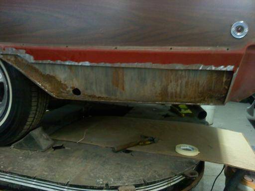

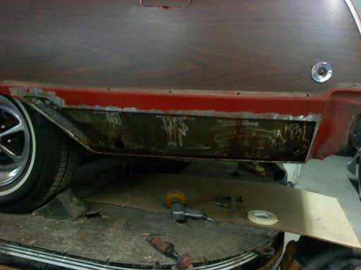

pics of the surgery going on on the 68 sport suburban. when finished there will be no more rust issues every visable spot is being cut out and new metal welded in . i paid a visit the other day drivers side is finished and ready for paint. work has started on pass side will have pics next week when i go back.

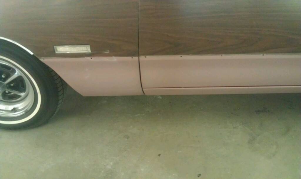

wagon under the knife

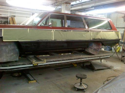

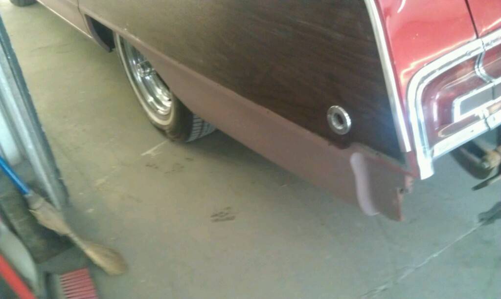

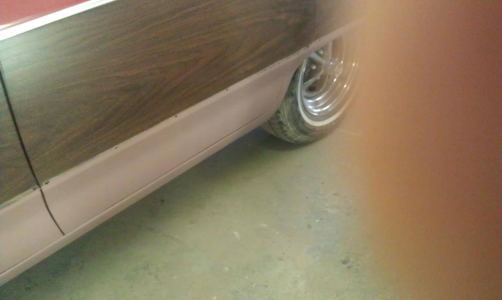

car is being painted from the woodgrain down on both sides and tailgate is being replaced with a rustfree one from south dakota.that i bought from Moores and had shipped to Pa. the one on the car appears to have been hit at some point and the body work was cracking and rusting on both sides and the bottom was rotted thru in 2 places from the optional rear window washer system not draining properly. car is a 383 with new edelbrok 4 barrel.

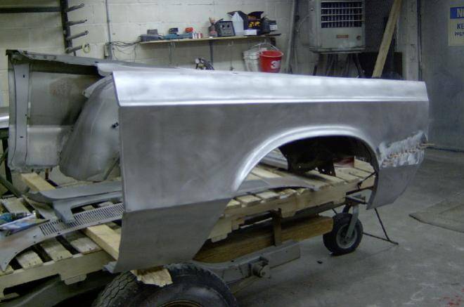

Bodywork on Slabs is a whole lot easier than the other generations.
Keyword: SLAB. As in flat; without compound curves...

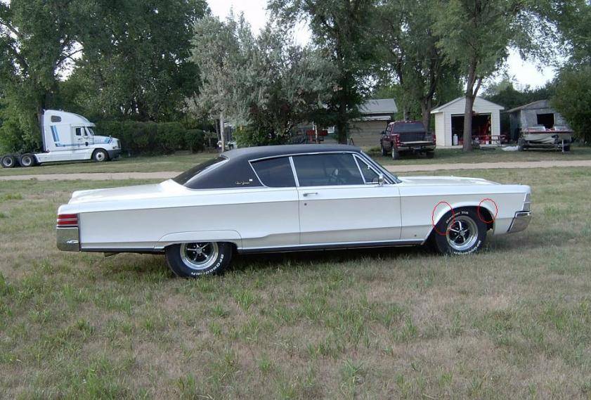

For most of the car, yes, but the areas that I marked on this '67. They are areas where a concave area meets a convex area on a curve.
They are the worst areas on any vehicle I have ever done, and I have done bodywork for a living for over 15 years. A couple bad strokes even just sanding primer in this area would show.
The concave areas actually kind of suck to block also, as the center of your block never touches the car.

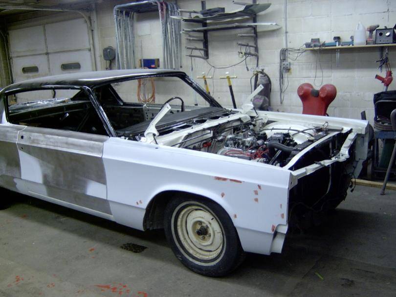

The front clip was pretty decent, until the guy that was supposed to sandblast the inner fender wells and the radiator support, did the inside of the fenders as well, and warped them... Yay...Thanks.
Anyone that is thinking of doing any sandblasting, be careful not to do any outer body panels, inside or out. The older cars were heavy guage, but not that heavy.

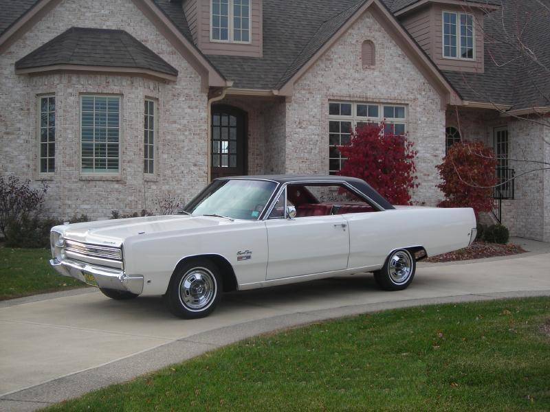

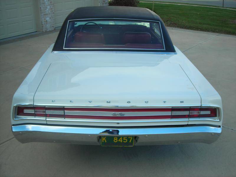

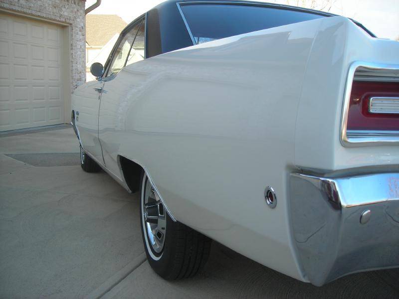

The '68 Fury and VIP body lines top and bottom, leading from the front, go straight back and pass by the body lines from the rear without intersecting. The rear of the '68 quarter is pretty well verticle.
The '67 Fury and VIP have one continuous body line that raises behind the front doors on the top line, and the lower body line is pretty much straight. The rear of the '67 quarter is angled down to the bumper.
If it's cheating to have owned both... I cheated, and therefore see '67 body lines. What I don't know is if they carried the '67 wagon body through '68, thus my question.

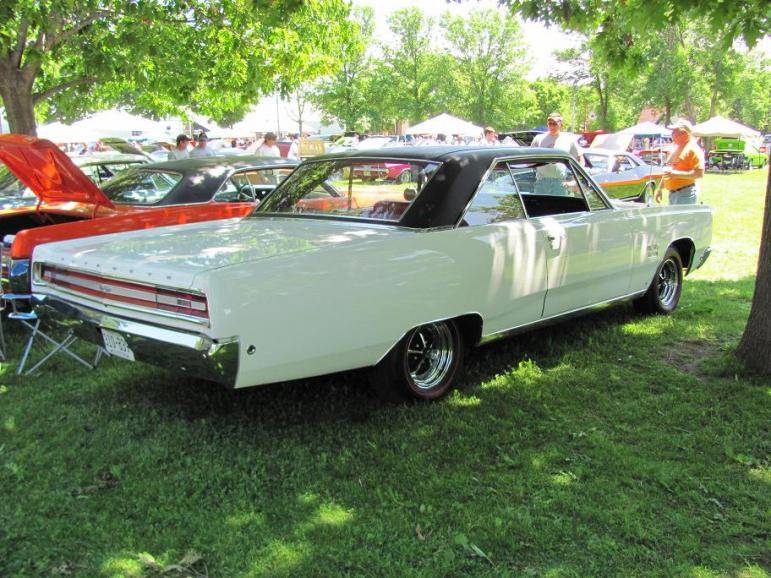

The 68 Fury I was referring to was in Indiana in 2008

I can't find any differences in the '68 Sport Fury from your pictures to mine, except the plates and the wheels, and I don't recall anything about the interior when I saw the car. It may be possible that it is the same car. The picture that I took was in Farmington MN, last June at a Mopar event, so it could be that it found a home further west.
