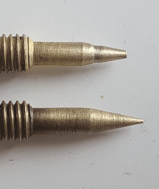

Been messing with the mixture adjustment for the thermoquad for a while now and today, for some reason I can't think of right now, I decided to pull the mixture screws. It didn't look right to me so I compared it to the mixture screws in my old TQ.
Side by side, top is new, bottom is old:
The top one is notched at the tip and no, this is not because of overtightening. Haven't tried putting the old screws yet, but has anyone seen this before? Am I right in assuming the top one is wrong?

Welp some hammerhead took a big screwdriver and cranked that mixture screw in to tight to damage (ridge) the needle and the seat in the carb is most likely damaged (junk).

The old carb is definitely in worse shape than this one and not rebuildable. I do still have it though since returning the core would mean shipping it across the Atlantic and that is more than the core is worth. I figured the ridge was by design cause for someone to damage it like this you'd have to screw it in really tight, like ridiculously tight.
Engine ran pretty decent with it and if I didn't pull the screws I never would've known about the ridge. But thanks for confirming my suspicion. Will pull the carb this weekend for further inspection and probably put in the old mixture screws to see what that does.
"To point or not to point"? I'd use the bottom one as it appears to be real metal, rather than a softer cast metal. Don't worry about the point length as it's where that taper hits the idle mixture hole in the throttle body that really matters. In that respect, they look pretty close to each other, just that one has a longer point past that contact point.
The one with the knurls on the edge of the screw head looks more accurate for an OEM item, to me. FWIW In the close-up picture, the top screw looks to be cast from the same softer metal that some later GM engine oil pan drain plugs are cast from. Which is a softer metal, by observation that they used to use in the 1970s, by observation. Which might well explain that deformed area on its tapered area.

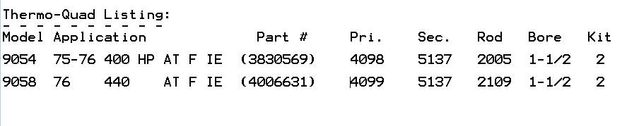

OK before you go and do much of anything you have a 400ci carb.
From the 'A Carter Thermo-Quad Guide'
Forget about the "S" letter but it appears the primary jet and rod are different.
One thing you have to be concerned about is your new primary jet screw has a broken off tip, sometime this tip can be lodged in the throttle bore orifice.
DO NOT INSTALL YOUR OLD SCREW UNTIL YOU ARE SURE THIS BROKEN TIP IS NOT IN YOUR CARB!

The casing number being for the 400 ci carb was the first thing I noticed too when I got it and that had me concerned, but when I opened it up it had the right jets and rods for the 440 ci, so 4099, 5137 and 2109, so I figured it would be okay.
Don't think the tip is broken off as both of the mixture screws look identical, but I will look into that.
I’ve never seen a TQ with those brass Idle mixture screws from the factory. Factory are steel, so they aren’t able to develop that ring from over tightening. Both brass and steel will distort the baseplate. Get rid of the top screw in your photo. Don’t be cheap by putting them in a little drawer for (just in case). Throw them away. I’ll send you some factory steel ones if you need them. The “screws” are actually valves that regulate a predetermined mixture established by the idle air bleed and the idle feed restrictor.

They're gone. Will use the old ones for now, might get back to you about those factory steel ones. Thanks Dana

Forgot to conclude this one, but big shoutout to @Dana for hooking me up with the proper mixture screws and main jets! Engine runs much better with them. Turns out brass is much more easily deformed than I thought and the old srews were indeed just over tightened.
