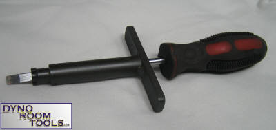

Looking for a TQ airdoor tool, as they're impossible to get online and DynoRoom Tools isn't making his right now. If you're in or near NYC, I'll come pick it up even. It's the final adjustment I need to make on this puppy. TY!
The tool works well, BUT you can get by without one. Use two screwdrivers, one wide blade and one very thin blade. Use the thin blade to modulate the hold-down action of the large diameter "ring" with the two tangs the tool engages with. With the small screw loosened a slight bit, then use the large blade screwdriver to turn the outer ring (with the tabs) to adjust secondary air valve spring tension.

I tried that but whoever had it before me kind of ate up the outer nut and I can't get a good grip on it. I'm a little nervous about eating it up even more and not being able to move it at all. This 440 had the TQ on it OEM so that's why I'm trying it. So far it's running better than it's ever run on anything else, even with the airdoors too tight (they never open).

The original Air Valve Tool was Carter 109P-397 or Miller Special Tools # C-4152B. Miller is now OTC. These are not available new any longer, but might be found used or NOS.
The last source that I knew of was DynoRoom Tools, but you discovered that it is no longer available as well. Bill Rolik has it listed, but apparently sold out: Thermo-Quad Air Valve Tool.
So, no known source at the moment.
