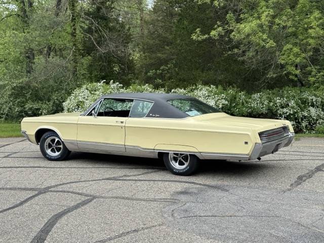

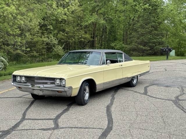

First time on public roads as an insured and plated car in almost 40 years. Took it for a test drive after replacing virtually all front suspension parts (thank you Craig at MobileParts), gas tank with fuel sending unit, all brake cylinders & shoes, master cylinder, brake lines, all parking brake cables, shock absorbers, spark plugs, fuel pump with inline filters, fan clutch, water pump, hot / cold coolant sending unit, thermostat, all hoses and belts and radiator acid dip / paint / re-core (Glen-Ray Radiators did a perfect restore to factory condition), transmission seals and filter. Also restored operation to all four power window motors, added new American Racing wheels (upgrade from factory 14" x 6" steel wheel w/ hubcaps to 15" x 7" aluminum factory rally style) with BF Goodrich tires (P225 70R-15), rebuilt original Holley 4160 carburetor, new upper control arm splash guards (perfect factory replica from Detroit Muscle Technologies) plus numerous other little things. Big shout out to Rick Adams here in southeastern Michigan for his expertise and hard work (he has the experience and tools / garage to do some pretty amazing work). Still needs a front end alignment, new dual exhaust, spark plug wires and a super thorough cleaning inside and out. The interior is almost perfect except for some sun fading of the rear seat fabric. Lastly I must say that information I gleaned from this forcbodiesonly.com site answered some important questions no other place on the internet could easily answer.
