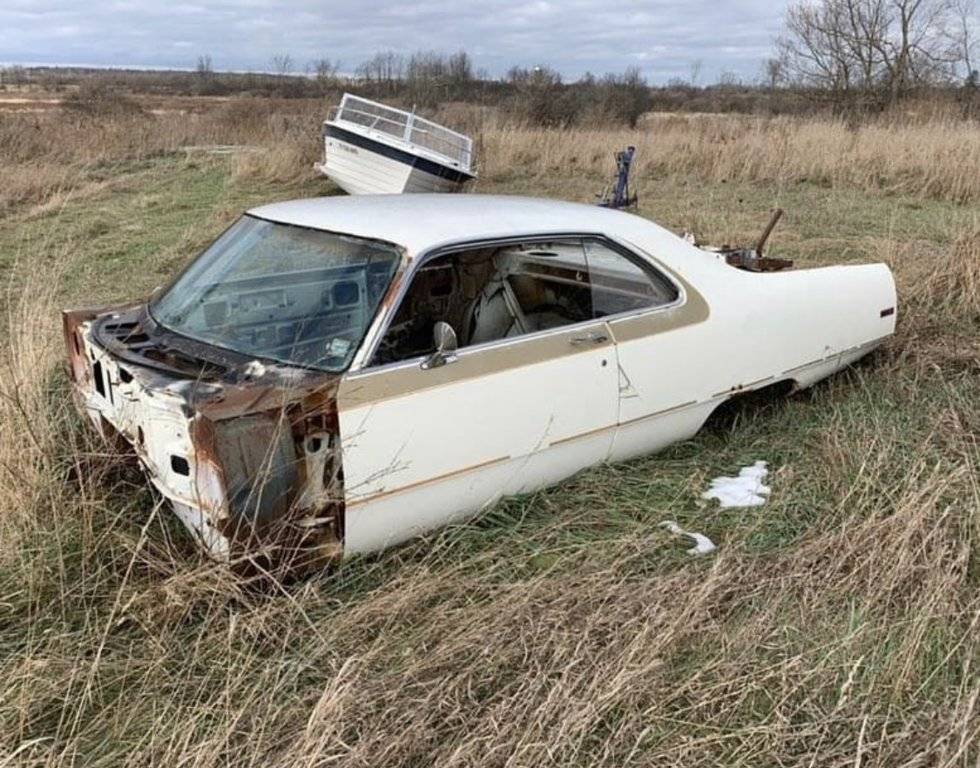

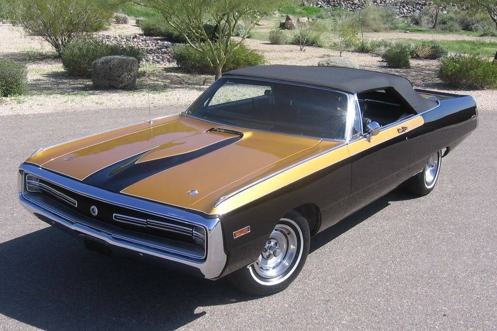

Shouldn't he paint it EW1 Spinnaker White first, and THEN add the gold and pinstripes? Like this:

Having said all that, I'm not a big fan of Hurst clones. Of course. For instance, I'll never quite figure out what was going on here. That poor, rare hood...the horror!

I am in no way trying to criticize anyone who has a clone, I just am saying every time I think about doing it, I also think of how it's just not for me. Regarding the picture with the Hurst hood, I'm sure that guy probably just likes the look. It does make it look more sporty. If they made aftermarket Hurst hoods, I'd probably get one. I just think they look bad to the bone. That being said, the older I get, the more I appreciate going for the factory look.

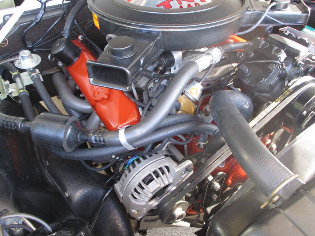

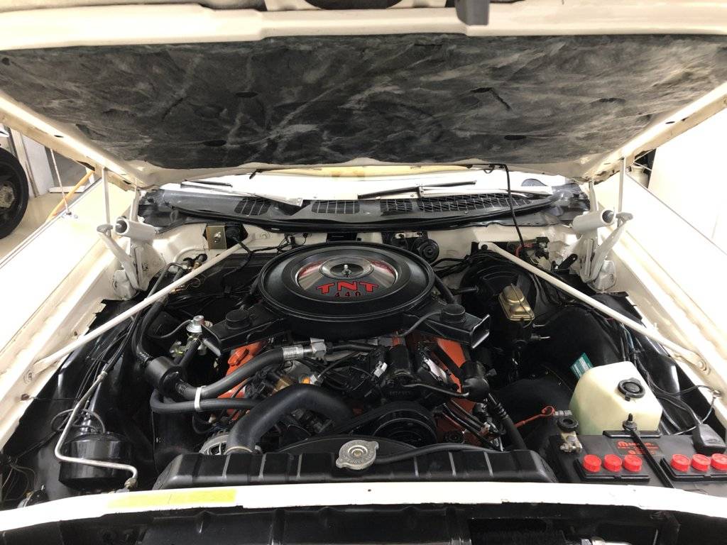

TNT, yeah baby!
As you "work-in-progress" your way thru your giant grey whale (how about the license plate GRY WHL?) I'm sure all of us here will be happy to provide advice and info, should you need to know about some nerdy detail. :thumbsup:

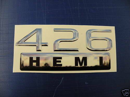

Oh, I had a clone car once. My first car was a 62 Valiant when I was 16, and in a Western Auto store I saw a pair of crappy, chrome stick-on 426 Hemi stickers. I didn't really know what a hemi was, but you can bet I paid my three bucks and stuck them on the forward end of the front fenders. Everyone was quite impressed, I'm sure. Too bad they're not in this pic so all of you could be equally impressed with my Hemi Valiant. :D

Thanks Trace 300 Hurst. :thumbsup: That is one awesome looking TNT! Hey that plate name is a great idea. Interestingly my dad worked at a Western Auto store for 30 years. I practically grew up in that store. Many good memories running around as a boy.

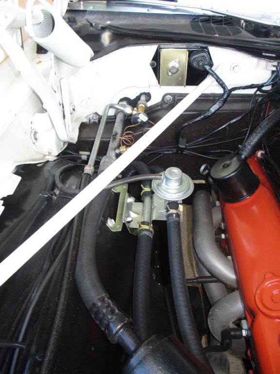

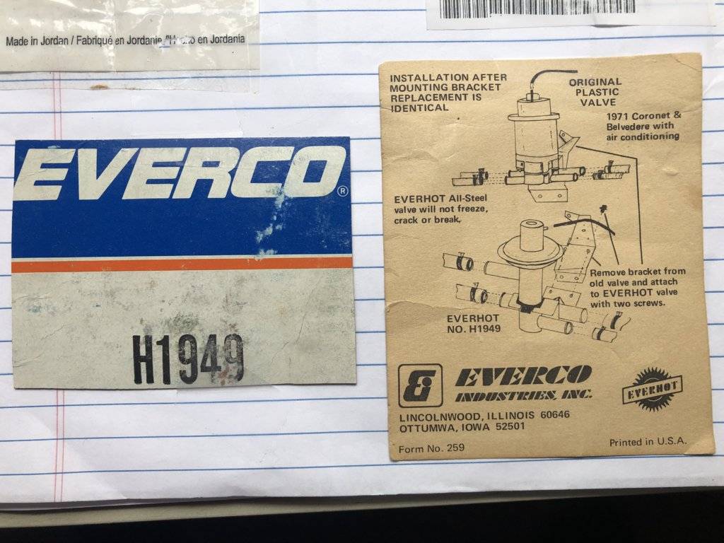

I do have a question though if I may, what type of heater control valve did you use for your TNT? My car's bakelite HCV is bad (cracks/leaks) and was wondering if there is a better option out there other than NOS or remakes, unless those work good. Thank you much again.
So.....do you have any cheesy, chrome Hemi stickers from your dad's Western Auto you wanna sell? :D
I spent the past two years studying the underhood of every C-Bod (and B, E and A cars for reference) that I could find at shows, auctions and web pics in hopes of correctness from the mess of incorrectitude it was when I acquired the car. I'm pretty happy with it now. In fact, it's totally done.
The NOS Bakelite valve is available out there for big money from the typical Mopar NOS vendors around the country. NOS New Heater Valve, Mopar 2936490 1969 1970 1971 Chrysler, B-Body w/ A/C | eBay
In my case, there was no valve at all--nor the damn bracket, and that was a long search for the right one, as that item has no PN to chase after. I bought the aftermarket replacement valve by Everco (for $80 for something that was $12.99 in 1975!) that ended up under so many hoods because of the crap design of the Bakelite unit. I replaced many HCVs when I was a lad working in a Plymouth dealership and in my parent's various Furys with the inexpensive and reliable Everco.
I would be sorely tempted to take your Bakelite valve apart and see if the crack can be fixed with JB Weld and maybe the orings replaced, or whatever. What ya got to lose? Anyone out there done this? Dave Lux? David Hill?
Here's the Everco info. Remember that there's a cable version, the two-vacuum port ATC version, and this one for regular AC cars.
