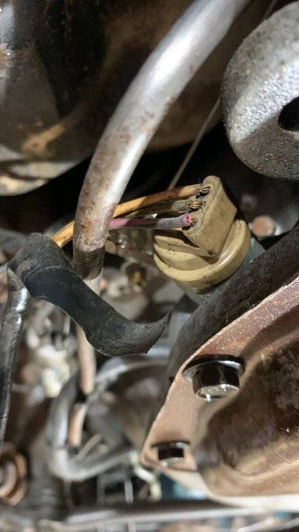

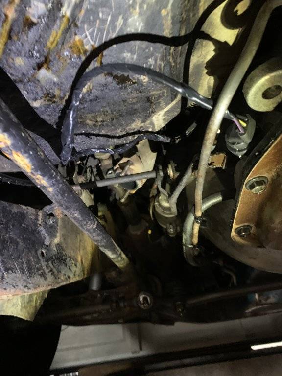

Jan 22, 2023 #41 BE_Fury Member Joined Feb 28, 2022 Messages 72 Reaction score 99 Location Germany I also replaced the plug and the cable from the gearbox. I insulated the cable again to be on the safe side

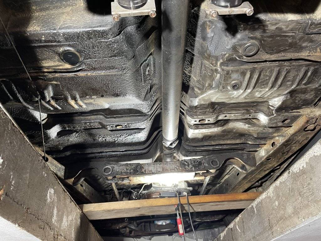

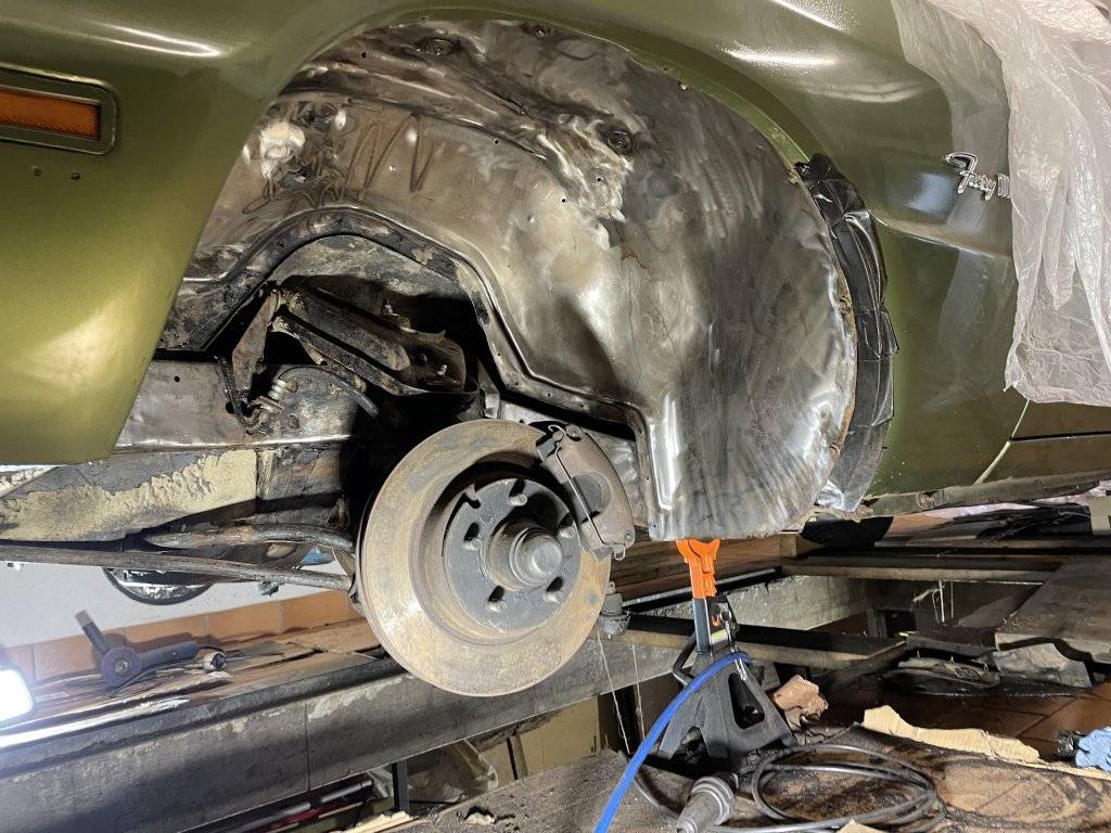

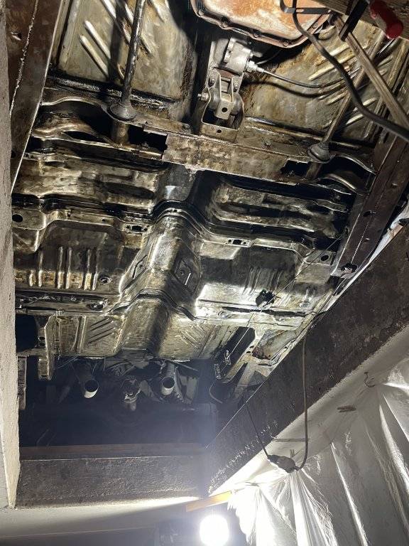

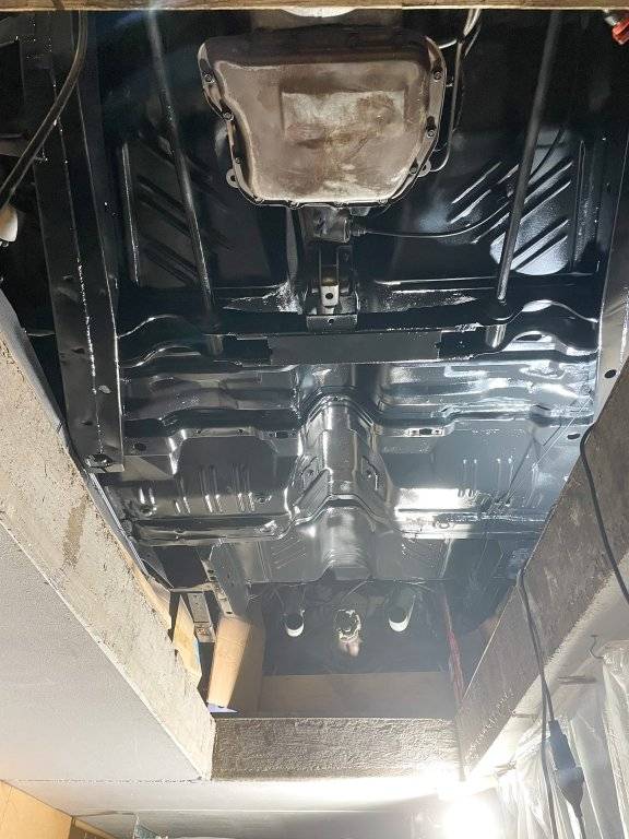

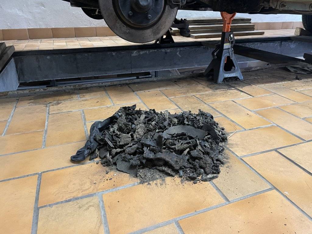

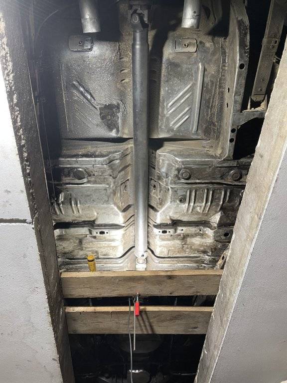

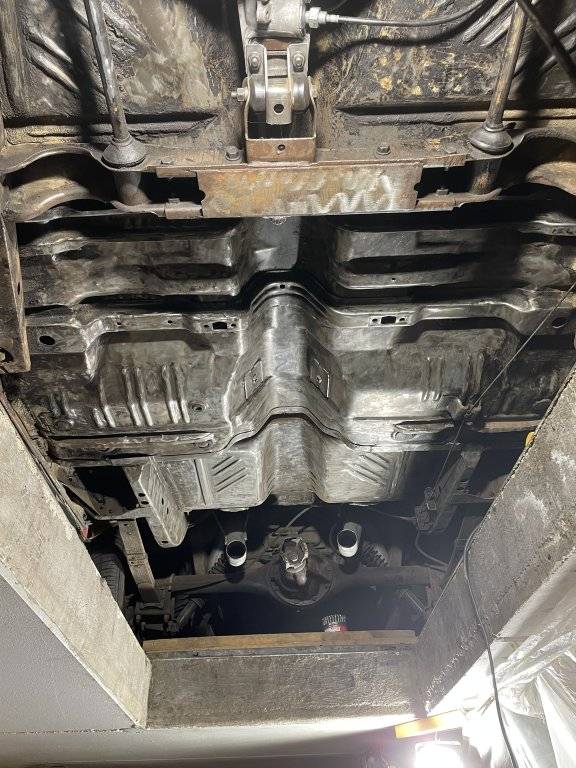

Mar 6, 2023 #43 BE_Fury Member Joined Feb 28, 2022 Messages 72 Reaction score 99 Location Germany Finally, I removed the old underbody with a heat gun and a chisel, as well as a flex and a wire brush. Everything cleaned up. Smeared the metal folds with Owatrol and then painted the underbody several times with Brantho Korrux.

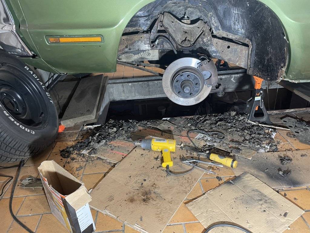

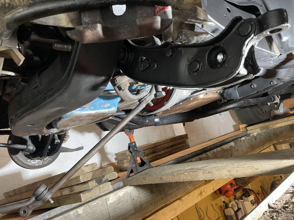

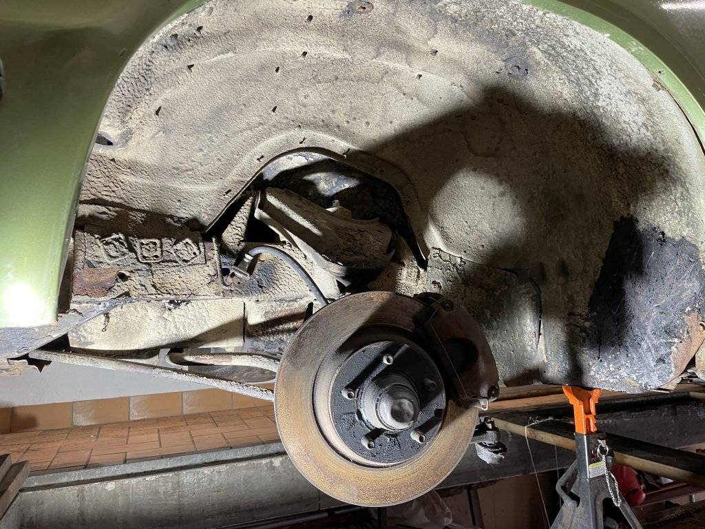

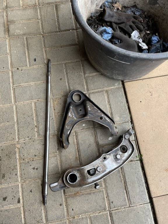

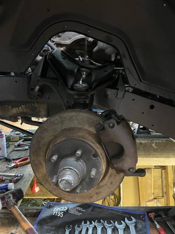

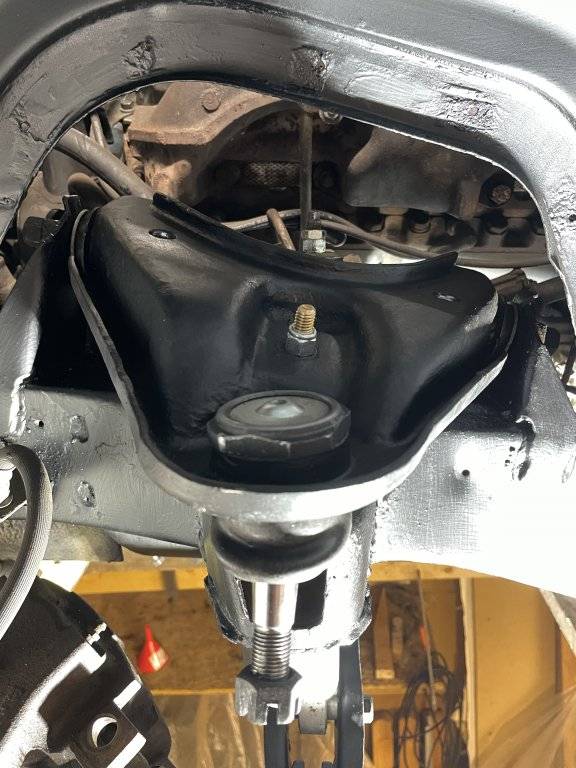

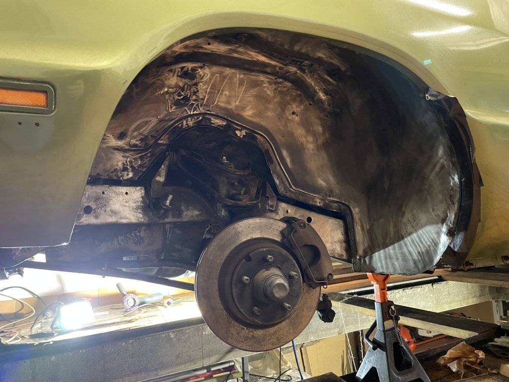

Apr 22, 2023 #44 BE_Fury Member Joined Feb 28, 2022 Messages 72 Reaction score 99 Location Germany a lot happened again. I replaced the front wheel arches.

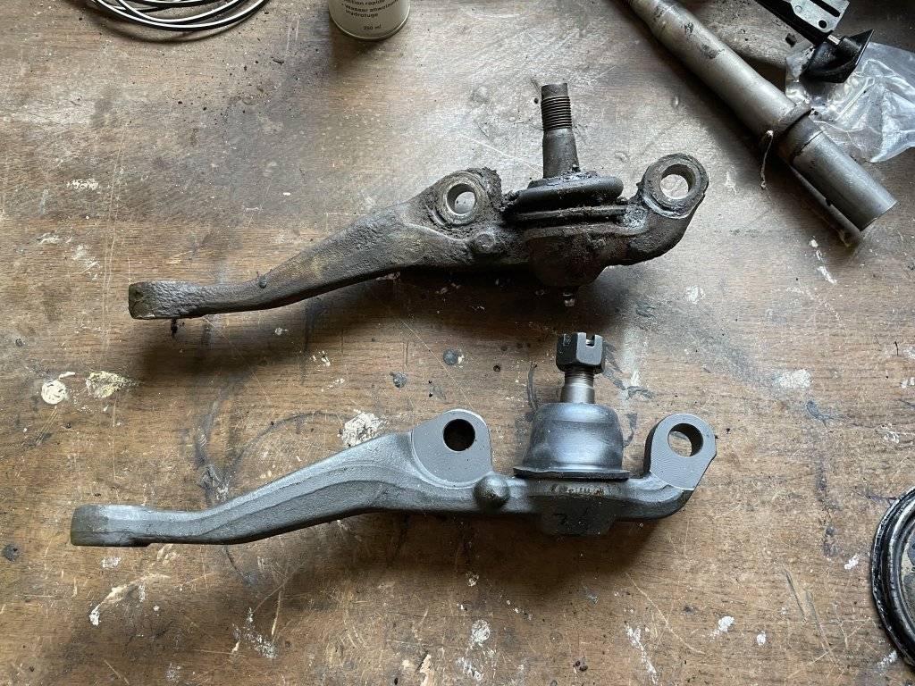

Apr 22, 2023 #45 BE_Fury Member Joined Feb 28, 2022 Messages 72 Reaction score 99 Location Germany Also the chassis is new
Apr 22, 2023 #46 BE_Fury Member Joined Feb 28, 2022 Messages 72 Reaction score 99 Location Germany Some more pics

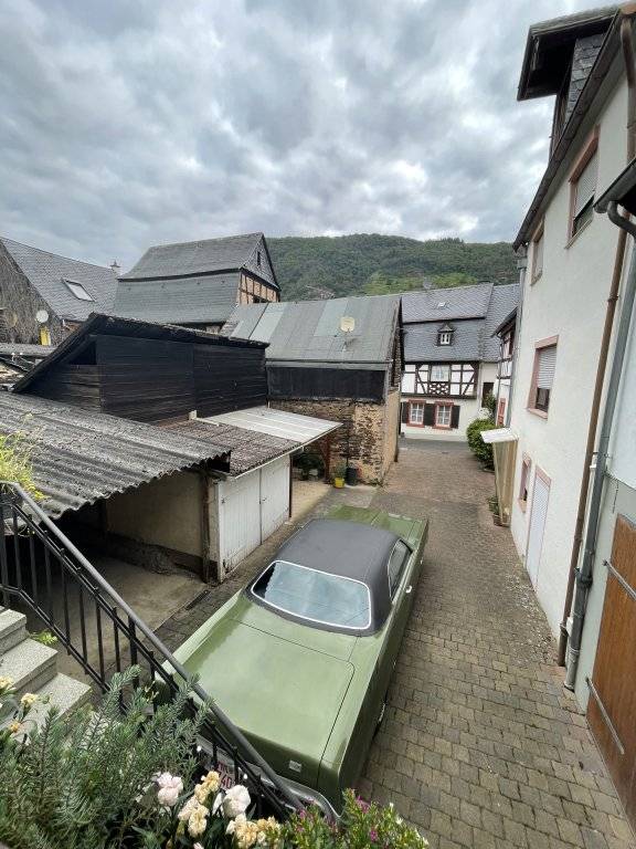

Jul 15, 2023 #47 BE_Fury Member Joined Feb 28, 2022 Messages 72 Reaction score 99 Location Germany I got the fury ready for the bbtr on the Moselle. Approval from the authorities went very well. Nothing stood in the way of the meeting. The journey was trouble-free. The engine is snappy but could do with some fine tuning. The meeting on the Moselle was great! Here are a few photos.
