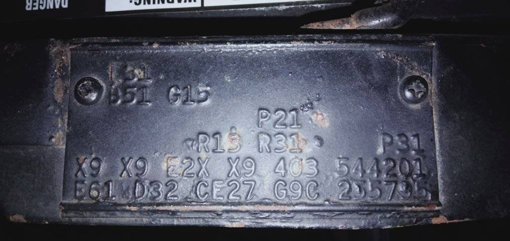

Your avatar looks like a 1969 Newport. If you want to post it’s fender tag, we could tell you more about options (including whether its 383 was originally 4-barrel).Some of us like our Chryslers in Australia... We like the large styling (although very hard to park in my apartment building.) They were bigger and more powerful than other vehicles (Fords and Holden) at the time...
Appreciate your kind offer of assistance... this is my fender tag....Your avatar looks like a 1969 Newport. If you want to post it’s fender tag, we could tell you more about options (including whether its 383 was originally 4-barrel).

Thank you sir. This is very helpful.Thank you for posting CE27G9C255795 -- the E61 at the bottom left corner, and the G in the 13-digit VIN, tell us that your Newport convertible's 383 engine was originally equipped with a 2-barrel carb.
Interesting combination of options. Here is the tag, decoded using this link (with some edits, as the Stock Mopar decoder is good but not perfect):
Code Description E61 383-2 Barrel D32 H-D A-727 TorqueFlite Transmission CE27 C = Chrysler
E = Economy (Newport)
27 = ConvertibleG9C G = 383 290HP 1-2BBL 8 CYL
9 = 1969
C = Jefferson Avenue, MI, USA255795 Sequence Number '255795' X9 Paint Code: Black / Black Velvet E2X9 Trim Grade/Style/Color
E = Economy
2 = Vinyl Bench
X9 = BlackX9 Upper Door Frame: Black 403 Date Built: 4 / 03 / 1969 544201 Order Number: 544201 R13 Astrophonic AM radio R31 Rear Seat Speaker P31 Power Windows P21 Power Bench Seat B51 Power Assisted Drum Brakes G15 Tinted Windows (Windshield Only) L31 Hood / Fender Mount Turn Signal
