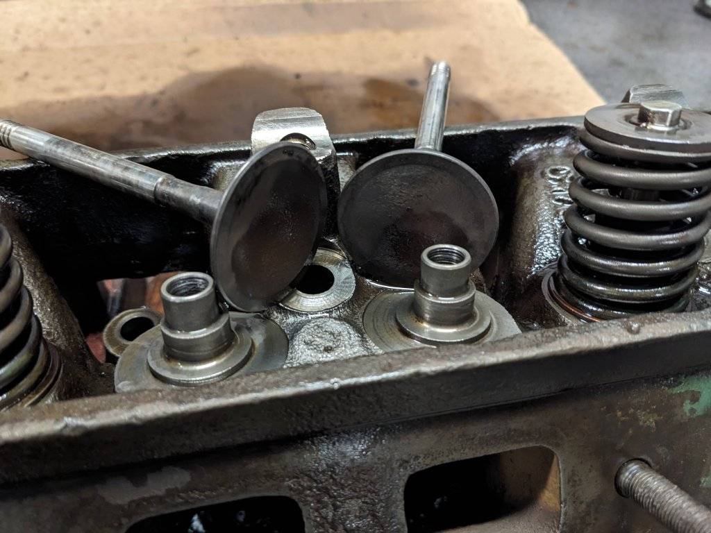

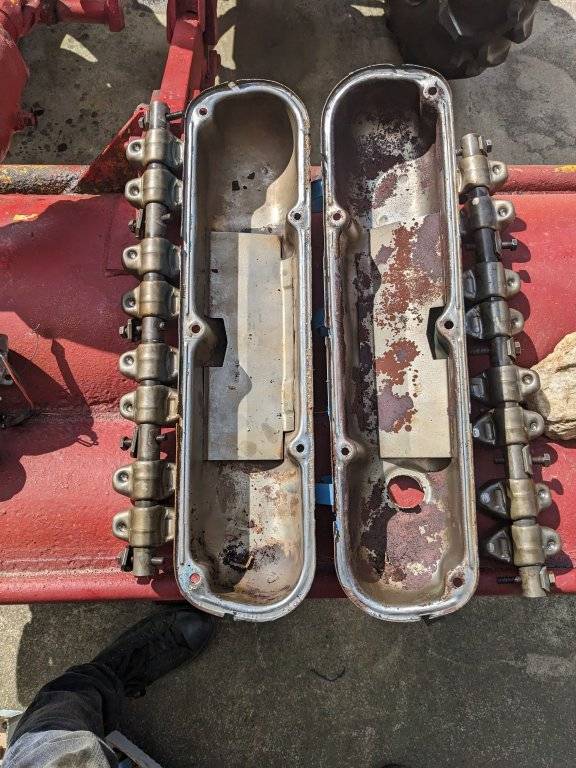

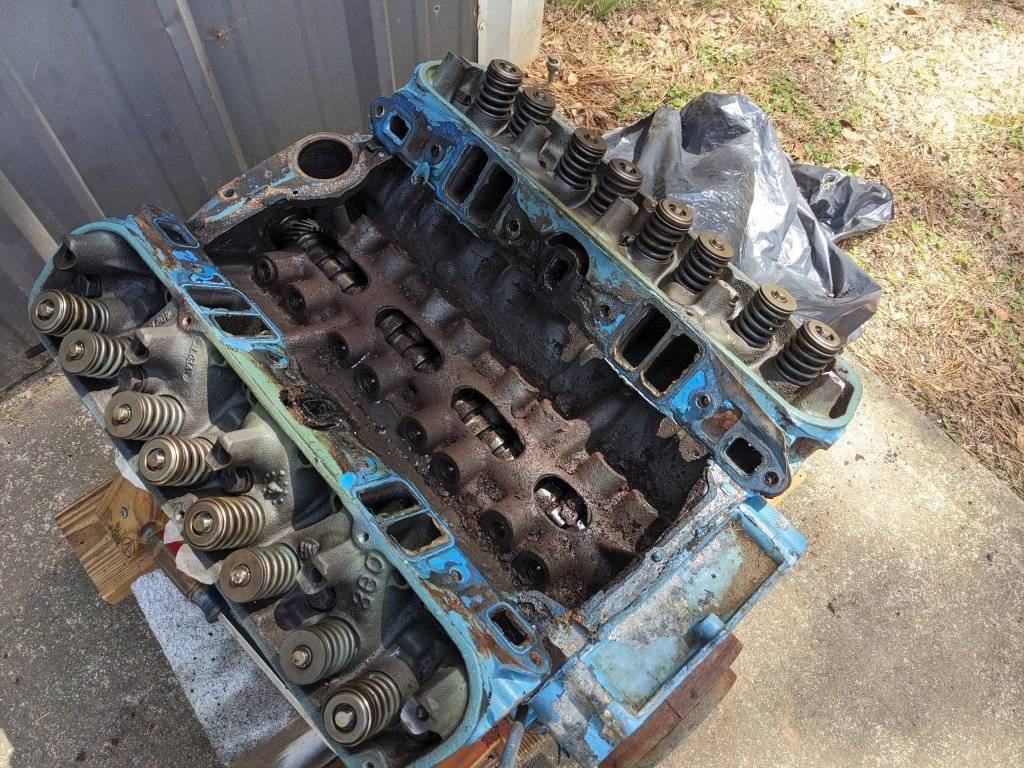

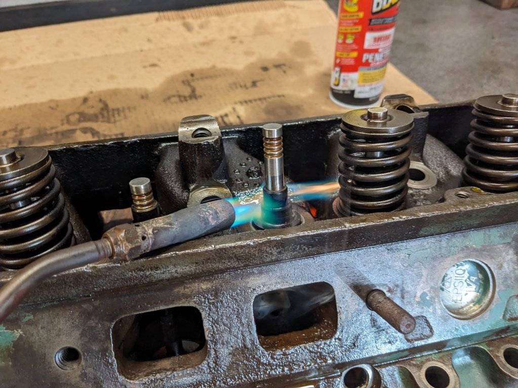

Resurrecting some junkyard heads. Casting number 3769902 from a 1974 440. They previously had a stock valve job, then the car was parked for a long time.

Penetrating oil, fire, and smoke = dangerous fumes.

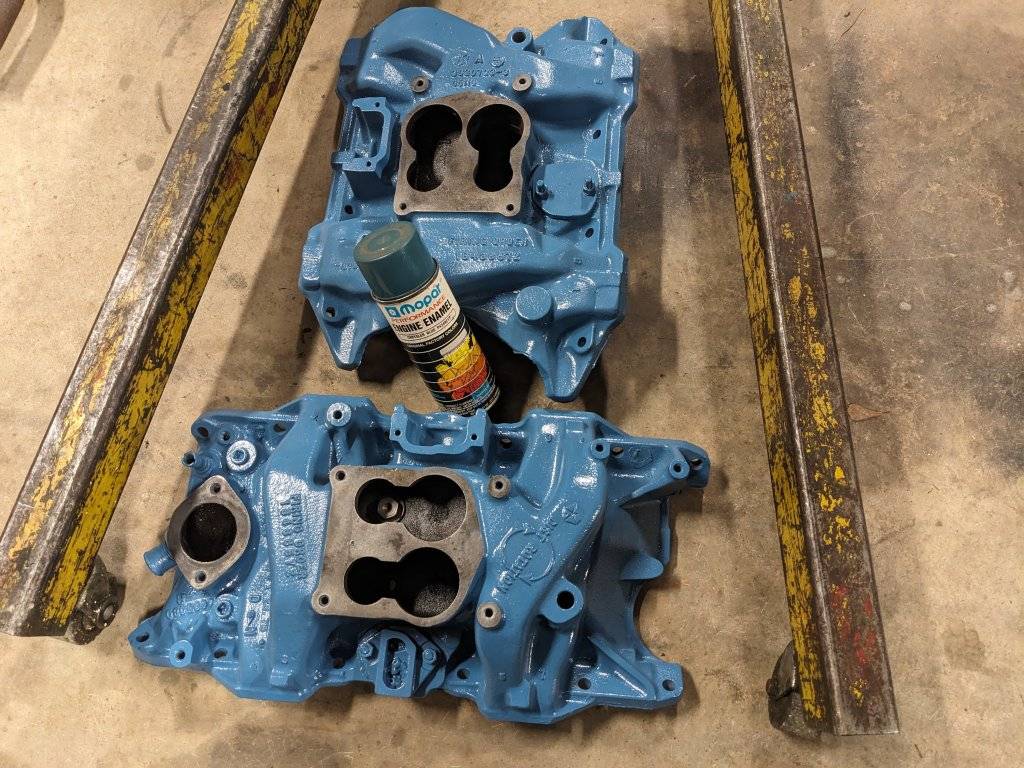

Also did some painting of some recently pulled parts. A couple shown here:

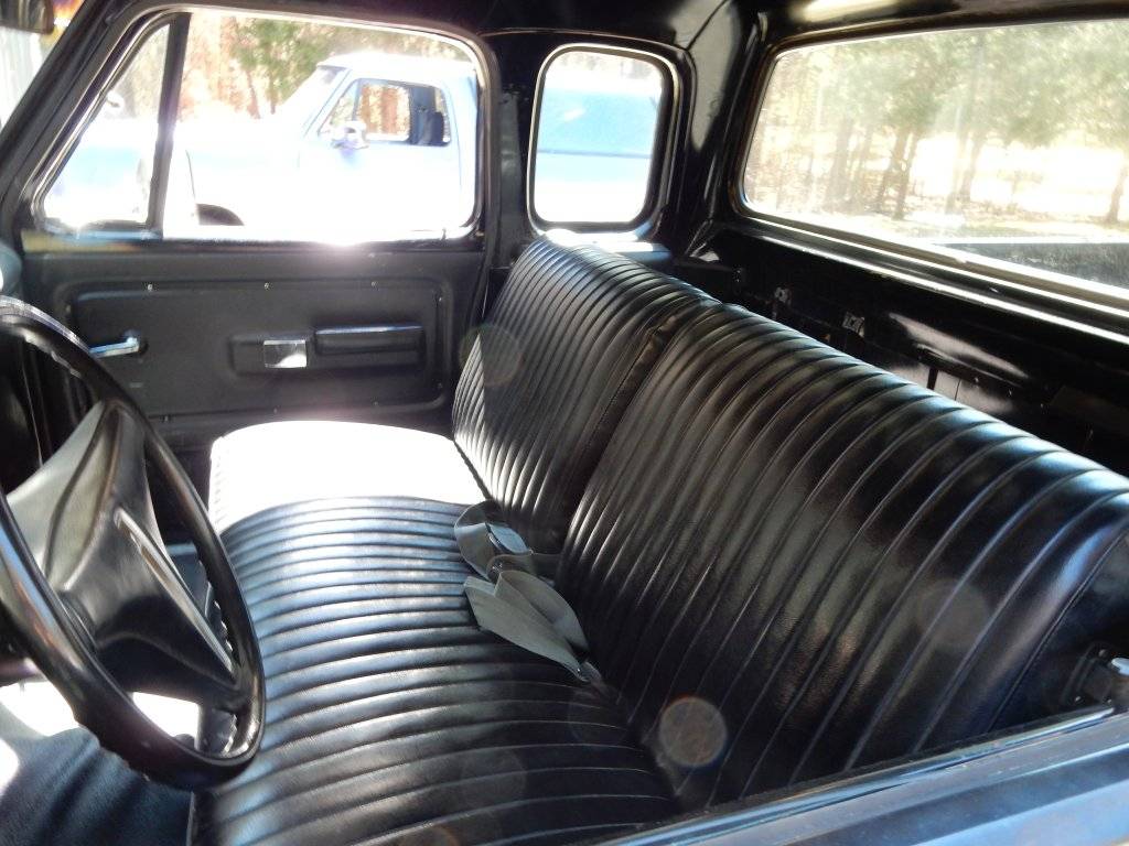

I had one of those Dodge club cab 1/2 ton, maybe it was a 3/4 ton. A 74 think. I replaced the front seats with some nice comfortable bucket ones from a 90s something car.
The truck came to me with a sour 318, and then a known good 360 with the flex plate soon presented itself.
That was a very good truck. I should have kept that one.
I liked driving it much better than the 70s Ford or GM product trucks.

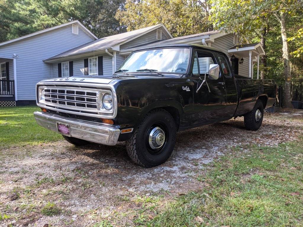

I think I would have been happy with even a 225 six cylinder. It was a real sweet ride. Smooth and quiet. But I didn't tow anything with itCool. Mine is a 1974 D200 (3/4 ton) with 440, automatic, and 4.10:1 Dana 60. It was originally a 400 that ran fine, but I found a deal on a new, from Chrysler, 440 short block, so I swapped it out, retaining the 400 heads. I got the 440 short block from Herb McCandless. He had purchased all remaining 400 and 440 short blocks from Chrysler.
I bought it in 1990 and have used it for many things including daily driver, towing, hauling, moving all my stuff when I moved to where I reside now (many trips over a few weeks), etc. It has about 253000 miles on it. I still have the bench seat, but I did recover it in the 90s.
