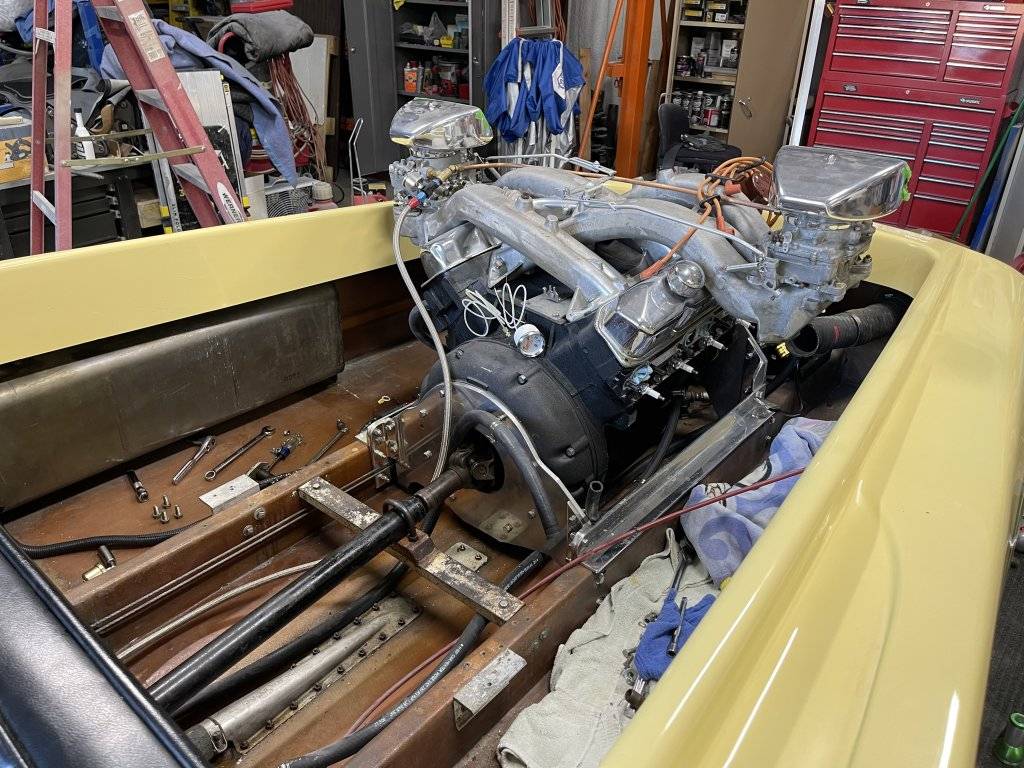

What Engine is in my Boat?

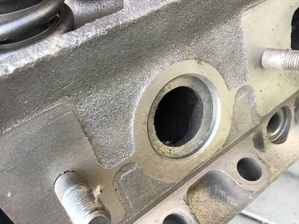

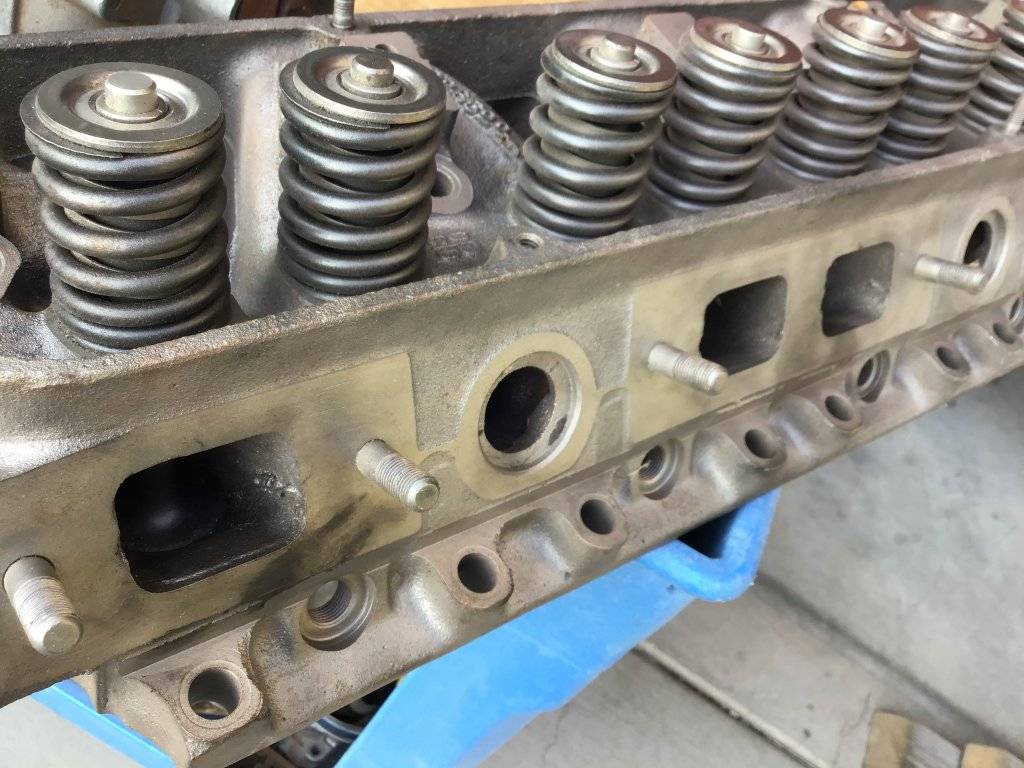

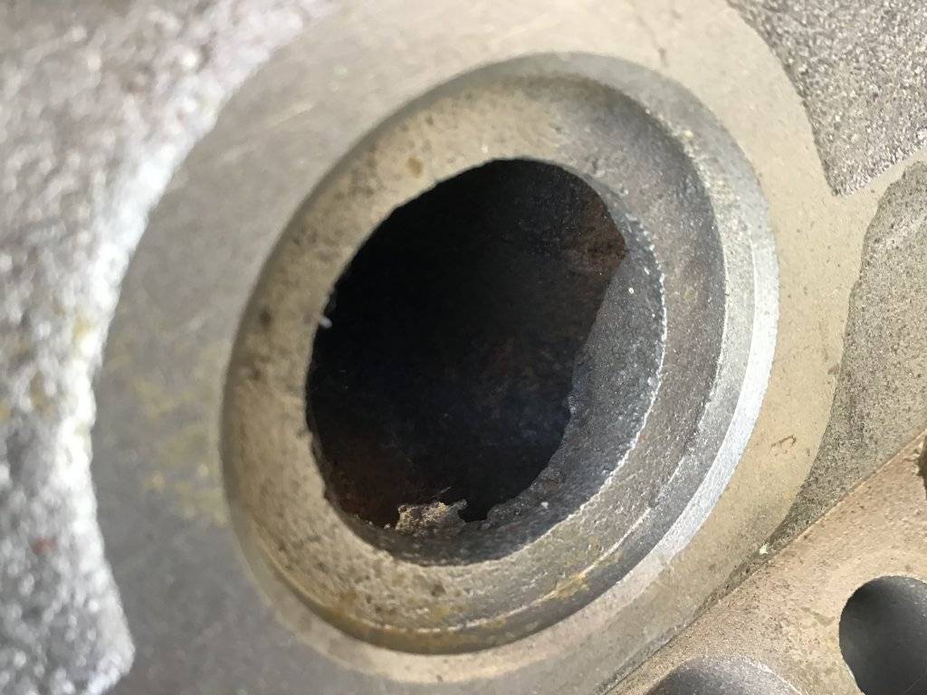

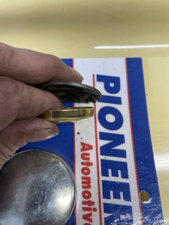

Annnnd the engine is coming out. Freeze plugs are leaking (steel) and I can’t get a good hit to pop them. One partially came out. But the “skirt” is still in the block.
Play with engines, Car or Boat it will be fun they said LOL
Can’t seem to upload a video from my phone of it running.
Will see about a local rebuild place to get the starter rebuilt this week.
Ok, update. Disc plugs out. THANK YOU 413 for the information, way easier with that major piece of the equation, didn’t have to pull the engine. LOL.

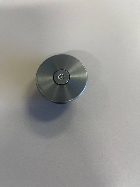

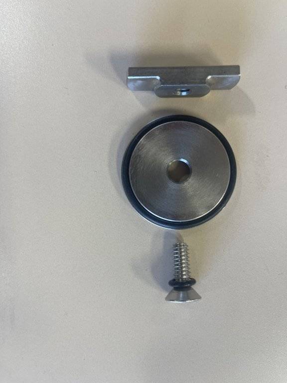

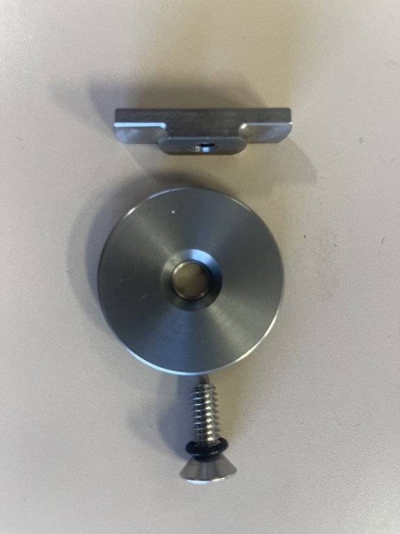

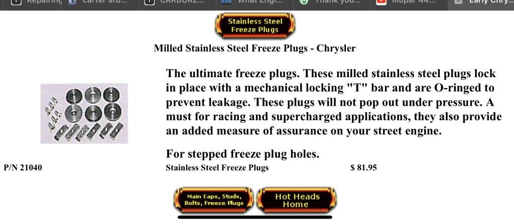

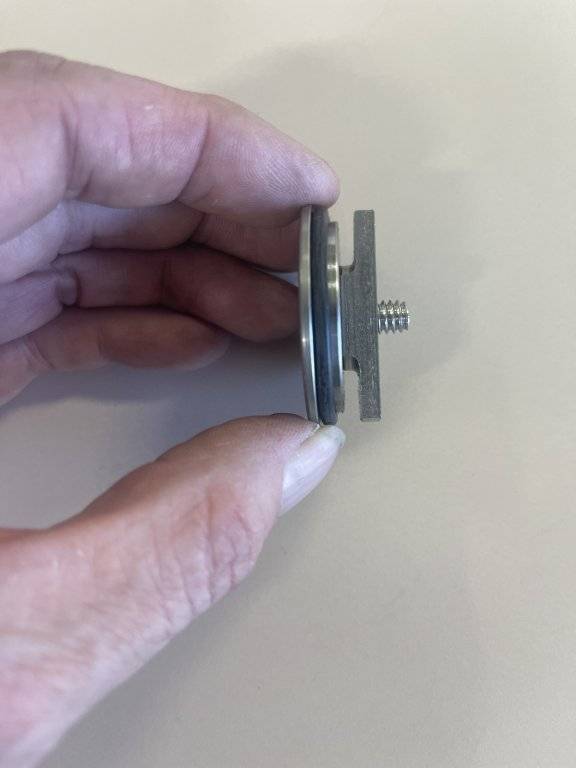

For my next question, has anyone used these from Hemi Hot Heads, and if so what’s your thoughts?
I like the simplicity of them, I like that if it were to start leaking you can replace an o-ring. And being in a boat, I don’t have headers hanging down so they could easily be checked for tightness and even loosened to drain the block for winterizing.
Am I missing something? Thanks James.
I like those plugs! Never seen those before.

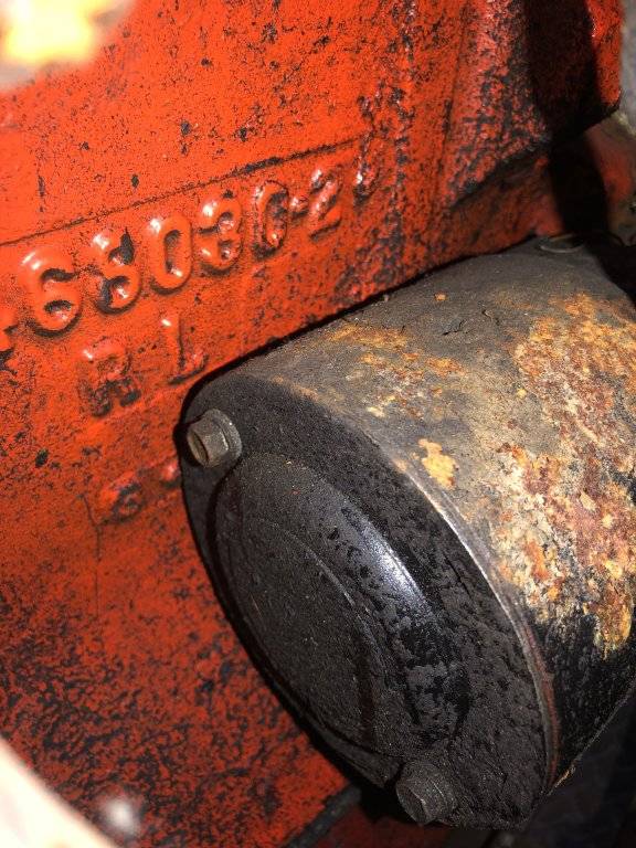

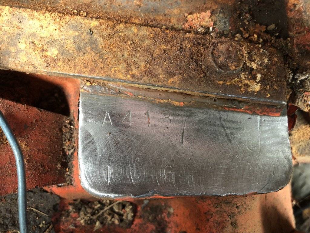

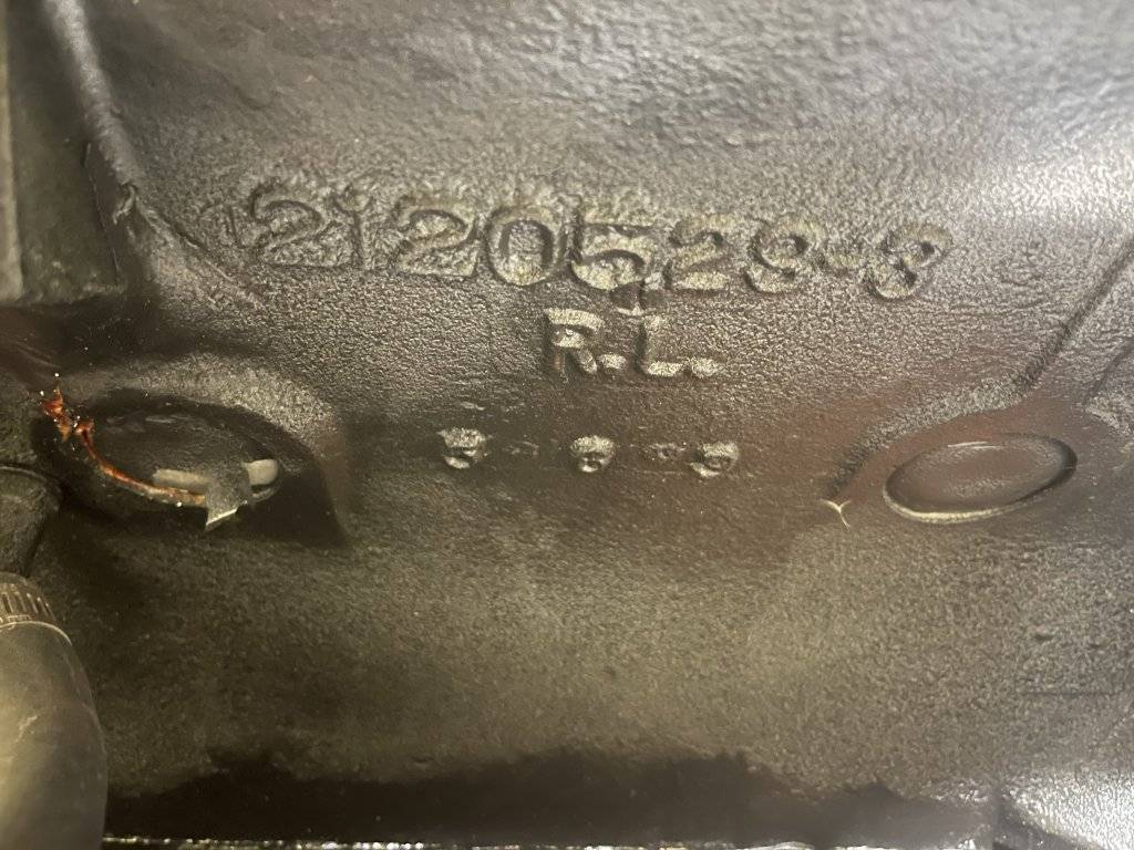

I don’t know if this was mentioned or not but on the front of the block right in front of the faults of the valley pan cover you should see the designation for your motor I will show you an example picture of my 413
Thank You, The pad stamps don’t show up up well on a picture as yours do. But I can make up P41 and 1030. As was conveyed to me, it’s a 1960 413, assembly October 30 1959. Here’s the picture I posted prior of the block casting.
Update…core/freeze plugs from Hemi hot heads work great with the lip style block(see previous post).
