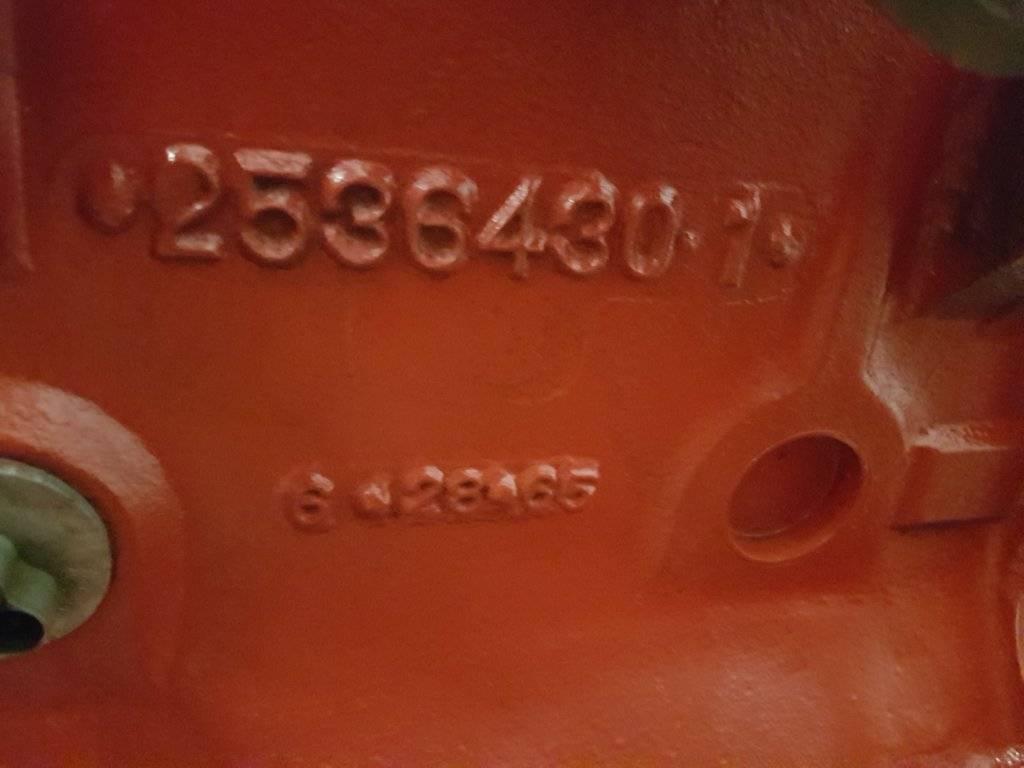

@Lefty71 Here's your proof. :) Both my 66 cars are early builds - my wagon is a dealer demo and my 440 4 speed Monaco is a special order.
Casting date on the Monaco's motor is June 28, 1965, as evidenced by the picture, and a production date on the fender tag of September 7, 1965.
My wagon has a replacement block in it, and therefore is not date correct. It has a production date on the fender tag of September 15, 1965.
This makes finding a replacement date correct block a challenge to be sure...
Casting date on the Monaco's motor is June 28, 1965, as evidenced by the picture, and a production date on the fender tag of September 7, 1965.View attachment 340978
@Davea Lux - how does one determine the production plant for the block in question? Is there a mark or stamping? I know the assembly plant is indicated on the VIN, but where on the block? I'm interested specifically for 66 blocks.
There was an engine serial number on the '68 and later blocks back by the starter which includes the engine plant code. Unfortunately the older ones do not have any identifying marks that I am aware of that reference the particular engine plant.
Some interesting reading available at www.mmcdetroit.com and www.moparts.org/Tech/Archive/motor/36.html
For your '66, you would be looking for an engine casting date about 60 days prior to the build date for the car, that number is approximate as the times varied. Mainly want the engine assembly date to be prior to the build date of the car for points purposes. Most RB engines will have the assembly date on the machined pad with the year code and displacement stampings.
