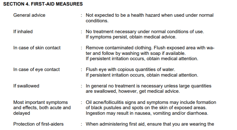

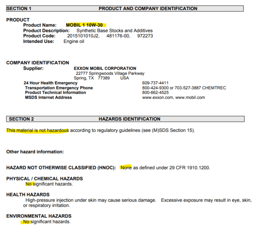

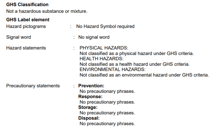

That applies to used oil, not new. For instance, here's an MSD for Mobil 1:
This is MSD for conventional (dino) oil:

Yeah, a nice thick leather glove would probably work fine. I didn't HAVE any when I started using this tool in my teens. And the "pistol grip" apparatus does kinda need to slide across the web of your thumb as you squeeze the grip to open the compressor, thus my discovery of lots of motor oil. Clean, new oil, of course.
Gloves? And I'm not talking about the wussy latex type gloves but heavy leather workman gloves or welder gloves. Also comes in handy for handling hot parts that you don't have time to wait for them to cool down.
Yes, work gloves are prudent in my book. I don't trust even CLEAN motor oil in contact with my hide for any length of time. Hydrocarbons DISSOLVE LIVING TISSUE!
