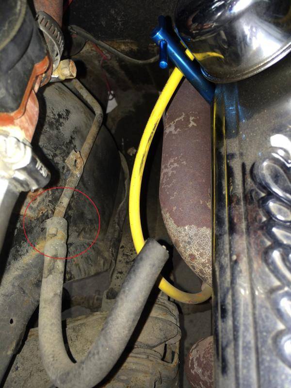

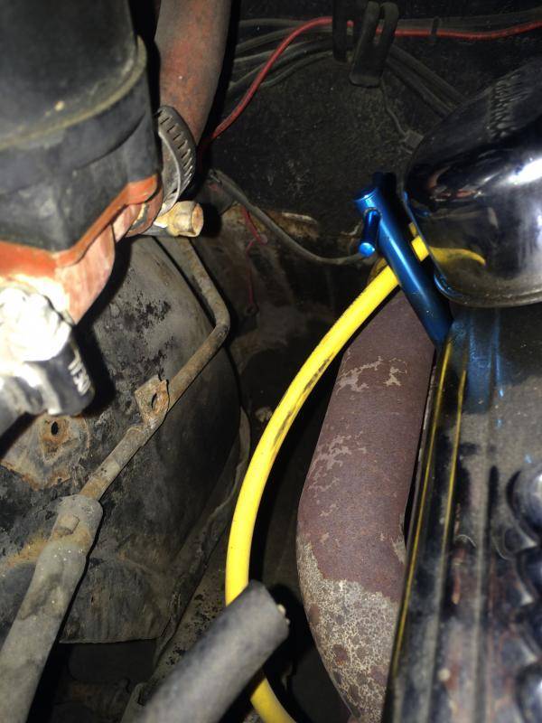

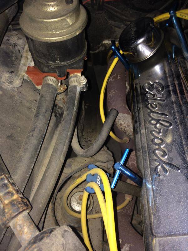

Just like the title says, what the heck is that? A mystery tube going somewhere into the firewall. its on the passenger side, so I have no clue what it is supposed to be hooked up to, as is its just dangling by the exhaust header. Has a metal line to the firewall, and then comes to the hose end that is just floating there.
I only noticed it as I recently purchased a replacement vacuum actuated water valve since the old one was leaking, and was taking note of things on that side of the engine bay.

No rear heat or air. Currently the heat/ac controls do nothing when pressed or moved, so I'm guessing this is the vacuum line for that, but my service manual does a lousy job of showing what the proper connection should be in the engine area. "IF" that is what I'm looking at.

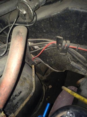

I went out and took another photo, and circled the "mystery" hose and the metal line juncture.
The rubber hose is just dangling there.
That car is apparently equipped with the evaporative emission controls that were required on California cars at least, but not the rest of the country. This was before the evaporative charcoal canister days that came later. This line routes the fuel vapors from the fuel tank to the engine crankcase via the breather, where they are burned off when the engine gets hot and running, via the PCV system. Your car should also have a pipe looking apparatus inside the trunk on the right side and also about 6 nipples/hoses leading from the right side of the fuel tank and routed into the pipe device to condense vapors into liquid to go back into the tank to minimize the amount of fuel going to the engine (those 6 hoses are shielded by a metal cover on the right side of the tank underneath the right quarter panel). The line in the engine compartment gets routed to the breather, that has 2 auxiliary nipples on it, rather than the standard breather with one such nipple. The second nipple on the breather is used to route vapors from the carburetor bowl when the engine is shut off also into the engine crankcase. That is why it was important to change the oil more frequently due to more than usual contamination from condensed fuel. Not the best design in the world to me, and that is why the carbon canisters were a much better setup, costwise too.

Wow! I didn't even think about the fuel system since the car has an electric fuel pump now! Also, I can confirm the pipe like structure in the trunk as the fuel tank breather.

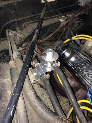

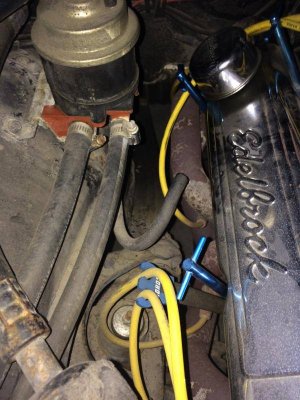

Well I got the replacement vacuum actuated water valve on, shortened the lines coming from the water pump, and noticed that one of the vacuum lines on the vacuum reservoir was cracked so I trimmed the end off and shoved it back on, went tooling down the highway to see if anything would leak, and on a whim I switched the heater on, and WE HAVE HEAT!!!
All three fan speeds work, defrost works, even the temperature adjustment made slight but noticeable changes! Tried the AC, but it just blows hot air, so no biggie there. I also took off that fuel vapor hose that was dangling, and left the hard line in place. A successful weekend repair! Time for a beer! :D
Well I got the replacement vacuum actuated water valve on, shortened the lines coming from the water pump, and noticed that one of the vacuum lines on the vacuum reservoir was cracked so I trimmed the end off and shoved it back on, went tooling down the highway to see if anything would leak, and on whim I switched the heater on, and WE HAVE HEAT!!!

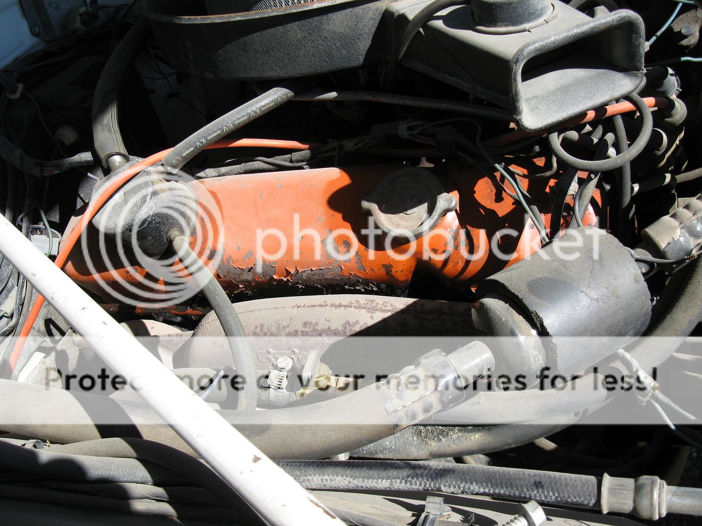

its my understanding that these valves weren't all that good and would still allow circulation and hot air comeing into the inner compartment making things toasty on warm days...seen alota these removed or modded...even on my 71 its been removed and modded
??? Looking at the photo, your airintake is pointing to the right ?? In my car, a 1971 Newport it's pointing to the left. Did you modify that too ?? Just wondering ...
