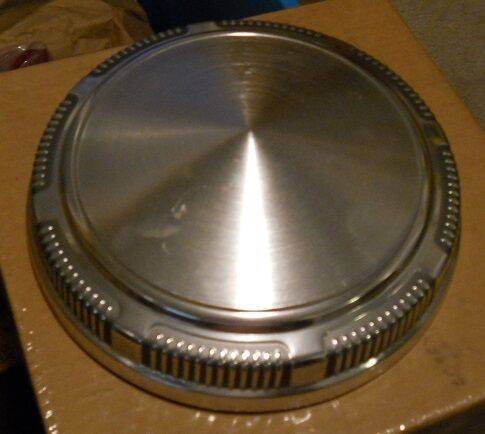

For what it's worth, I might advise matching the trim rings to the hubcap, some are brushed, others are polished, etc..
Someone in DC (not on this list that I'm aware of) has a '68 Newport droptop with the Chrysler Dog Dish hubcaps, body-color (light yellow) painted wheels, and polished trim rings, it makes a nice look. If you have the later "poverty" caps which SEEM to be brushed, the brushed rings might work better. Good luck, and looking forward to the result.

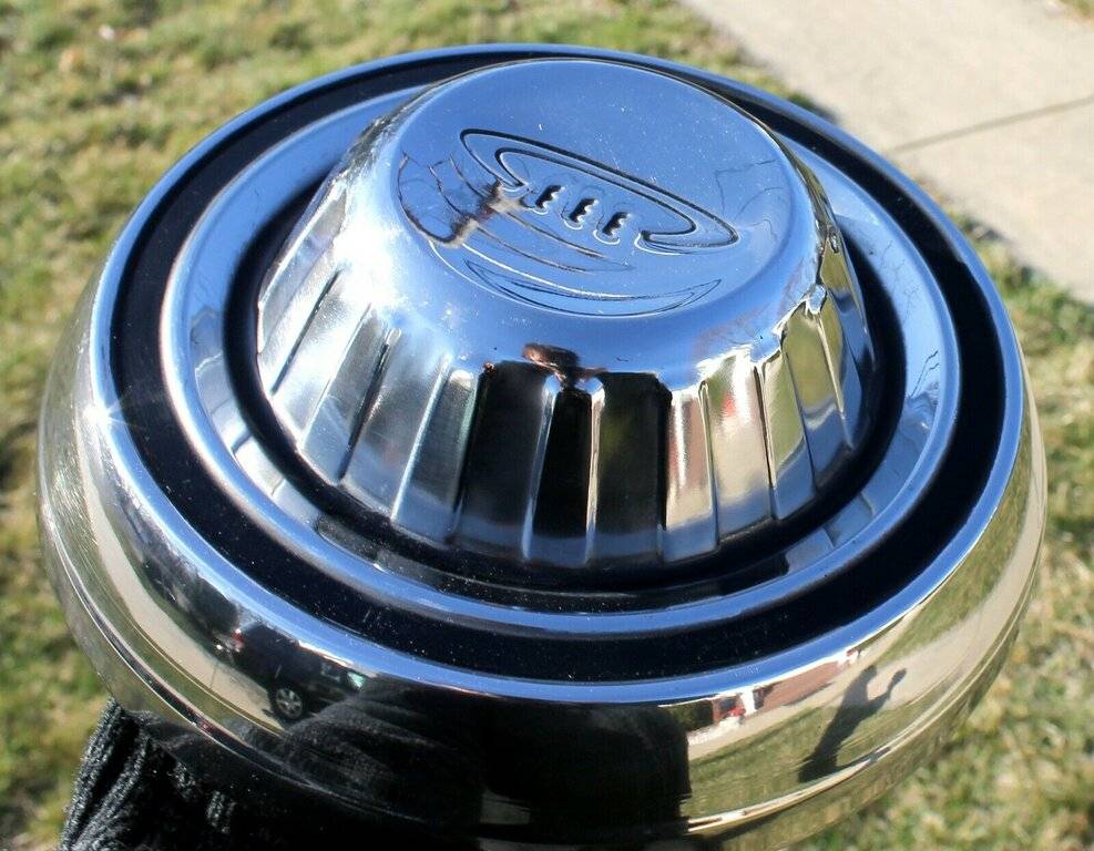

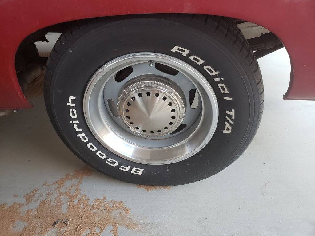

I actually was having this discussion with someone on Facebook yesterday. I bought myself a set of cop rally wheels in February of 2020 and then in October bought a set of Fratzog hubcaps (to fit Delmae’s ratty look). However, the look I really want to go for is the top photo, which is similar to what the Super Coupes had. I’ve heard that early Mopar Rally wheel centers will fit, so I’m looking for beauty rings now

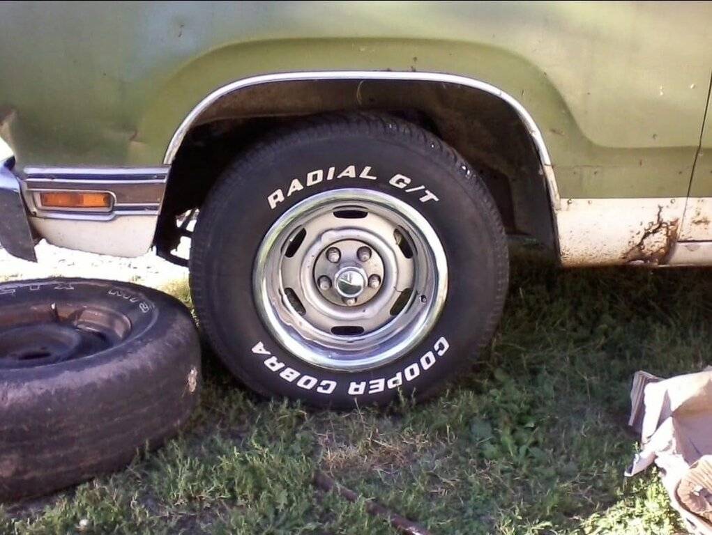

I have these on my A-100 , they are from a Ford truck . I have the pt # if interested in using something like this.
I have a set of the correct 1966 Chrysler dog dish caps like your first photo and my wheels are powdercoated black.

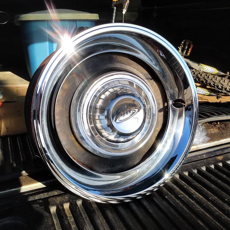

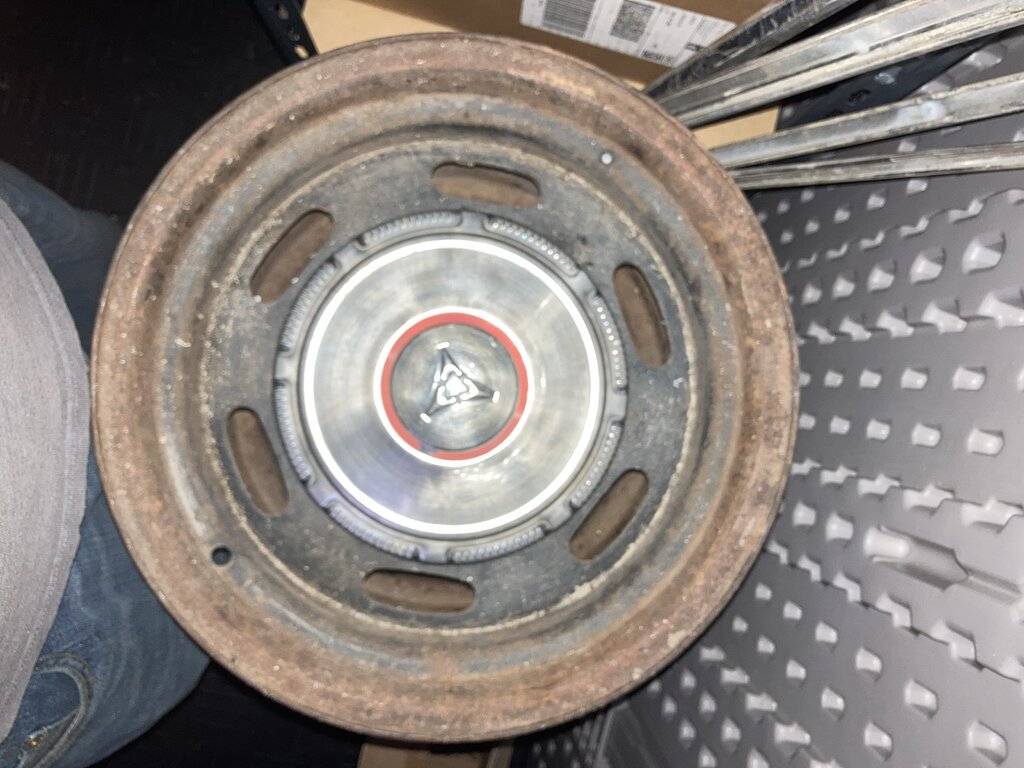

I got in touch with Wayne Young "The Lugnut King" who is a long-time vendor at southern Ontario swap meets. He set me up with a set of 15" x 2.5" deep chromed stainless trim rings for $135 CDN. He was going to be in the area this morning on his way up north so we met-up and I bought them from him. Here they are test-fit on one of my rusty spare wheels. My actual wheels are powder coated black. Now I just need to buff my dogdish caps so they're as shiny as the trim rings and repaint the black line that's supposed to be on them. :)
