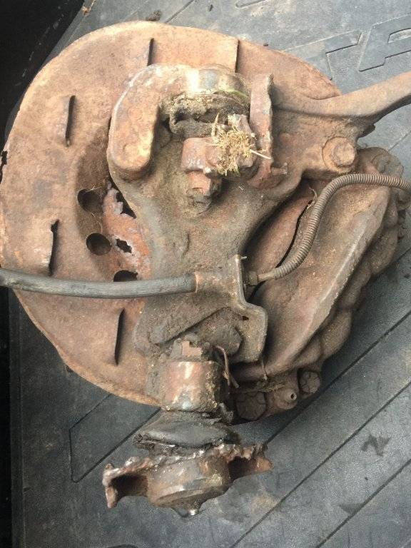

Hey guys,
I was able to make a trade this week end for a disk brake setup! The guy said they were off a 72 Monaco but looking at parts/pics I think they are off a 68 ... Hmm can anyone help me figure this out?
Also these are going on my 66 Newport, what other parts do I need ? I know a new master (but which one?) and a proportional valve (but which one?)

Those could get very expensive if they need to be rebuilt. What bolt pattern are they? Those are Budd calipers and there are no aftermarket parts available for them. I had to pay $100 for NOS pads and the pair I have on my Imperial cost me over $500 to have rebuilt. That being said, if the rotors are Imperial(5 on 5") and are still useable I would buy them from you.
I'm guessing they're 5 on 4.5" because of the looks of the lower ball joint though. Anyways, I'd keep looking for a different set-up if I were you, I'm not even sure you can buy rotors for these.

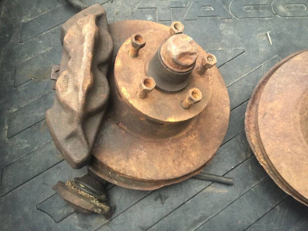

I'll measure them and post a pic.

The style of the dust shield is the dead giveaway as to which car(s) that your brake system is original to.
You have BUDD disc brakes for the 65-68 "C" body line of cars.
So the Hubs on the rotors will be the 4 1/2 inch bolt pattern.
