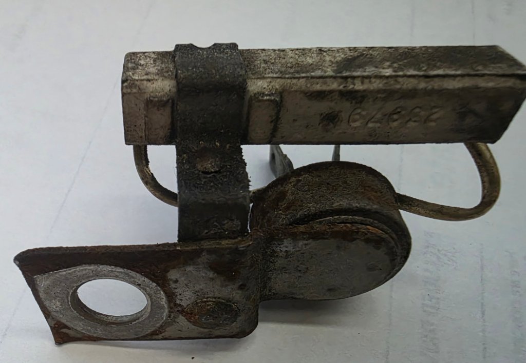

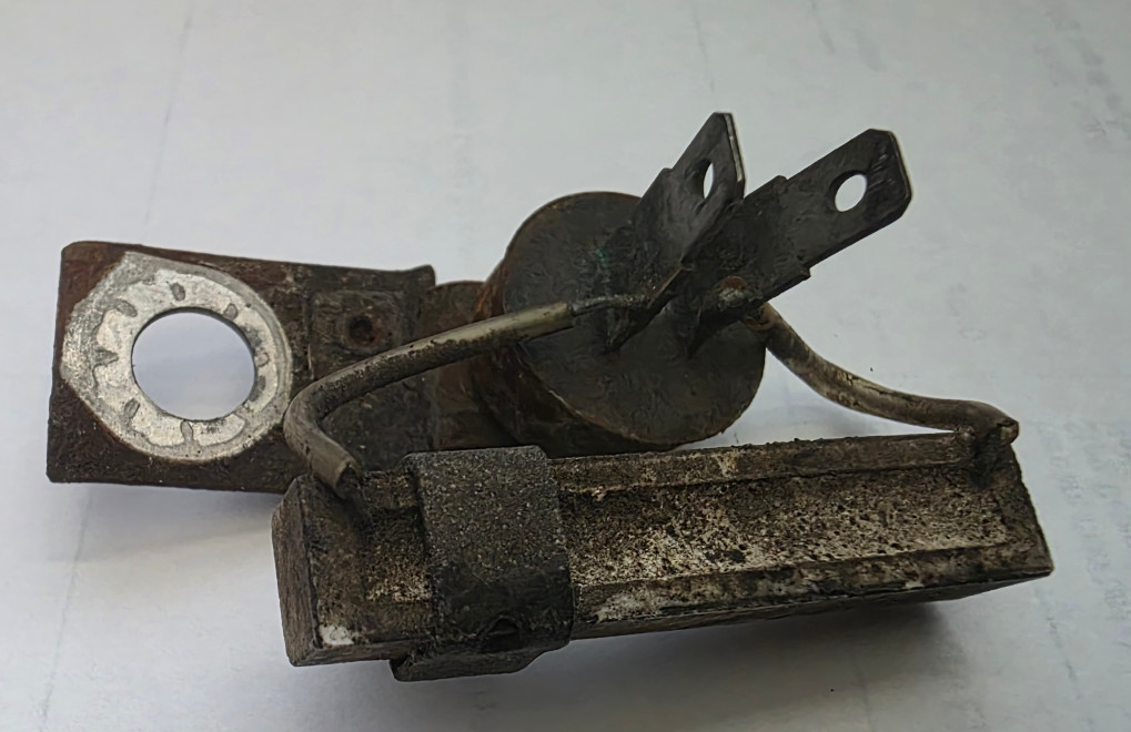

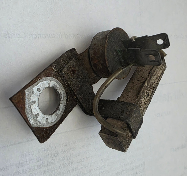

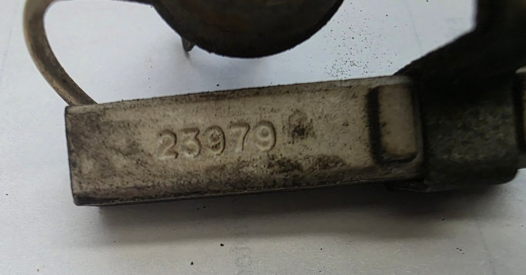

The pictured item is the electric assist choke control. This one is the dual stage unit, with the visible resistor, Chrysler part number 4049777 or 4091034, and was used on 1977-1989 models with the divorced choke, except those using the single stage unit.
The resistor is a ceramic encased power resistor but is not the same as the ignition ballast resistor. The number seen in the picture, 23979, is the vendor number, not a part number.
The control is not part of the Electronic Lean Burn (ELB), Electronic Spark Control (ESC), nor Electronic Spark Advance (ESA) systems, but was used on the vehicles so equipped.

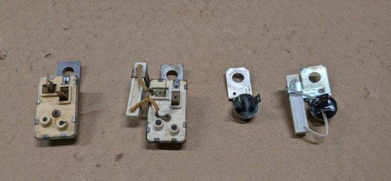

The four styles of electric control units are listed in the following and shown in the following image (left to right):
- Chrysler 3656730, 3698357: 1973-1976 single stage.
- Chrysler 3755750, 3755770: 1974-1976 dual stage.
- Chrysler 4049799: 1977-1989 single stage.
- Chrysler 4049777, 4091034: 1977-1989 dual stage.

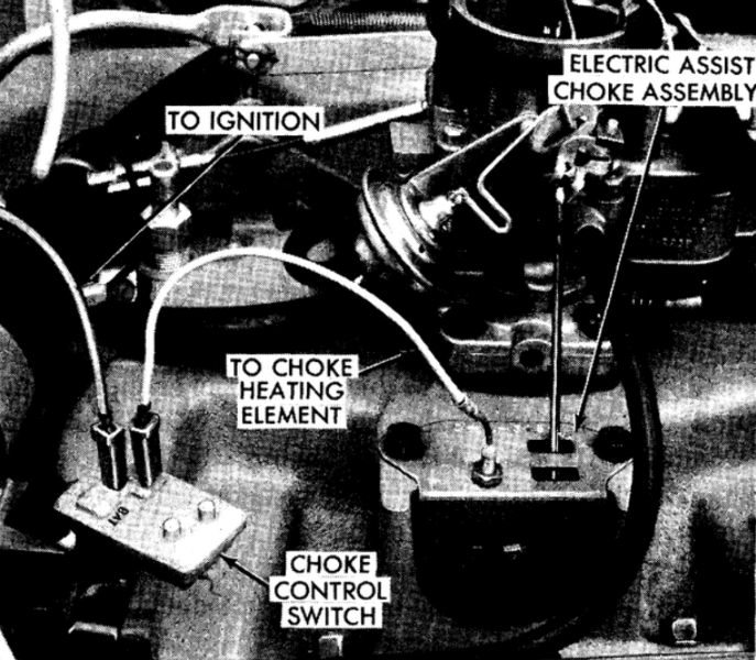

The controller is mounted on the intake manifold on small blocks or on the head on big block and slant six engines. The following image shows one mounted:
