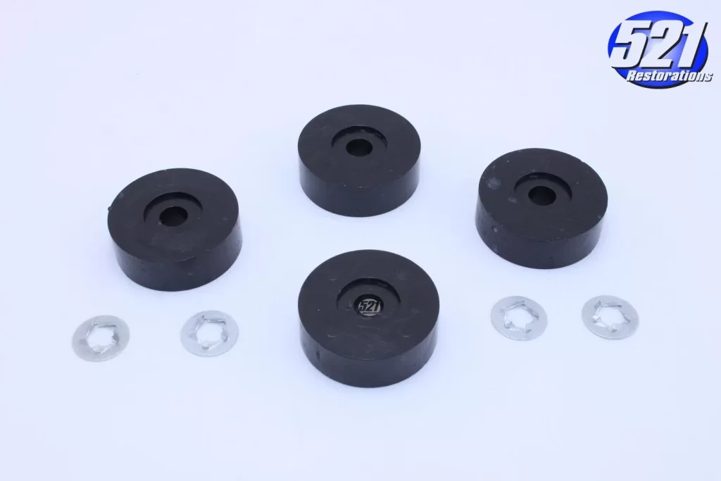

Chrysler actually offered a part to raise the seat. It was a small section of plywood with a U-shaped notch in it that you could slide around the seat mounting stud once the nut was loosened. It was about 2.5 x 2.5 inches. Easy enough to make yourself.

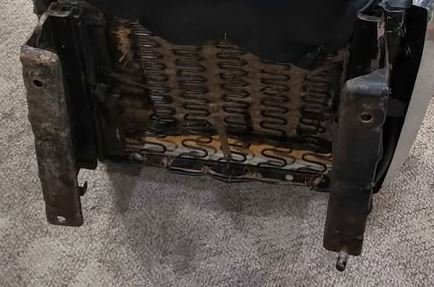

You can only raise it about one inch on the 6 way seat because the bolts are welded on to the seat frame.
Funny, my seats do not have the bolts welded to the seat frame. If they were at some point, they were cut off and drilled out. I have some 2 inch x 1 inch square tubing. I think I will just cut to proper length, paint them satin black to match the seat rails and the carpet, drill the proper holes and buy extended bolts. Lets see how that goes.
I don't think those bottom studs were welded in...more like carriage bolts with the square part peened into the track so it didnt fall out
