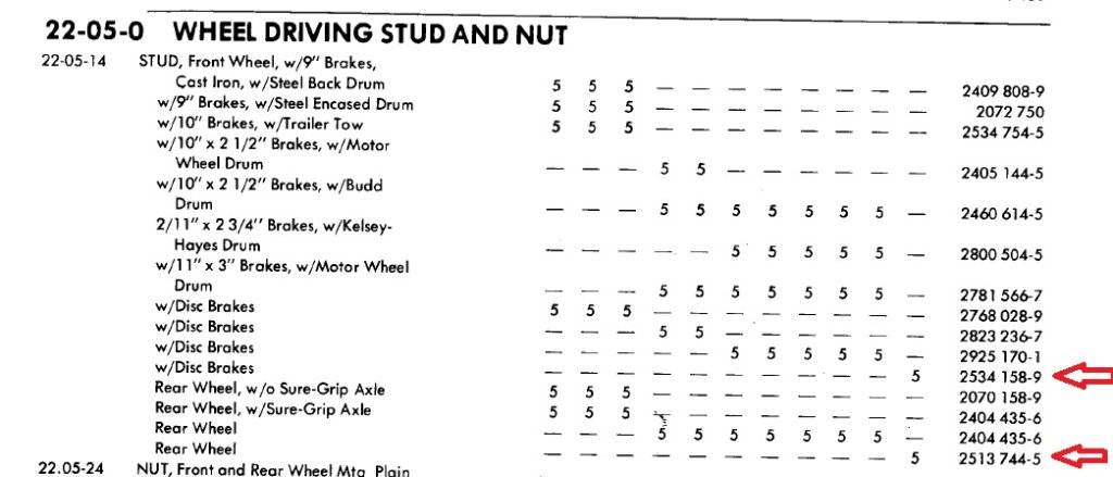

1/2-20 UNF is the thread size. Since the car is a 1969, you'll have right and left hand threads. Chances of finding the proper left hand studs are kind of slim, but right hand studs can be used.
To understand Imperial threads, 1/2 is the outside diameter of the thread. 20 is the number of threads in an inch and UNF is Unified National Fine or shortened to fine thread (versus UNC or coarse thread)
From the parts manual, the red arrows point to the correct studs you need. Sometimes you can match the part numbers to a replacement.
