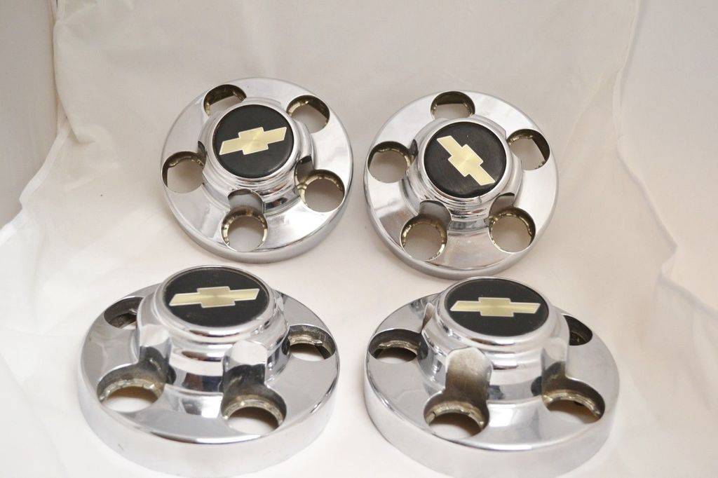

I would do what the article author did for center caps. The ones he used look the least "truck-like". All the other centers for the GM wheels bolted on from the outside, even the '94-'96 cop car centers. Just replace the emblem with a Chrysler Pentastar, Imperial, or LeBaron emblem. You may even be able to install the ribbed cap from the early style Chrysler road wheels, as it does unbolt from the base of the cap. I would also try using Chrysler road wheel trim rings, to give it more of a car/Chrysler look.
4 Chevrolet Center Wheel Caps 5 Lug 1988-1999 Van 1500 Truck OEM Used GC | eBay

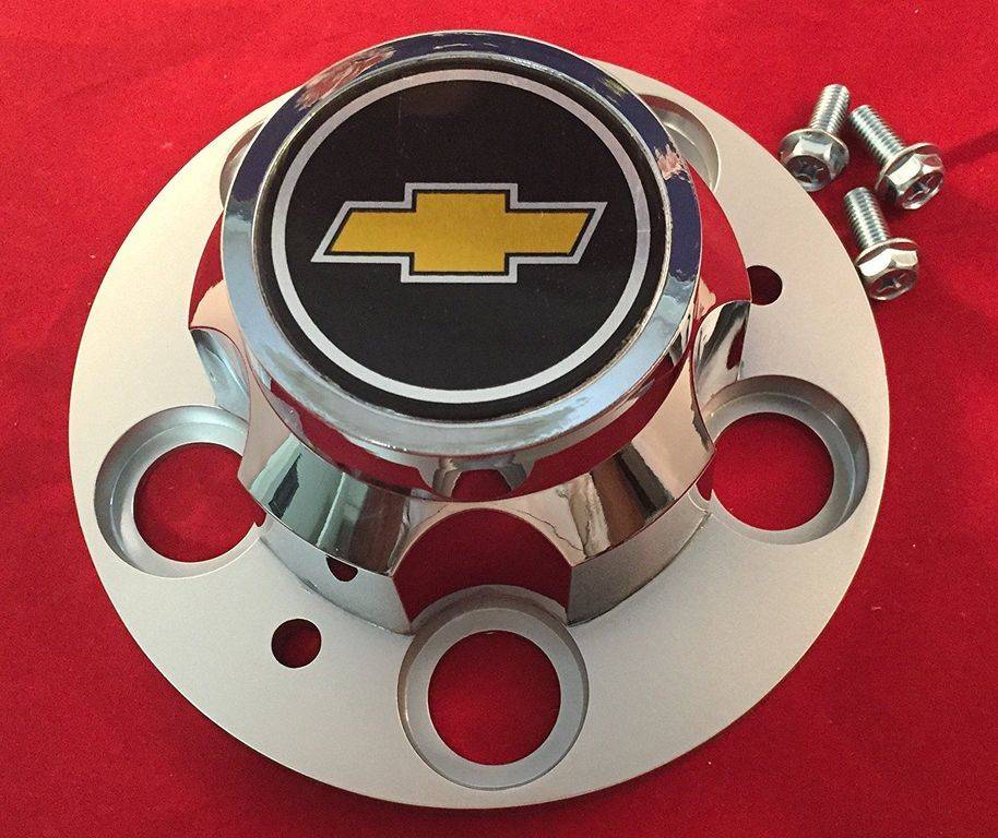

You can see here that the cop car center caps bolt from the outside. Using countersunk screws would improve the look.
1992-1996 CHEVROLET CAPRICE POLICE 9C1 Wheel Center Hub Cap NEW SET of 4 | eBay

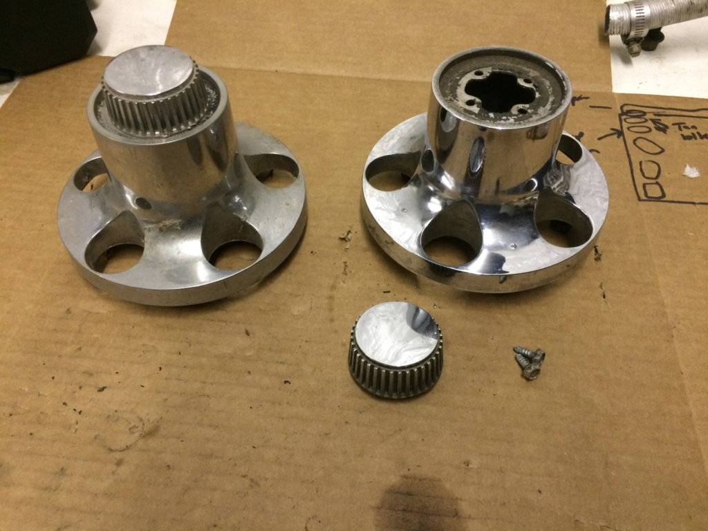

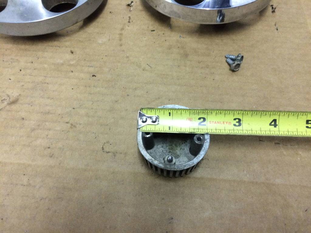

Here's a close up of the early road wheel centers. As you can see, the ribbed dome comes off. It looks like the dome could easily be mounted to the Chevy cap as long as the emblem diameter is greater than the dome diameter. The catch is to find some affordable early style centers where the dome is good and the base is damaged. They will need to be from a low salt area or the mounting screws will likely be seized in the dome, just like the first one I tried to take apart today.
One other possible snag: Chrysler front hubs tend to stick out much further from the wheel mounting surface than Ford or GM, so clearance under non-Chrysler center caps can be a problem.

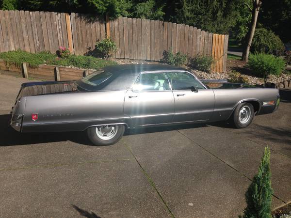

Of course the other option is to just install wheel adapters, which I suspect is what was done on the above yellow coupe.

I think the road wheels on the yellow Imperial above look nice. The police wheels look way out of place.
