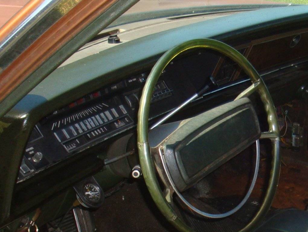

It's certainly preferable to get a car without ATC, but I wouldn't walk away from a nice car just because it had that option. I see that the hunt for a '69 T&C is back on and many of them left the factory with ATC. In '69 the Town & Country had a bit of an identity crisis. You got upscale items from the New Yorker, like the grill and woodgrain dash trim, which were then combined with taxi-cab door panels from the base level Newport. You can find some real bare bones T&C's out there, equipped with crank windows, woodgrain delete, and a 383 under the hood. Those will have standard A/C if they have A/C at all. If your tastes are a bit richer, and you are leaning towards a well-optioned car (like I would), there's a real good chance you'll find that temp selector knob when you look at the dash.
There it is on my '69 T&C. It's not a fully loaded car, but has most of the popular options.

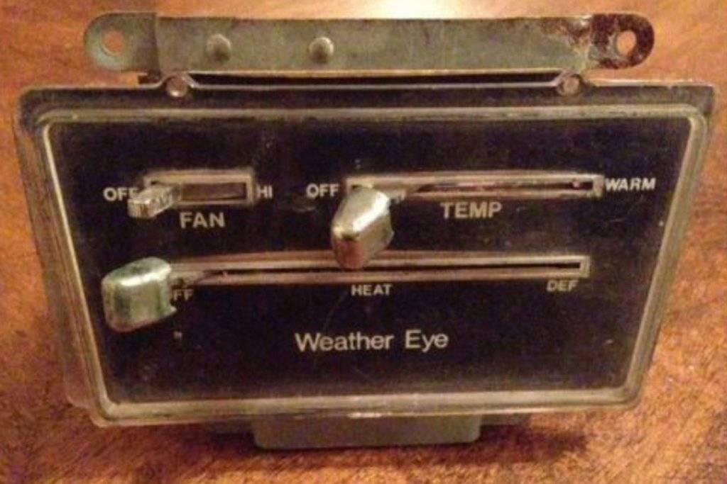

The last truly reliable and simple system I can remember
