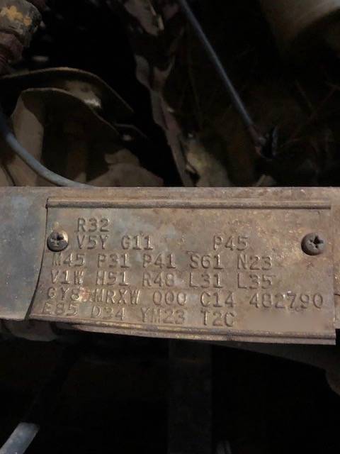

I own a 1972 Imperial coupe that I need to restore with the H51 regular A/C fender tag code on it - so at least this one has regular A/C - I have yet to see another Imperial without ATC II that is from 1972 or 1973. True story............
Wow, that’s really cool! You should post a pic of the tag on Doc’s tag thread. It’s good to know they made some without ATC. Supposedly, they also were made without a/c, like Matt’s silver sixty-seven (very alliterative!)
Here's the fender tag from my 1972 Imperial coupe with manual A/C. It was assembled in December of 1971, so it wasn't necessarily an early build - and I've never seen another 72 or 73 Imperial with factory manual A/C. Definitely says H51 for regular manual A/C.

Probably a Chrysler employee who knew what they were doing decided to save a preferred customer a lot of trouble by ordering the car without ATC II.

Here's the fender tag from my 1972 Imperial coupe with manual A/C (...) I've never seen another 72 or 73 Imperial with factory manual A/C. Definitely says H51 for regular manual A/C.
Thanks for posting the pic. That is rare!
Here is another. That car was for sale in the Chicago area this past spring.
