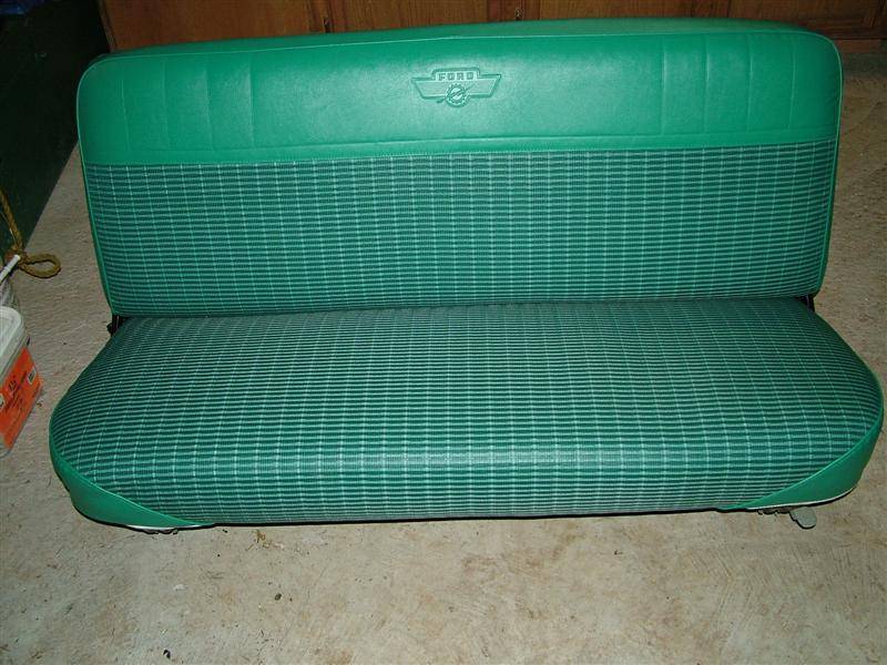

tbm3fan, is that bench seat pictured your seat? If so, I'm in the bay area also. Who reupholstered it and if you don't mind my asking what did they charge?
When that was done there were two guys recommended to me at the time. One had your typical shop in Walnut Creek and he quoted me $900 to do the seat with me supplying the material. Ouch!
The second guy works out of his house and he quoted me $600 to do the same job including foam padding. He does get lots of business. In talking he learned that I did a lot of work on restoring the Hornet. His Dad served on the USS Astoria during WWII. When I brought the Polara over to him he told me another customer, who volunteered on the Hornet, dropped a car off. He asked if he knew me and the guy said oh yeah he is the one really picky about restoring the ship correctly. He then did a great job fabricating the Polaras new headliner and vinyl roof. Hopefully he will be getting the big Merc to do a new vinyl top soon. The best part is his name: Forrest Steele in Concord
