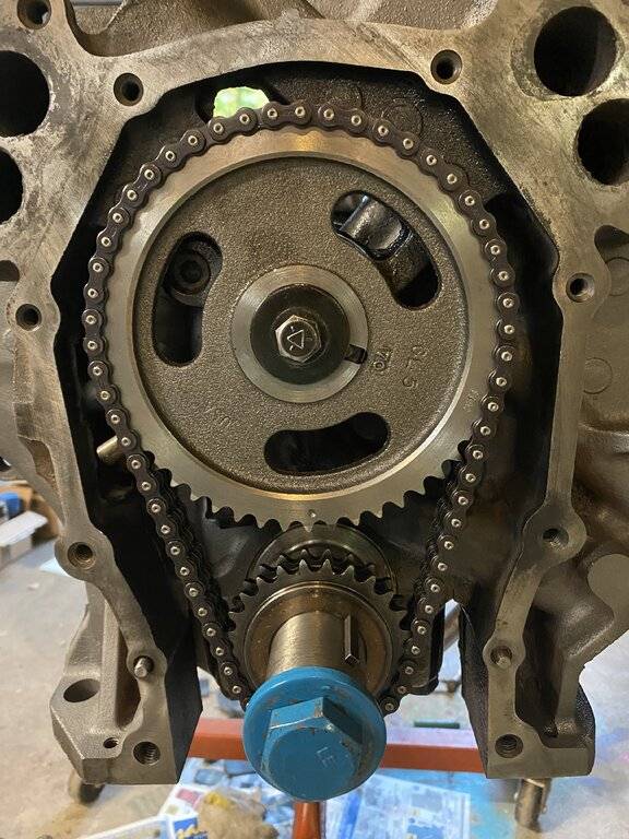

I have a T code 440 and used a Melling double roller, but I’m sure a single would have worked just as well. You should have a single bolt, unless someone changed the cam in the past.
There's the picture! Timing set "dot-to-dot", keyway pointing to #1 cyl piston pin centerline.
