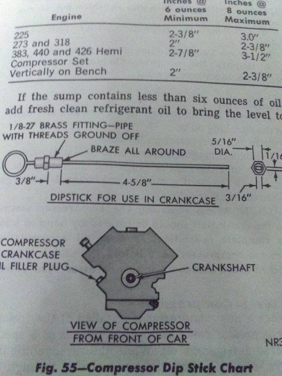

Ok here's the dipstick specs for the earlier setup that leans to the right
Great info, thank you!

just realized I added the dipstick diagram to this thread and it should have gone in your "compressor oil etc" one...oh well
