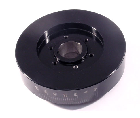

I have had good luck with this one.
For 440, internal balance I used Hughes Engines. Good results.
Harmonic Balancer/Damper PRP 24279, 7.25" internal balance$ 135.95$ 135.95
THANK YOU! I like what I see here. Hadn't got to 440Source last night in my search.
I like everything I read from Hughes and am sorely tempted to use them to build an engine for us. Seems like I've seen this PRP24279 in my search. Hmm, lemme look again. Thanx!

I used the bigblock chevy version of this one on my 489 stroker chevy in my squarebody, it works well too. I dont think you could go wrong with either this one or the 440 source one i use on my 505 mopar stroker. Here is my 489 with the jegs damper on it.
