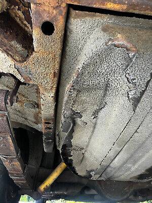

How does a fork lift damage a gas tank?
No one lifts a car from the rear. Were they pushing the car around with a fork lift?
Are we ever gonna get any pictures here? Would love to see the car and the piston hanging out of the motor.
@Lil_Hoss ?? Still around?
Apologies, this is currently the only picture I have of the tank damage from the ebay listing. Next time I am around the shop I can get some pictures of the piston but I just moved 30 minutes away from where the car is currently lodged
