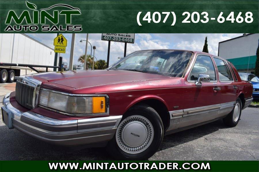

I had to open up the center hole of these '90 Town Car rims to fit around the rear axle flange. I could have done it with a die grinder, but since I needed center caps, they needed opened up even more (they are push through). It became a project for a machinist. Add in powder coat and it was pretty expensive. The lug circle was fine.

Interesting and clever choice of wheels. I always thought those were just wheel covers. Never knew they were an aluminum wheel with a hub cap in the center. Now that I know, it's obvious when you look at the wheel weight on the aluminum rim.

I have a set of those hub caps, but they were way too ugly to think about using. I guess back then, the aerodynamics engineers had more say then the stylists. It also happened with the 1982 Trans Am.
I remember the Trans Am wheels too. Certainly had a modern, almost sci-fi look to them, but the car looked much better without the caps. I think GM knew they might be going a bit too far with them, since they designed the wheels so that they could also be used without the caps.
I didn't like anything about the 1990 Town Car when it first came out, but warmed up to the styling over time. It also helped that Ford cleaned things up quite a bit in '91 when they changed the trim on the bumpers and sides. We eventually ended up buying a '94, which we still have.
