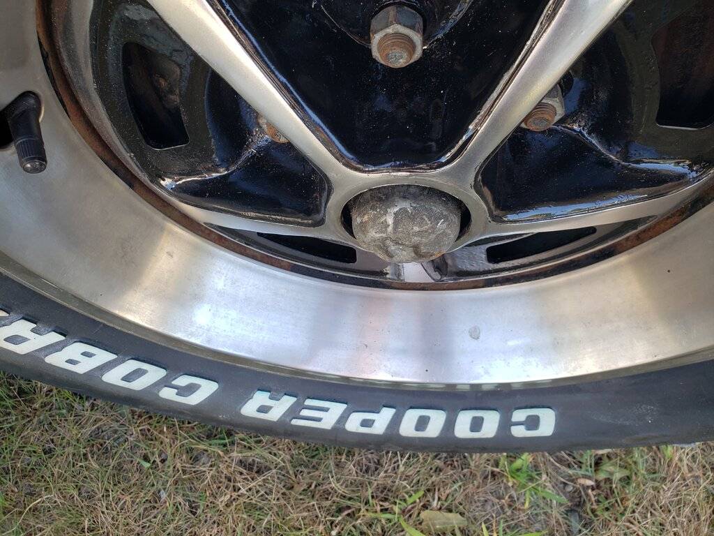

So I bought a set of wheels that I thought were mopar road wheels turn out to be fords. Bolt pattern is good and they sit nice and flush against the drums but they do not go all the way as deep so the bearing hub does not support the wheel. They go on it enough that all is lined up and not loose but definitely not all the way onto it. So my question is, are these safe to run?

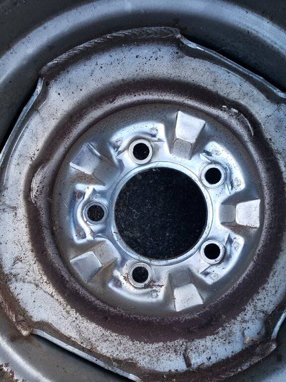

So to explain it a little better I took a couple pictures. The new wheels only contact the drum at the studs.the hub only mildy protrudes through the center bore of the rim as the inside of the rim isnt flat. The back of the stock rim is flat therefore the wheel goes all the way on and center on the hub and studs. The new wheels dont seem to be designed to go over a hub for alignment.

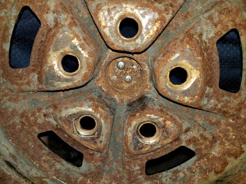

On a stock wheel the machined part of the hub and the center hole in the wheel fit tightly together. In that way, the weight of the vehicle is off the studs and on the center hole of the wheel, that puts less strain on the studs especially if the vehicle is heavily loaded. Looking at the photo of the back side of the wheel above, some of the stud holes in the wheel are hollowed out to the point of failure. When the holes become oversized, the tapered part of the lug nut contacts the drum before they contact the wheel and the result is a wheel that is not anchored tightly and the holes will wear until the lugs eat a big enough hole in the wheel to pull free.

I did think they looked a little bothered up so I got a set of new lugs with a larger cone to make better contact.
