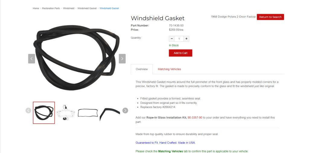

Steele Rubber makes the best gasket. Here's the part #
I had a spare windshield for my '68 Monaco 500 that I got with the car when in ought it. I never did find a new gasket for it during my three year ownership. I never got pulled over so I never cared, and it didn't distract my ability to drive the car. I realize there may be regulations in Europe that require a clear windshield. Best of luck to you in your search.
Thanks! I found a windscreen from multiple suppliers, one was 1303,25 dollars, one was 1100 dollars and one was 515 dollars. Guess which one i ordered..
I'll order the gasket too, but isn't it better to glue it in like all the newer cars?
No.. The gasket fits the trim properly to windshield as well. The rear glass glues in with Buytl tape, but front requires gasket
The Fast Top rear window was Chrysler's first "glue-in" glass, everything else is gasketed.
What you will see when you get the orig glass out is the build thickness that would be needed for the urethane match. Modern glue-in glasses do not have that much thickness to deal with.
NOW, if you want some large gaps between the glass and trim AND are willing to deal with the related wind noise . . . plus the glass looking "too sunk in". OR you can devise some spacers (man of them) to reinforce and stabilize the glass with the thicker urethane, THEN you could do the glue-in operation. Might take a case or more of urethane, though.
Much better to use the gasket seal.
