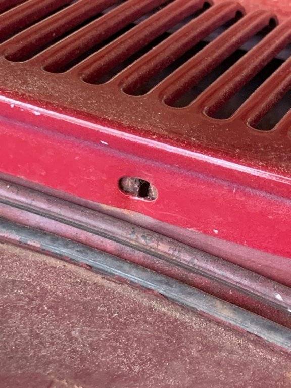

I may have asked this before, but am still puzzled. I have tried a couple small clip types but no cigar. Also have looked at some of the suppliers such as Mr G but have not gotten a handle on this fastener that has a very small hole behind for anything. I currently am using a sheet metal screw to keep the cowl in place. My car came with no fasteners here. Any help appreciated.
Screws are what hold the cowl down along the top of the firewall. It looks like that hole that you are showing has been enlarged. You may have to use a sheet metal screw on that hole.
Just good old fashioned sheet metal screws. Phillips head, rounded top. They would possibly have been painted body colour, as that part was assembled on the car prior to painting.

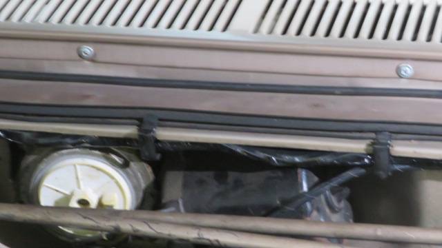

You can see them on this pic of my car's cowl panel...

I used sheet metal screws, from what I saw that was all it had in there to begin with, I think they were painted to match the color of the car
Good Morning
On a '65 Chrysler the cowl is attached by screws. Mine is an original paint car and the screws were not painted body color.

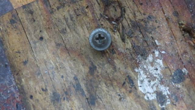

Mine were rustyIMG_1757.JPG so I re-shot then with some argent wheel paint.IMG_1758.JPGIMG_1760.JPG
I had used the term ledger screws above, also called washer head for some and also truss head sheet metal screws, that have a washer head unlike a pan head. Seems no. 8 very short will work???
Yeah, thats the same ones I used on mine. I picked them up at the local Lowes hardware store.
