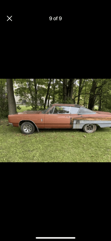

I recently bought a 67 Fury III convertible. It’s a project, it needs things. Like a windshield.
I found a parts car with a good windshield and a few other parts I needed. A quick search told me a 67 Fury, 2 door hard top, windshield would fit my convertible.
So I drive 3 hours to pick it up, and trailer it 3 hours home. Then carefully and nervously cut out the windshield, managing to get it out without cracking it. I even bought the special tool for removing the chrome. I was so proud of myself.
Until today I found out that a 2 door hard top, is different from a 2 door fast top. And that is what I dragged home. But you would think they would have the same windshield. It looks like only the back glass is different. Not according to the internet.
Do what is the difference? Anyone know? I’m not saying the internet is wrong, but I’m hoping it is a small difference like it has tint on the top and the others don’t. Or maybe slightly thicker glass? I know I’m grasping at straws, but I’m hoping someone will say I can use it. It sure looks the same.

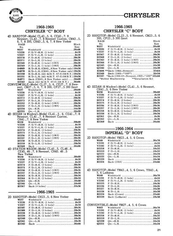

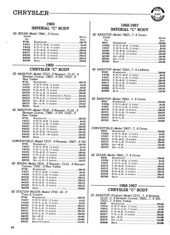

ok from my 68 Chrysler "special collision parts issue"...2664426(NAGS W658)...2 and 4 door sedan and wagon....2664428(NAGS W657)...2dr hardtop, 4 door hardtop, and convertible...2664210(NAGS W692)...2dr fastop and vip...tinted versions had different part numbers from clear but still fit the same stuff so the difference isnt just tint...fwiw the fastop vent windows are different too...makes me think the fastop had a little extra aero trickery for Nascar superspeedways but the teams wound up using the B bodies instead...

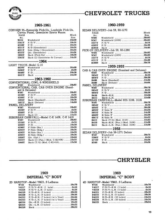

Does anybody have a list of the NAGS #'s for all the different applications for slab, fusey and formal?
It avoids getting jerked around by counter people that think the only glass on the planet is for Honda Civics. If you just give them the NAGS # and don't tell them what it's for, it bypasses the 50 shades of how may I not be of assistance to you today that seems to be the default position for business in general these days if any thinking is required.

I have most...
