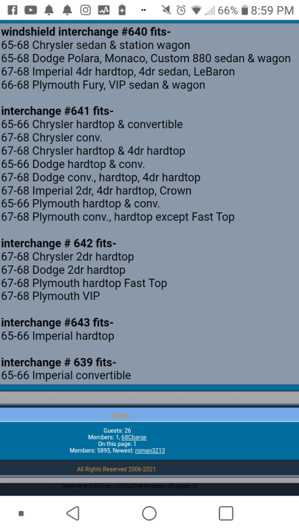

For 67 Chrysler and Dodge full-size 2-door HT Hollander gives #3201, so the windshields are the same.

Here is a reference.
