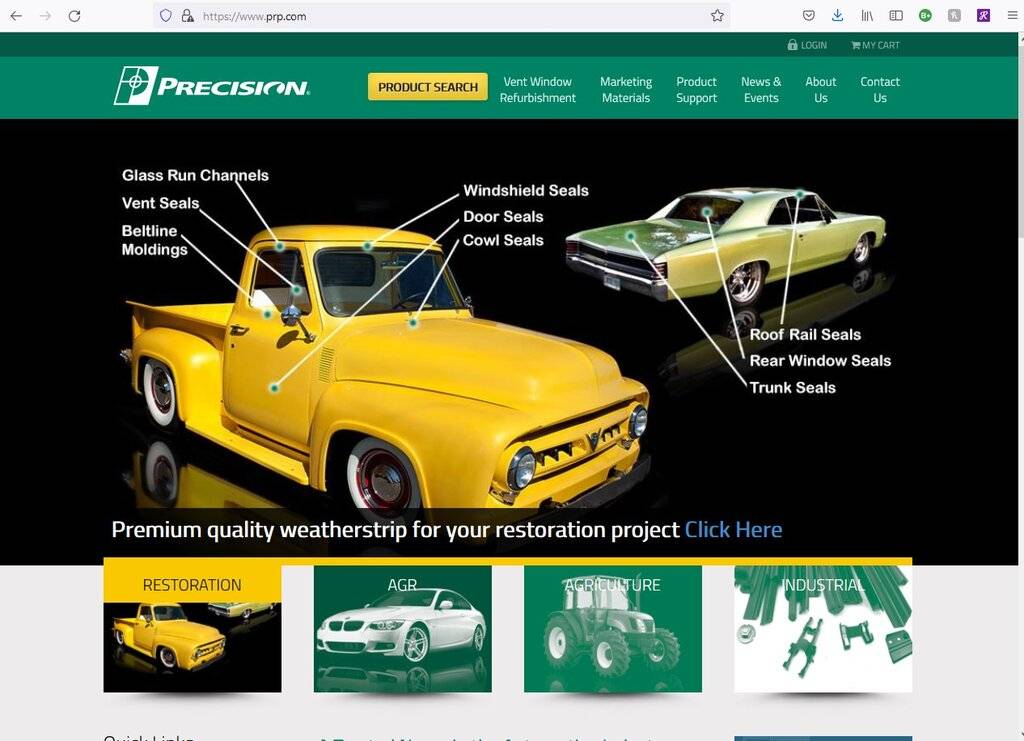

The Steele gasket is made in the USA, where the $90 ones are likely Precision gaskets that at least used to be made in Taiwan, but could possibly be from China these days.
It's likely that they will both fit fine. You just want to make sure that you don't pay $200 for a Precision gasket when you can get one for half that.

The Precision seal states without trim groove as do at least one of the of the $90 seals. But Precision is out of stock, Precisions price is $131.00 How important is the trim groove?
I used Precision gaskets in my 65 Barracuda with no issues at all.
It wouldn't surprise me at all if the Steele and Precision pieces were the same part, built by the same vendor etc. I could be wrong too...

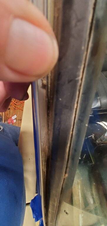

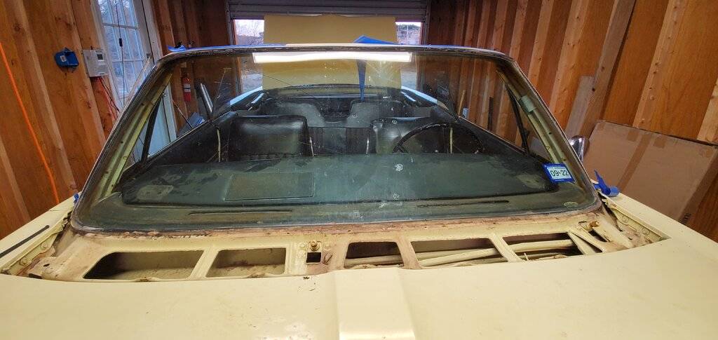

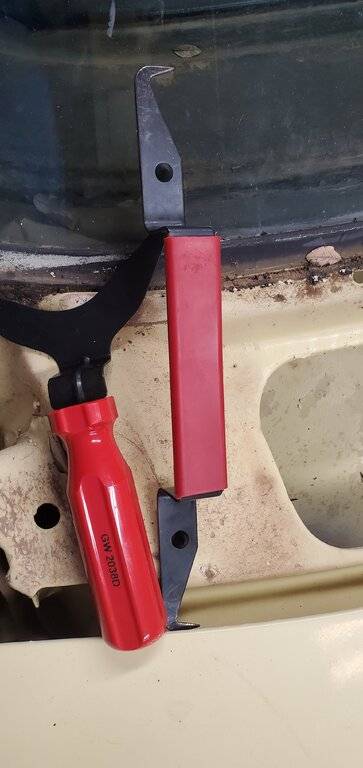

I am having issues getting the trim off. I have watched them until I am blue in the face. I have all of the convertible specific chrome around the windshield area off per the service manual and the cowl is off. I got two clips off on the passenger side side trim. I am wondering if I am coming from the wrong side.? I am coming at it from the glass side.
Here are some pictures of where I am at and the tools I am using . I also have a small fork tip and on fork tip pry bars. I used those on the bottom trim as it used different clips.
Getting that trim off can be very difficult. It takes a lot of practice to get the right technique down to pop those clips loose. One big problem is that the more you mess with a particular clip, the more it will dig into the trim and grip even tighter.
You are doing it correctly by coming in from the glass side of the trim.

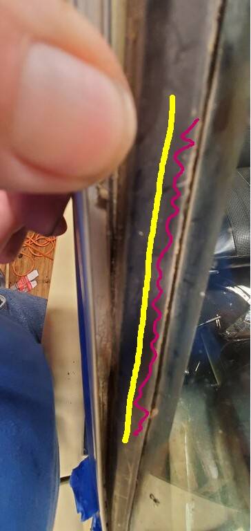

As I mentioned before, you can do things in reverse order by cutting the gasket. You cut on the yellow line along the trim and remove the section colored in purple. You can push the glass out, pull out the rest of the gasket, then pop all the trim off.

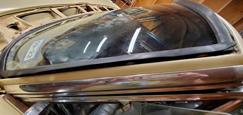

I have another question now that my windshield has been replaced. The glass shop could not get the trim pieces back on, due to an extra flap of rubber on the new molding that the original doesn't have. The Windshield looks great but that extra flap is creating an issue. The glass shop finished taking off the trim. He cut the window out then removed the trim. Any ideas on how to get the trim to mount? I have thought about cutting the flap off but that kind of scares me. The molding is a precision piece.
I don't know what to tell you about the extra flap on the gasket.
It seems like it would be impossible, but is there any chance that they installed the gasket inside-out? There should be a flap on the inside that hides the bolts that mount the dash.
Otherwise, you may have to carefully trim the gasket to get the mouldings to fit.
I have lots of experience taking these cars apart, but not nearly as much putting things back together, so this is something that I've never run across before.
Jeff
No doubt in my mind, the gasket is not installed correctly.
It should lay flat all the way around. Squinting at the pics, it looks like it hasn't been installed over the pinch weld correctly, instead sitting on top of it.
