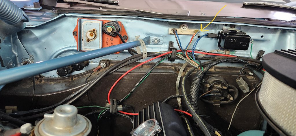

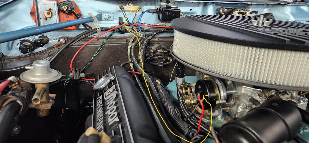

I have an Edelbrock carb that has the choke disconnected. Looks like the prev owner never bothered to hook it up, no wires or anything
Assuming I can confirm it works, or I get a new carb., what's the best place to hook it up so that it's only active with the engine running?

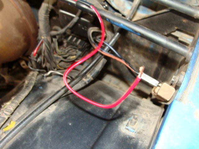

I have used the power side of the ballast resistor. You can run a wire over to the starter relay as well.
where can I find the ballast resistor? Is it wrapped up in tape?
I'd think the starter relay is live all the time no?

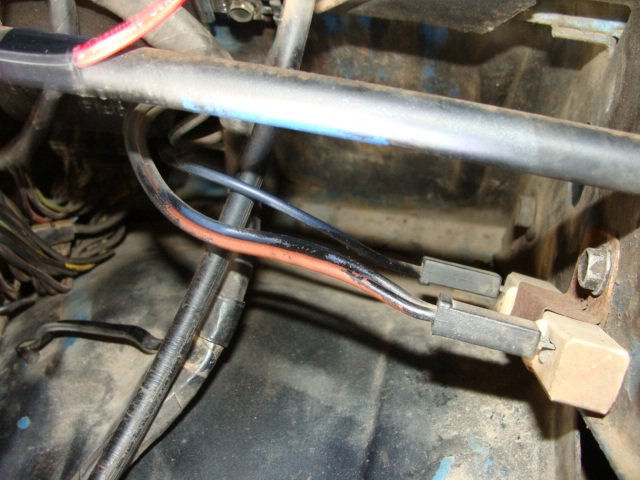

Provided that your car is more or less in stock condition, the ballast resistor is a white, boxy looking part made from ceramic material and mounted to the passenger side of the firewall, about 1" x 3" in size.
There should be one dark blue wire connected to one side of the ballast resistor (coming from the voltage regulator) and a brown as well as another dark blue wire connected to the other side of the ballast resistor. Add a connection for the choke heater to the side of the ballast resistor where there is only one (dark blue) wire connected to the ballast resistor.

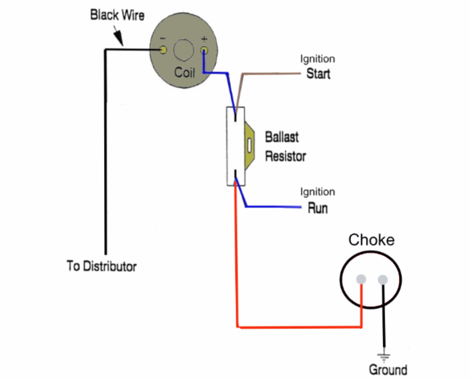

Easy place to hook to is at the coil. The wire should be dark blue on the positive terminal and it runs directly to the ballast resistor.
Basically the same as the hook up to the ballast resistor only without having to add another connection there. Just a simple terminal on the end of the choke wire.
EDIT: Don't do it this way. Brain fart on my end.
I Concur
If you're on the downstream side of the ballast resistor the voltage will only be around 8-9 volts. You have to use the upstream side of the ballast resistor.
You are correct and thinking about it, the voltage would drop even more to the coil as the load would be increased. (Ohm's Law)
So... Don't connect it at the coil. Brain fart on my part.

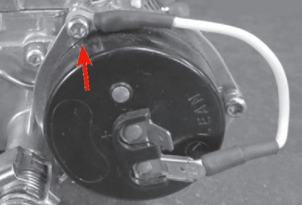

To connect the Edelbrock electric choke to power, do the following:
Wire the electric choke negative terminal to the carburetor body, or other ground, as shown in the following image:

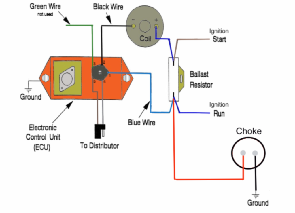

Wiring Choke Directly to Ignition RUN
Wire the positive terminal into the Ignition RUN circuit of the vehicle as shown in one of the following diagrams which match your Chrysler ignition system:
Point Ignition System:

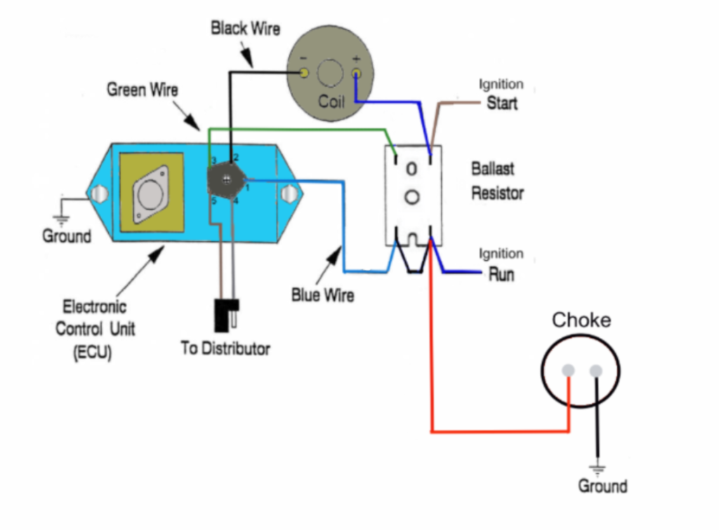

Electronic Ignition with 5-pin ECU and 4-terminal ballast resistor:
Electronic Ignition with 4-pin ECU and 2-terminal ballast resistor:

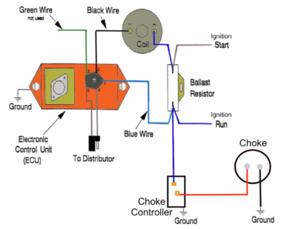

Wiring Choke to a Choke Controller:
1973 - 1984 Chrysler vehicles used an electric assist heated choke which was connected to a choke controller. The controller varied the opening rate of the choke depending on temperature. The controller shuts off power when operating temperature is reached so power is not applied all the time.

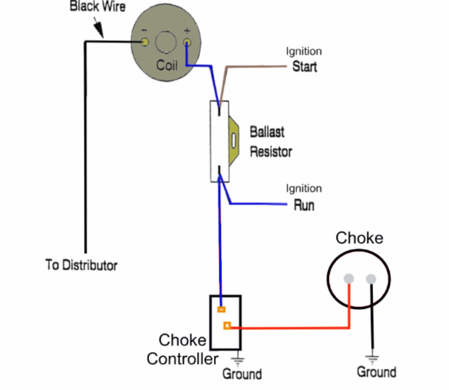

If using the Chrysler 1973 - 1984 electric choke controller, or similar unit, wire the positive terminal as shown in one of the following diagrams which match your Chrysler ignition system:
Point Ignition System, with electric choke controller:

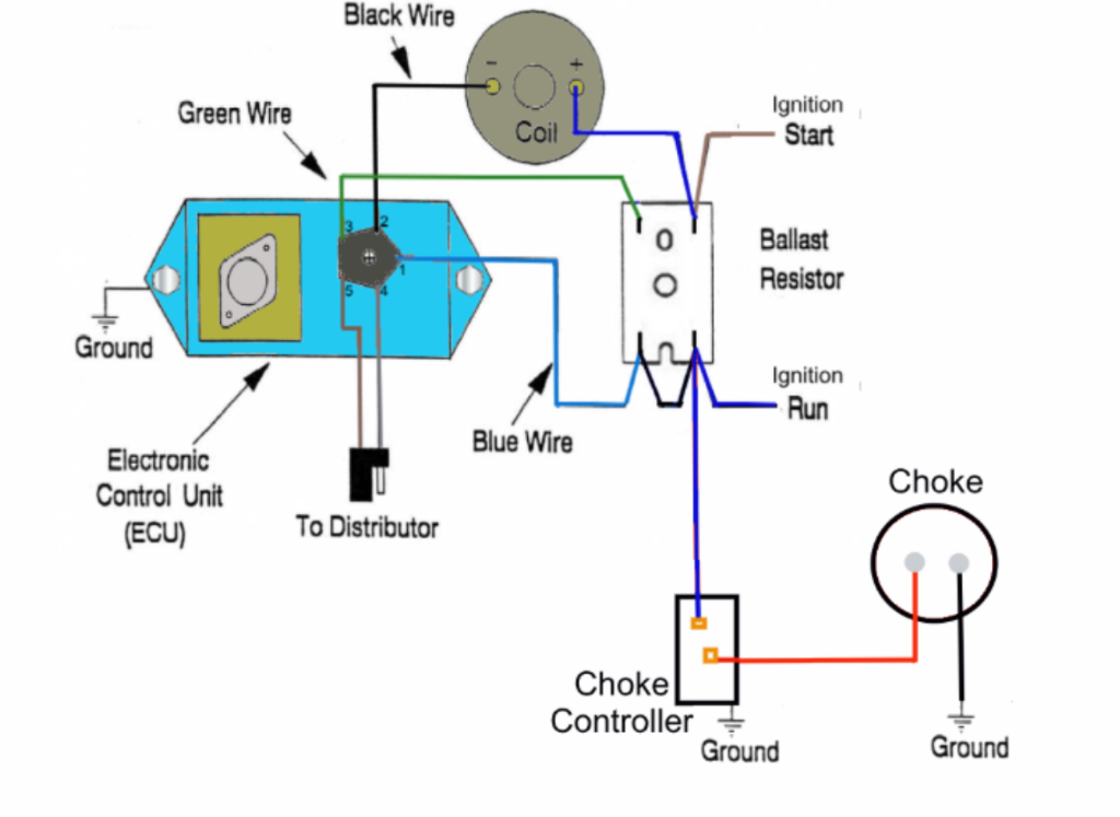

Electronic Ignition with 5-pin ECU and 4-terminal ballast resistor, with electric choke controller:
Electronic Ignition with 4-pin ECU and 2-terminal ballast resistor, with electric choke controller:

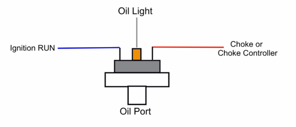

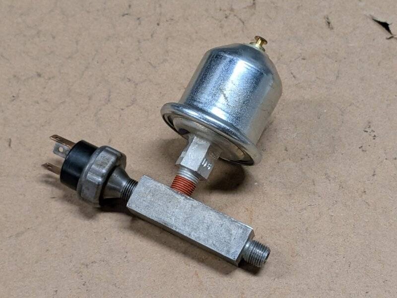

Optional Choke Power Shutoff With Engine Not Running

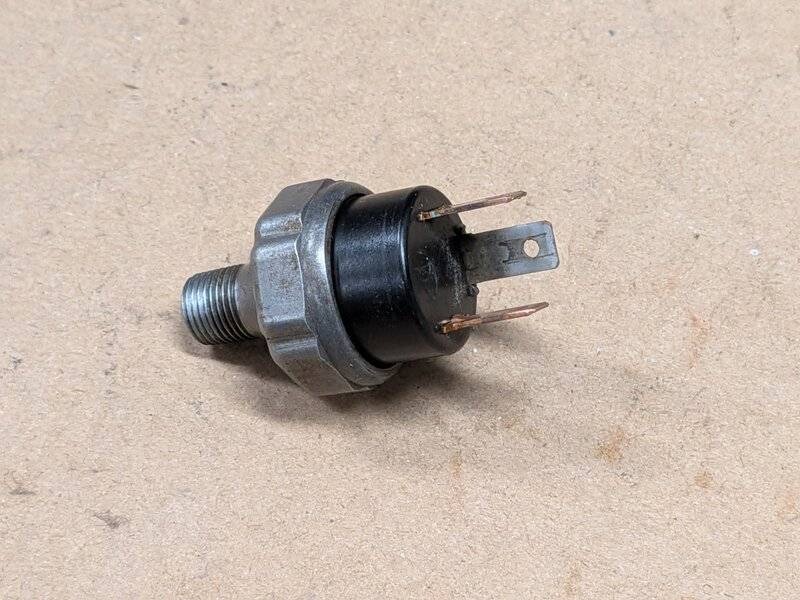

To prevent power from being applied to the choke when the engine is off, but the key switch for Ignition RUN is on, an oil pressure switch can be added in place of the stock oil light switch, or in addition to the oil pressure sensor. Chrysler added an oil pressure switch like this in 1979 which cuts power when there is no oil pressure.
The 1979 - 1989 switch (Chrysler number 3231347, 3747431, 4186352) is a three terminal switch with one terminal connected to the dash oil light and the other two terminals in the circuit wiring to the choke control.
The following image shows the three terminal pressure switch:
Connect the switch inline between the Ignition RUN circuit and the electric choke,or choke controller as shown in the following image:
If adding to an engine with an oil pressure gauge and sensor, use a tee as shown in the following image:
Oil Light and Choke Combination Switch Part Numbers​

The physical location of the ballast resistor VARIES with model year (and which platform the car is built on). @GOLDMYN indicates the "Slabs" and the rh cowl location is typical for "Fuselage" Chrysler products.
Thanks for those schematics, @Vaanth.

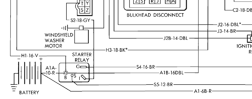

The relay is hot all the time so you can't use that.
Ign 1 and Acc terminals should have power with the key on. Correct?
ACC---hot in "run" position or "accessory" position.
IGN1--the "run" terminal, hot ONLY in "run" position, DEAD in start!! THIS is what feeds alternator field (on 70/ later), The VR, the ignition system, electric chokce if used. It is the ONLY switched 12V in the engine bay
START: This is hot only in the start position, and feeds to the starter relay to activate it and then the relay activates the starter solenoid. It is also part of the neutral start circuit. The second small terminal of the start relay needs to be grounded, and that goes down to the center terminal on the neutral/ reverse light switch on the automatic. On stick cars 70/ later, it goes to the clutch safety switch
There are 4 terminals on a starter relay.
B is direct to battery and hot all the time.
G is the NSS
S goes to the solenoid on the starter and is only hot when the relay is engaged
I goes to the ignition and is only hot when key is twisted to "start".
I don't see where it's getting any switched power.
G is the NSS
I bet the guy I quoted was talking about the ignition switch. That would make sense.
