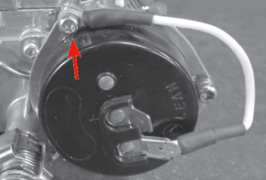

To connect the Edelbrock electric choke to power, do the following:
Wire the electric choke negative terminal to the carburetor body, or other ground, as shown in the following image:

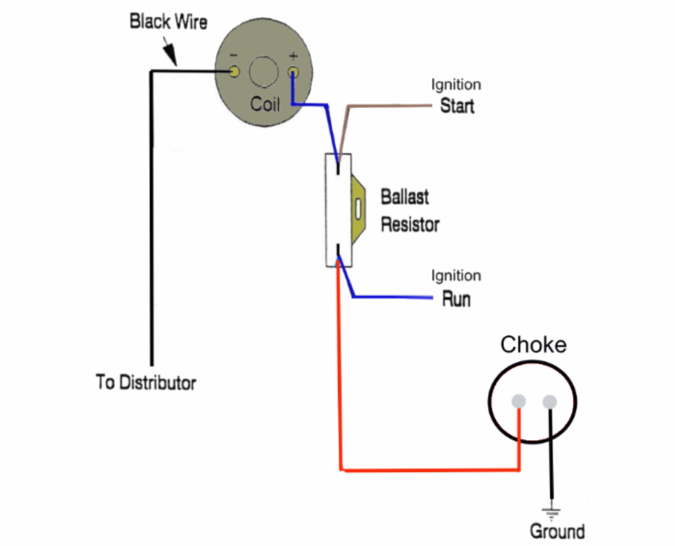

Wiring Choke Directly to Ignition RUN

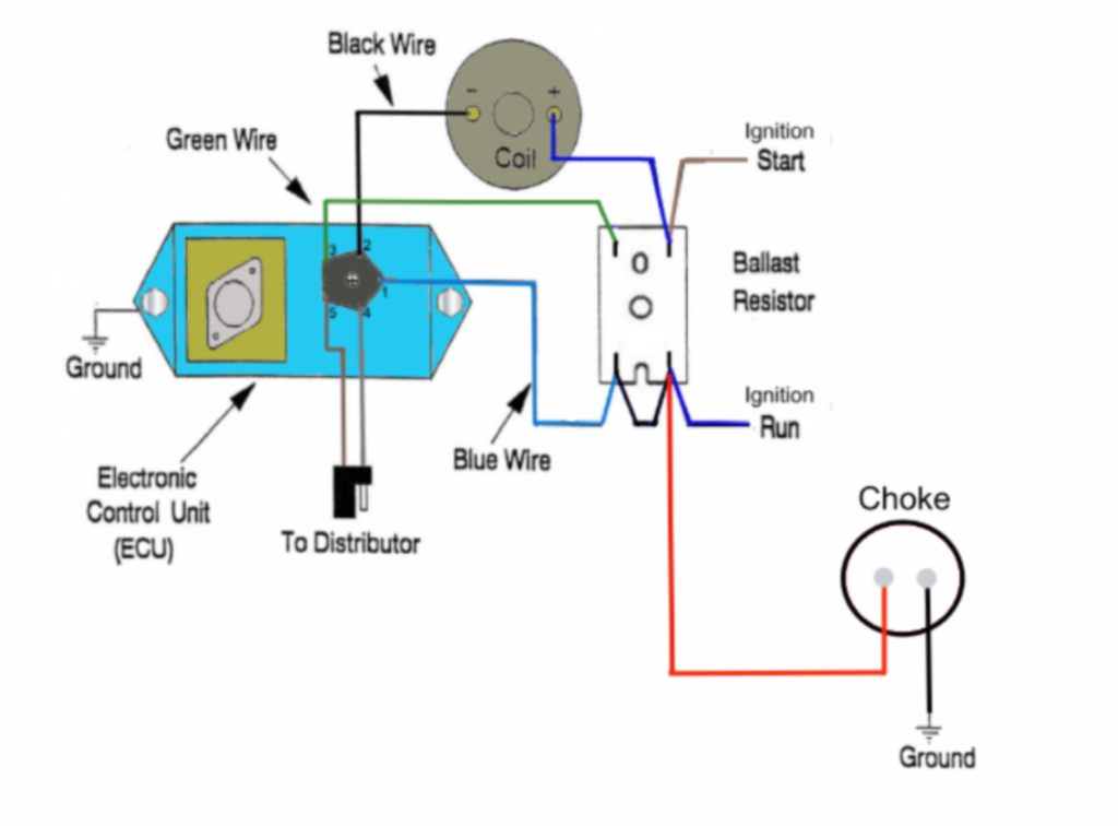

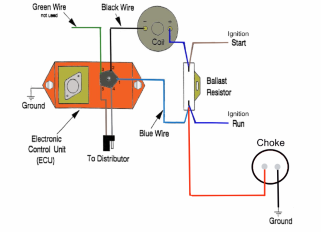

Wire the positive terminal into the Ignition RUN circuit of the vehicle as shown in one of the following diagrams which match your Chrysler ignition system:
Point Ignition System:
Electronic Ignition with 5-pin ECU and 4-terminal ballast resistor:
Electronic Ignition with 4-pin ECU and 2-terminal ballast resistor:

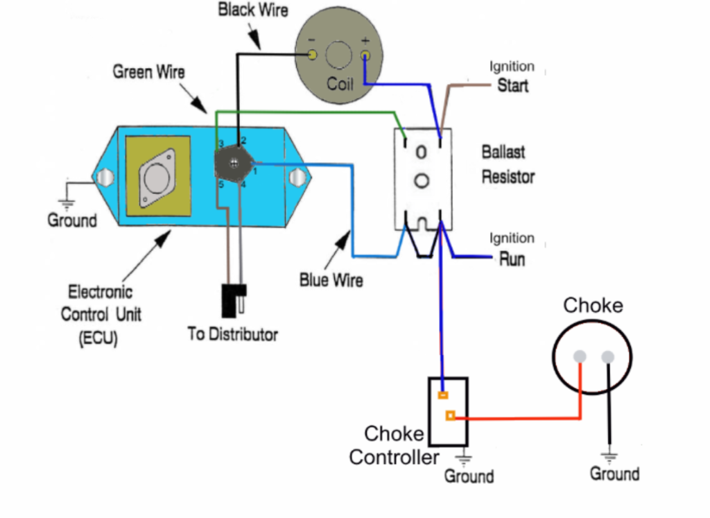

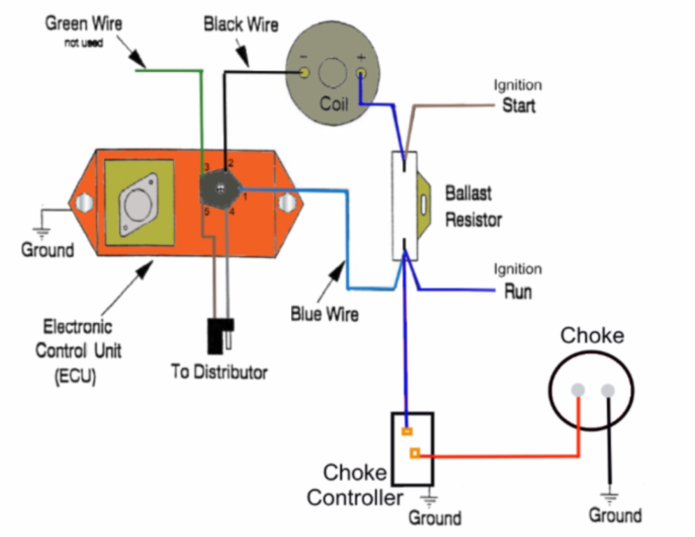

Wiring Choke to a Choke Controller:
1973 - 1984 Chrysler vehicles used an electric assist heated choke which was connected to a choke controller. The controller varied the opening rate of the choke depending on temperature. The controller shuts off power when operating temperature is reached so power is not applied all the time.

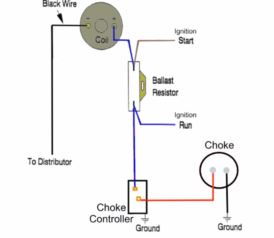

If using the Chrysler 1973 - 1984 electric choke controller, or similar unit, wire the positive terminal as shown in one of the following diagrams which match your Chrysler ignition system:
Point Ignition System, with electric choke controller:
Electronic Ignition with 5-pin ECU and 4-terminal ballast resistor, with electric choke controller:
Electronic Ignition with 4-pin ECU and 2-terminal ballast resistor, with electric choke controller:

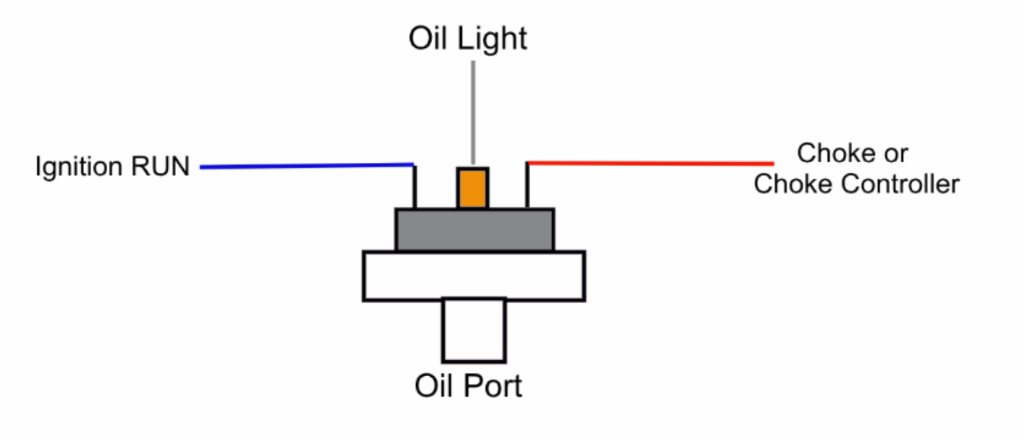

Optional Choke Power Shutoff With Engine Not Running
To prevent power from being applied to the choke when the engine is off, but the key switch for Ignition RUN is on, an oil pressure switch can be added in place of the stock oil light switch, or in addition to the oil pressure sensor. Chrysler added an oil pressure switch like this in 1979 which cuts power when there is no oil pressure.

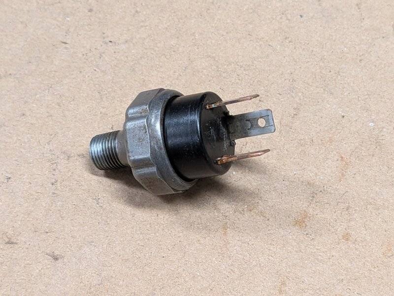

The 1979 - 1989 switch (Chrysler number 3231347, 3747431, 4186352) is a three terminal switch with one terminal connected to the dash oil light and the other two terminals in the circuit wiring to the choke control.
The following image shows the three terminal pressure switch:
Connect the switch inline between the Ignition RUN circuit and the electric choke,or choke controller as shown in the following image:

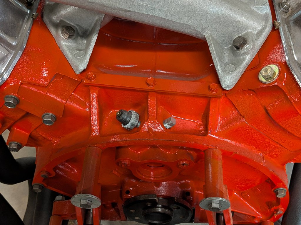

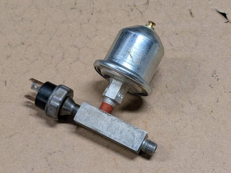

If adding to an engine with an oil pressure gauge and sensor, use a tee as shown in the following image:
