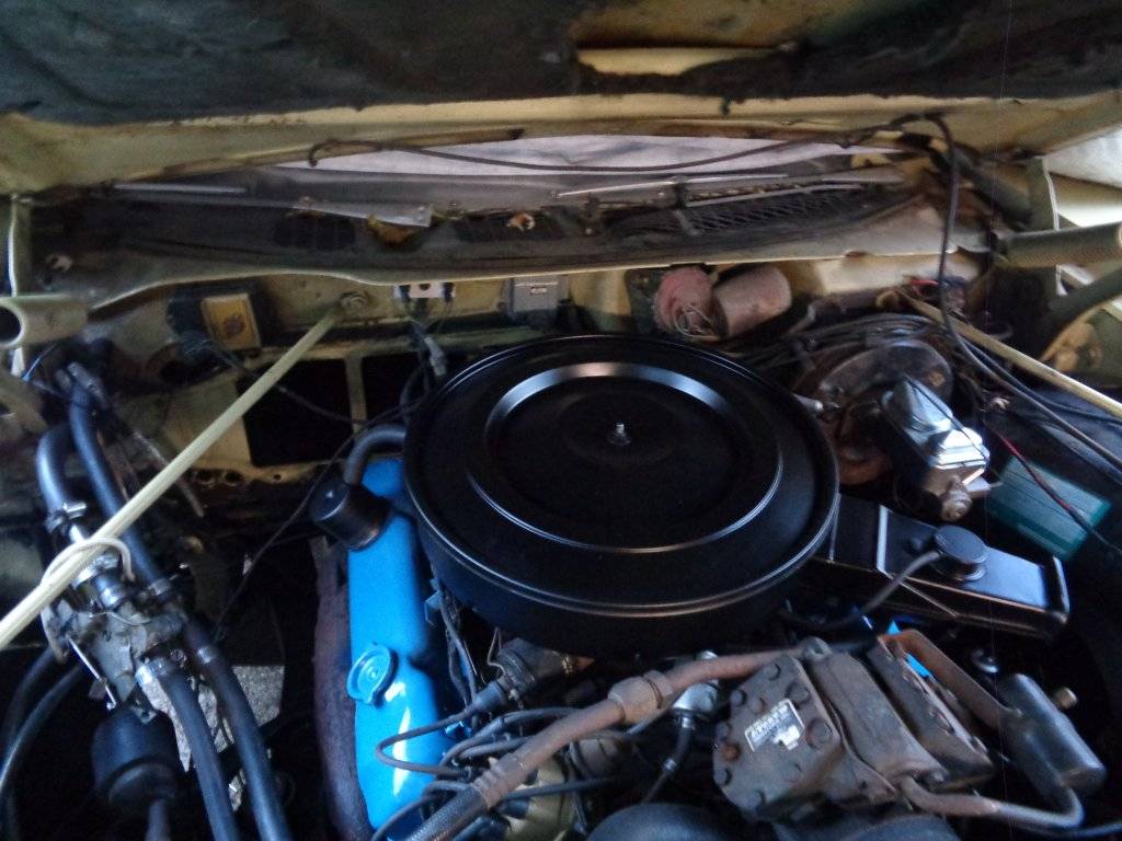

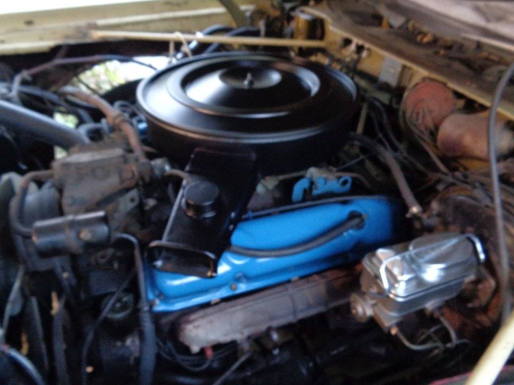

Apparently I should be using a 3.5" air filter instead of a 2¾" air filter that I have been using for the past 6 years @_@
