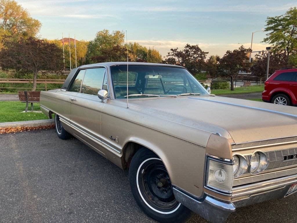

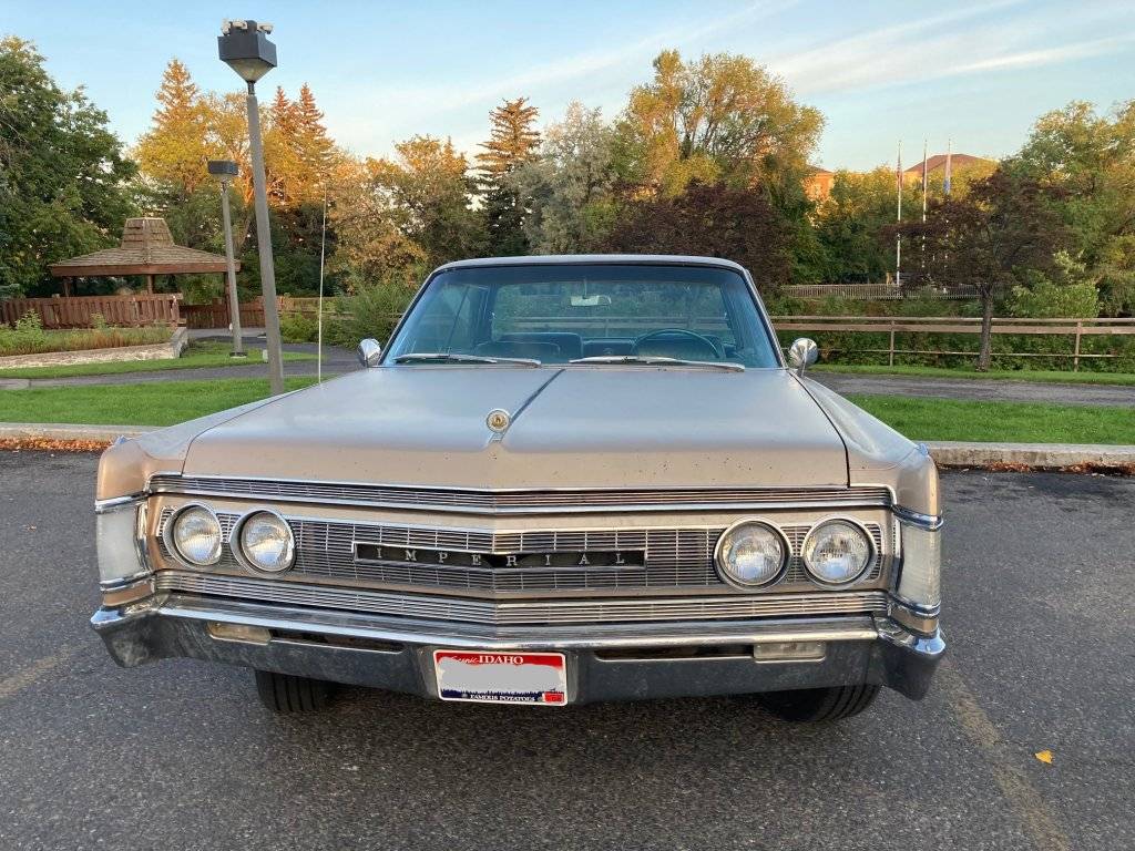

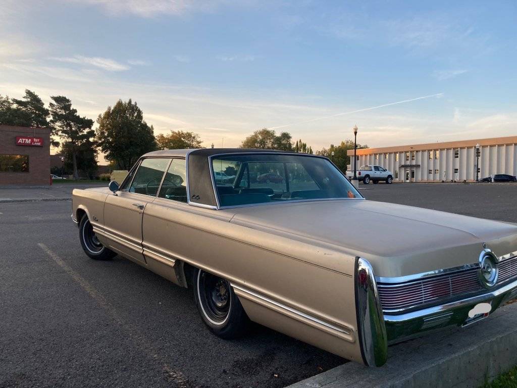

I've attached a few photos, and would appreciate your honest assessment. Looks to me like it rides a little low in the rear. Also some advice on how to deal with the rock chips in the paint. I haven't washed it yet, or cleaned the engine bay, so what you're seeing is what I bought. I do have all 4 hubcaps, just haven't reinstalled them after the brake job.

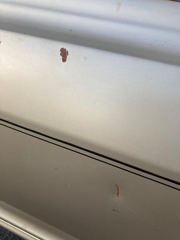

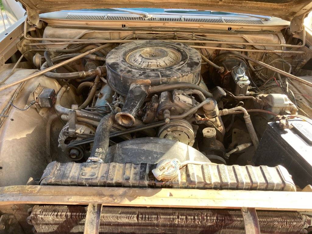

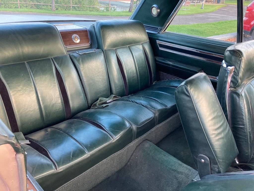

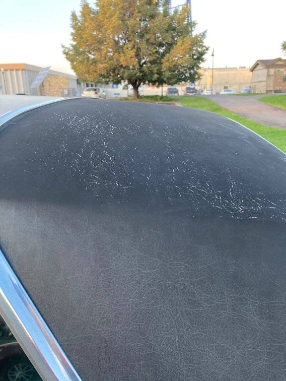

Here are a few more photographs of a paint chip (one of about 30?), the engine bay, and the interior.

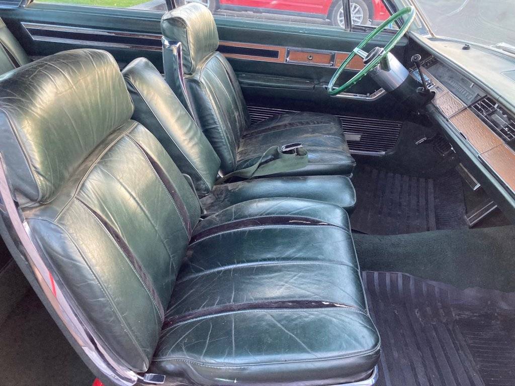

The seats need some cleaning and upholstery work.
The front air seems to work, although I suspect the dryer is partially plugged. The rear air doesn't seem to work.
None of the lights tied to the door switch work.
The dash lights do work.
The turn signals, brake lights, headlights, and running lights all work, the turn signal auto cancel does not work.
All the windows are stuck (except the front vent windows).
The power seats work (at least up and back)
Lighters don't work.
Haven't tried the autopilot, but the green on indicator comes on.
Trunk lid seems to have been tweaked a little.
Driver door needs a little adjustment.
The undercarriage is covered with a layer of brown Idaho dirt, which makes it hard to do a good inspection for rust, but no rust through on body panels or trunk floor.

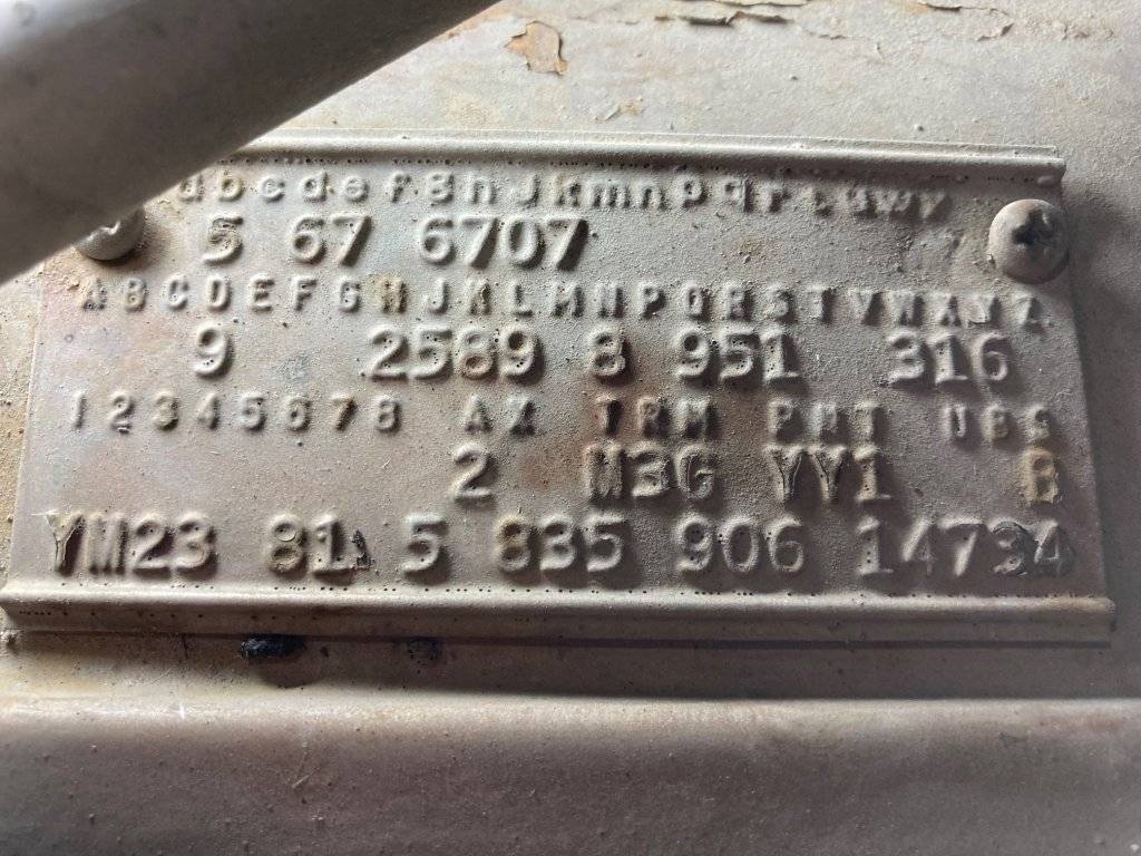

Almost forgot...here is the fender tag. I would appreciate it if one of you fine folks would help me decode this.

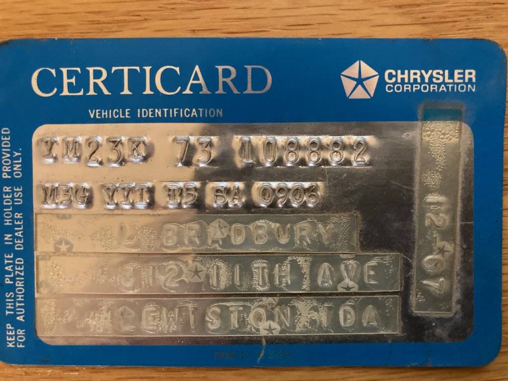

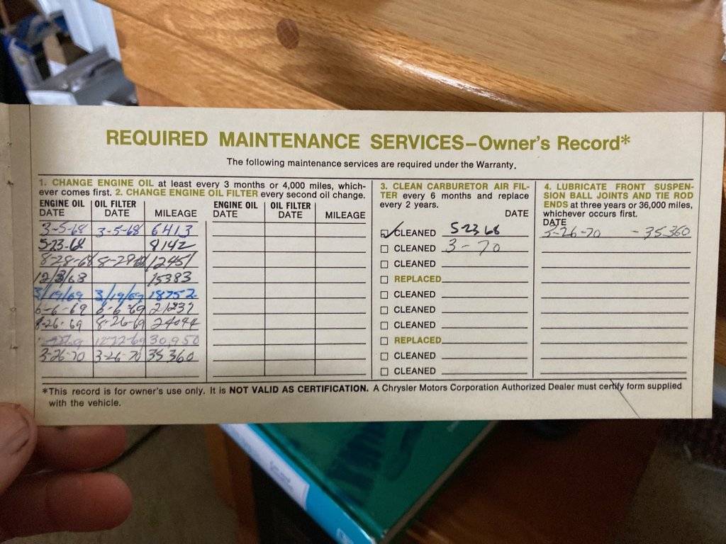

I am indeed full of crap. I was going from my (apparently feeble) memory of the long talk I had with the grandson. I quick trip to the glovebox shows that the car was purchased in Lewiston.

Keep and drive. Would like to keep it as original as possible. Any advice on the rock chips in the paint.

Nice score! Looks like a nice, "high and dry" example, lucky you!. Haven't seen gold (at least, I THINK it's gold from the photos) w/green interior (just look at that green translucent wheel) in many years, an attractive, truly 1960's color combination.
Give that green leather a good soaking with Leatherique, or Lexol, which is easier to get. Then, give all that walnut on the dash/doors, a good oiling with lemon oil, or something similar. the same stuff you use on walnut furniture is good for that. THEN you can truly see/appreciate what is an Imperial's better (if not the best, IMHO) feature, their interiors....
I'd say in general, get it into reliable driving condition, and let the rest follow as you go. This website will be a big help to you: www.imperialclub.com, especially with power options, etc.
Power window mechanisms often just need dis-assembly/cleaning-lube/re-assembly..... send your switches to devinism on this group, he's the "respected expert" on re-building them.
The rear end looks to be a LITTLE low, but that's common with these over time, replacing the rear leaf springs on mine brought it back up, and helped with handling.

car had 440 350 horse
automatic Trans
2.94 open rear axle
9-6-1966 scheduled production date.
sold in December of 1967
so it could have been on the lot that long or the certicard and owners manual is not showing the original owner.

Mr Frey of Frey Chrysler Plymouth (in the town where I grew up)
used to get his wife a new Imperial every year (as a demonstrator),
usually a convertible, then would sell it as a new car the next model year. That could explain the late date on the Certicard.

Some of the walnut grain on the doors is raised, like it's been wet. It looks pretty thin, but I'll attempt a light sanding. Is ordinary Old English lemon oil OK? I used to own a cedar house, and that's what we used to spruce up the interior walls.
