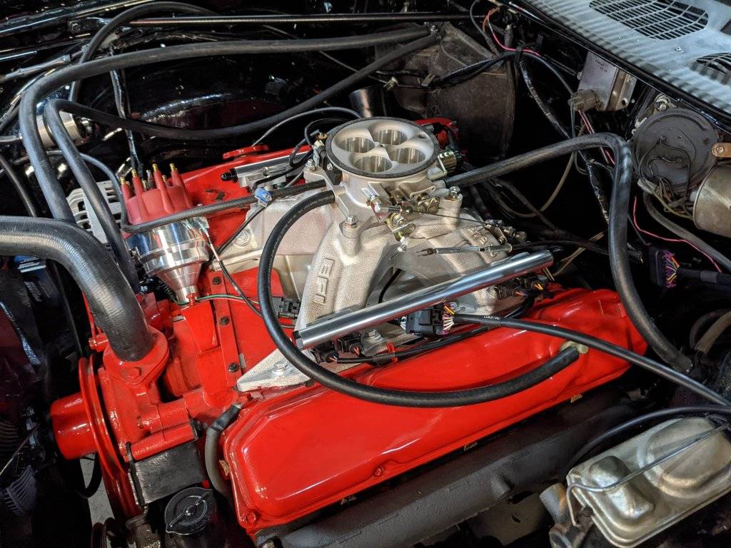

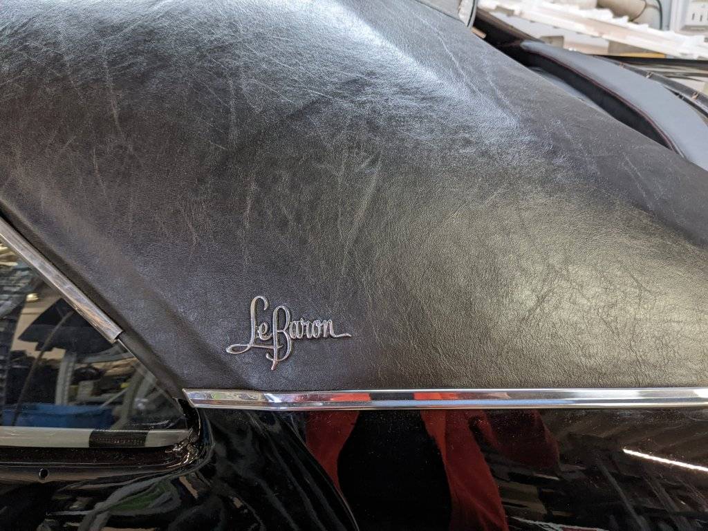

Hey all, Imperial 1970 LeBaron is now inspected, registered and ready to eat miles in Finland. Still some challenges with EFI system, but hopefully they are solved during next week. Happy and sunny summer for all of you.

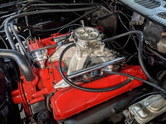

Stunning, I’m happy for you this she’s back on the road after all of your hard work. I am curious though. I think I see an Edelbrock Profli 4 system with an external fuel pump/sump. I’m strongly considering there for my 77 NYB. Would like to know your experience with that system.
Mr. Jari P. Ängeslevä
Hey, it is a good choice. This package came together with a tablet and Edelbrock app, where you can basically adjust and monitor via Bluetooth the whole system. Set up is easy, just manually adjust your timing and then let the software do the rest. It has a self-learning mode, with 3 different levels (slow-medium-fast) and it is recommended to to use first the fast and after mixed driving the medium and then slow. Preinstalled fuel maps works good, but you can also trim them yourselves if needed. Fuel economy is better than with carburator (15-20%) less fuel.

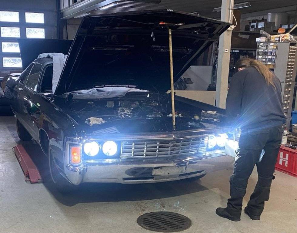

New LED headlight adjustment

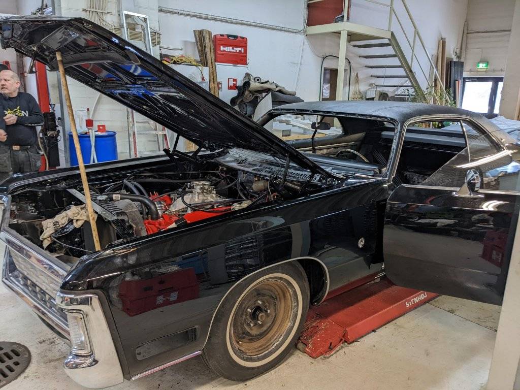

Team is preparing to install the interior and most of al the engine is almost wired for action.

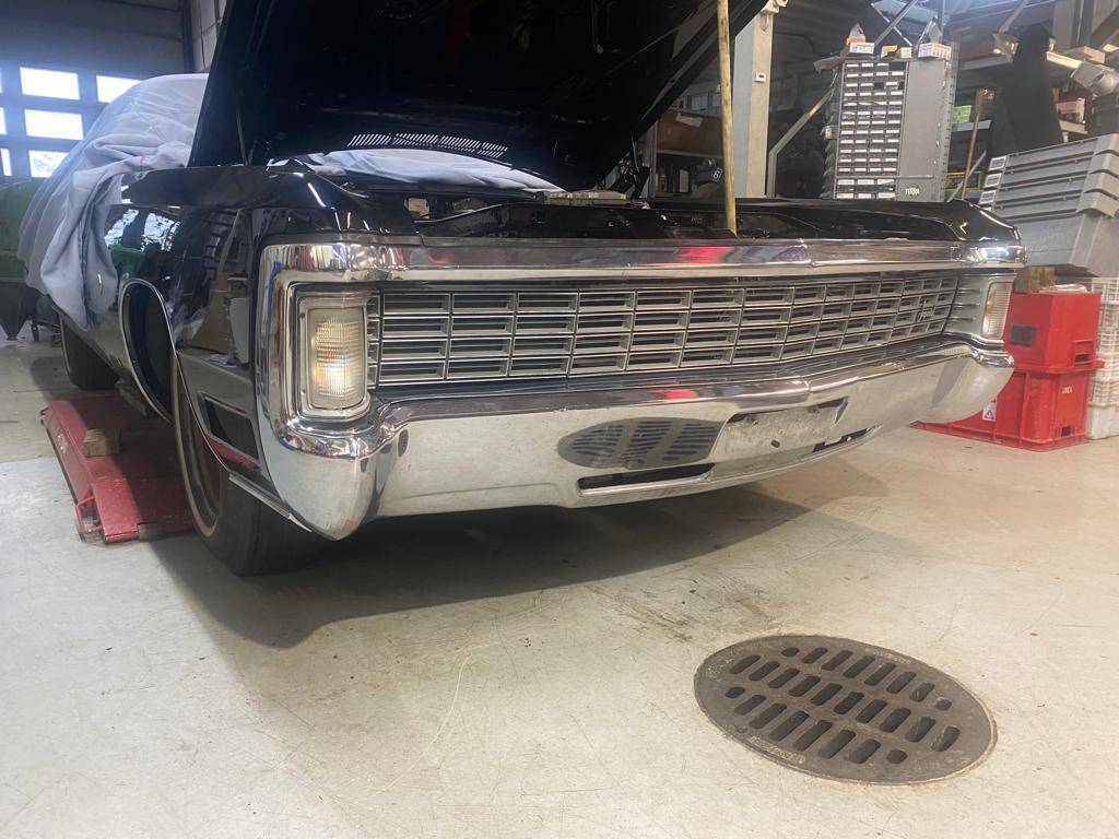

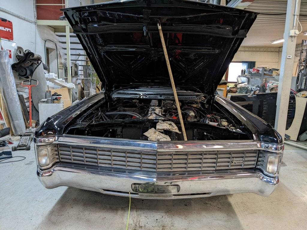

Front is done. This is starting to look like a car:)

It's coming along nicely!
:thumbsup:
Yeah, just hope that all goes well and it will hit the road this summer

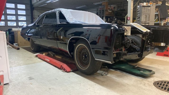

Project is moving forward. Now the fenders has been installed.
